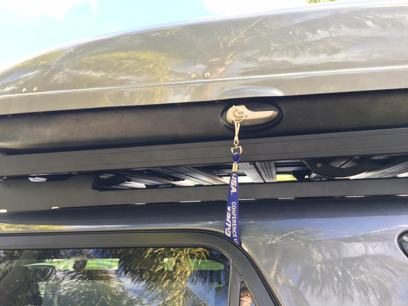

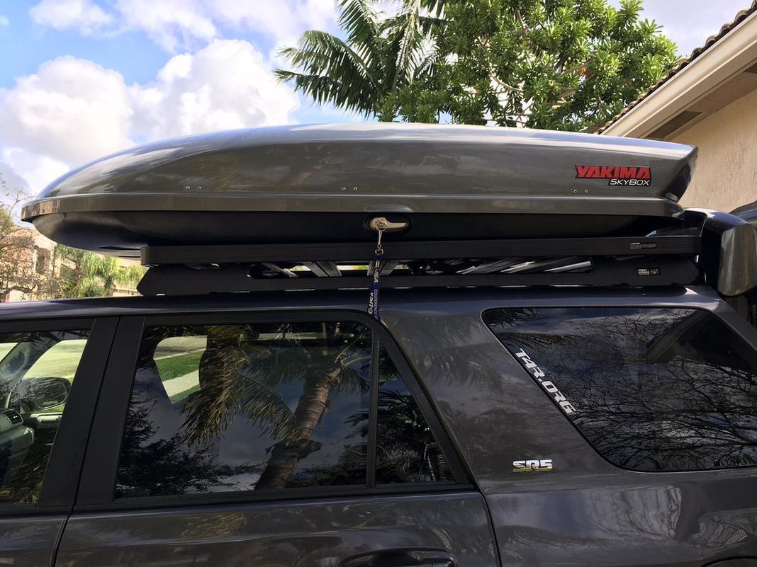

I found that the Skybox 16 actually fits better than with the Thule Aerobars. It took about 5 minutes to get the clamps adjusted onto the right rails. The 2nd rail for the front grabs and 5th rail for the rear seemed to give the best fit and allow for the rear hatch to fully open. All that’s left is to see if there is a noticeable noise difference with the Skybox and Frontrunner as there was not much with the Aerobars.

[MENTION=120701]Cymon[/MENTION] I just scored a Skybox 21 and tried to test fit it but seemed like it wasn't going in. Did you have to move a slot around or do anything special to get it to fit? Also how good does it grab on? considering it's not all the way around the bar.

Yes, to get the fit the first time I had to leave the slots loosened to get the correct width. The way I found to work best is to set it on the rack in front of the bars you want to put it on and loosen the clamp adjusters almost all of the way (don’t loosen too far or the screws will come out and that is a PINTA). Then have the grab clamps open (folded forward so the grabs are fully open). Slide the clamps on and then tighten everything up. I can send pics once I get back as we are out of town at this point in time.
These are the best pics I have right now.

Thanks, I figured I had to loosen the slots. i would appreciate more pics if you can When you get back. and it doesn't get loose with it not being around all the way through?

Will do. The clamps don’t wrap all of the way around the bars, but they do get around enough that when clamped down they are completely secure (when I shake the box the entire vehicle moves, but the box doesn’t budge). I found these that show the adjustment process.
https://youtu.be/CRvxvLXQR0s
https://youtu.be/2DdWO6WqMNU
For the Frontrunner bars you adjust so that the clamps can open up almost as wide as they can. You do have to fiddle/wedge the open mouth under the bar. I find it’s easiset to do the front first, and you have to do both front simultaneously. Once the front are wedged in between with the mouths under the rails then do the same for the back. After all 4 clamps are in between and under the rails then use the adjusters to slide the clamp mouths under the bars and tighten everything up.
I hope this helps, but I will send some better pics when I get home from our trip. I also have a short description of fitment on Post 90 of my thread.
