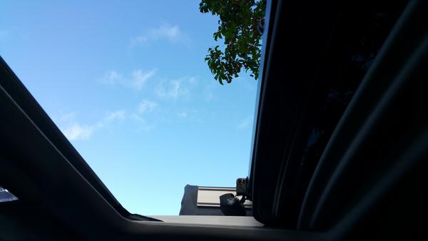

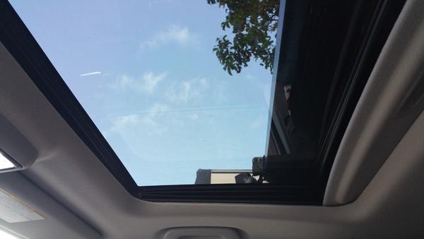

Could you possibly take a picture looking up from your moonroof? I'm curious how much the mid-sized rack blocks it. Trying to decide between the two sizes. Thanks in advance!

I'll post a pic in a bit. It doesn't block it much. Still debating going to a full length and drilling the roof.

Here are the pics. If you open the sun roof, the rack lines up with the glass.
When closed, the last slat just hangs over about 3-4 inches.

Thanks brother! The overhang doesn't look too bad. I was reading your build thread. Did you ever figure out the rattle/moonroof/deflector issue? That might make me shy away from the longer version. I plan on using my moonroof a lot during the warmer months.
