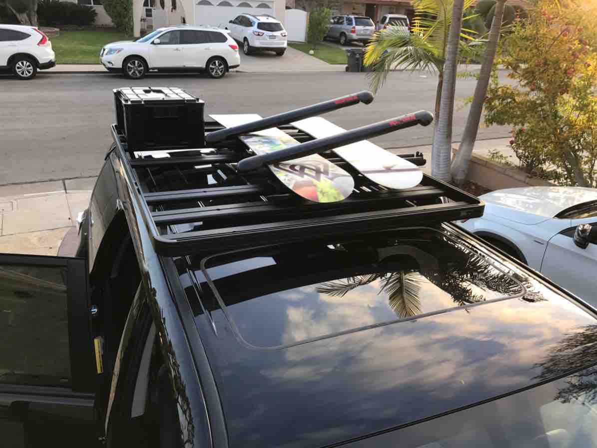

Just installed my rack Sunday. I'm sticking with my Yakima. I sometimes have 5 boards up with me so I need the capacity. Had to remove a couple slats in the FR rack to make space for the bindings. I don't see how you can have the clearance for a second board with bindings on the FR snow rack.

Looks good man. Yeah, I'll need to take the bindings off 1 board to fit 2 boards on the FR rack. I usually don't carry more than 2 boards when I go with my family. How many slats did you take off?

Just 2 but I could have probably kept one and adjusted the spacing a bit better. With that sb rack and removing the bindings it's probably not worth it to remove any. Even with the Yakima racks sitting a but higher of the bars, my bindings just barely have enough space to not touch the roof.

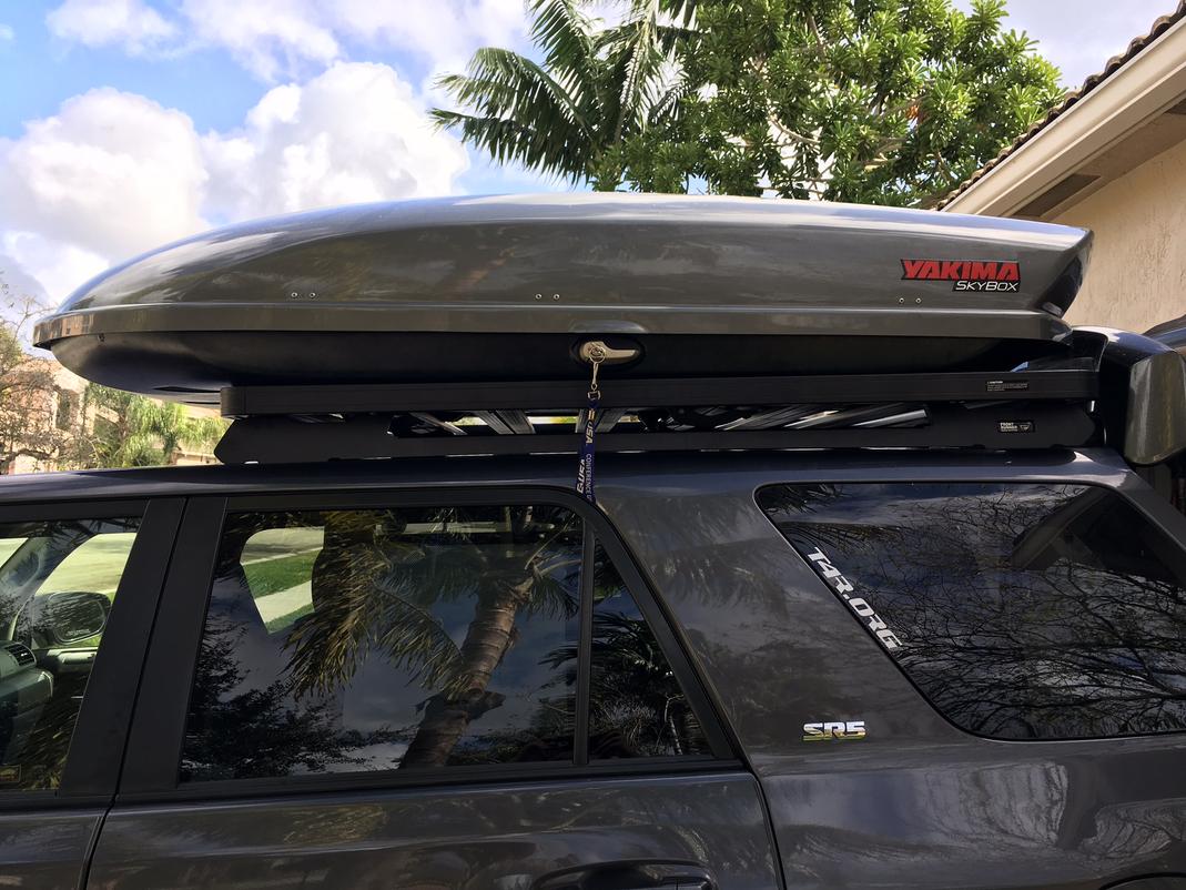

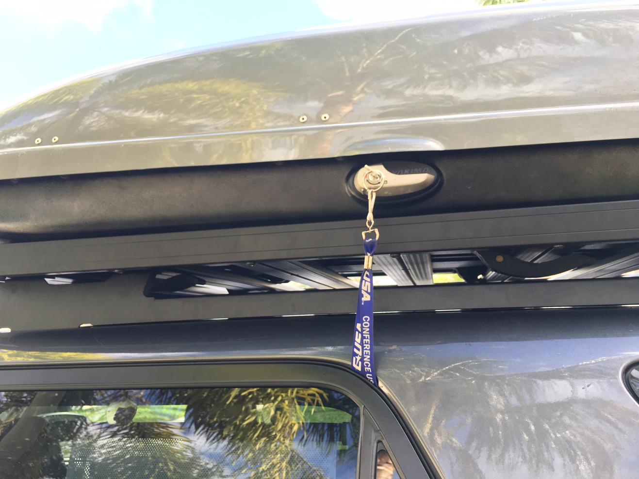

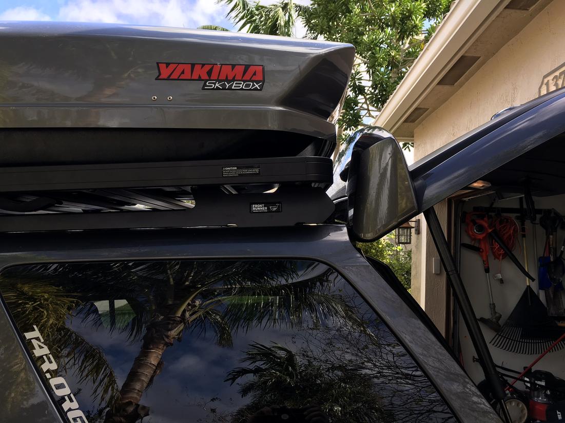

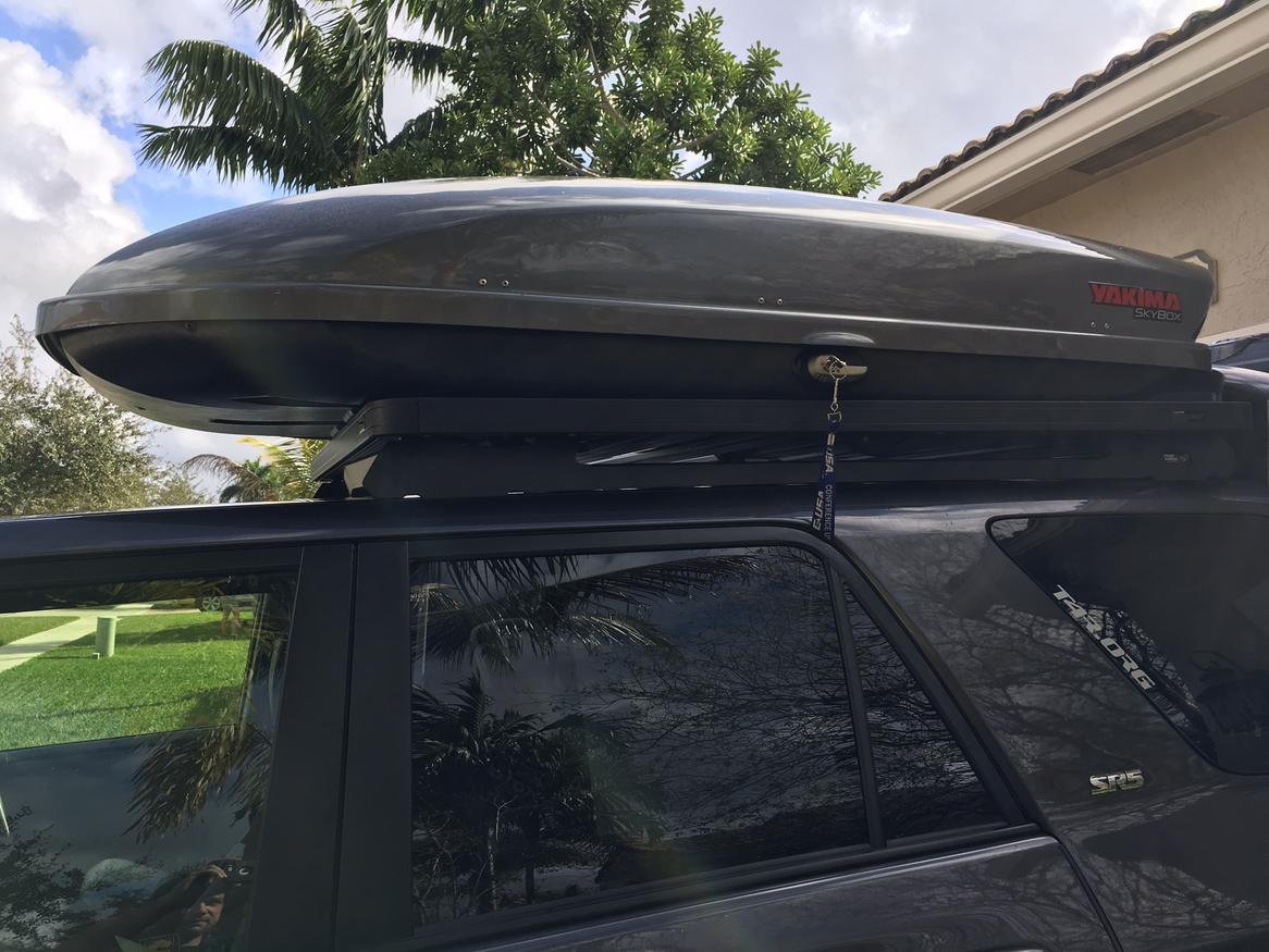

I found that the Skybox 16 actually fits better than with the Thule Aerobars. It took about 5 minutes to get the clamps adjusted onto the right rails. The 2nd rail for the front grabs and 5th rail for the rear seemed to give the best fit and allow for the rear hatch to fully open. All that’s left is to see if there is a noticeable noise difference with the Skybox and Frontrunner as there was not much with the Aerobars.

You rule! You are an Internet hero to one and counting ;-) Really appreciate you taking the time to post those pics. After the white knuckle sliders are installed the frontrunner rack is going on!
