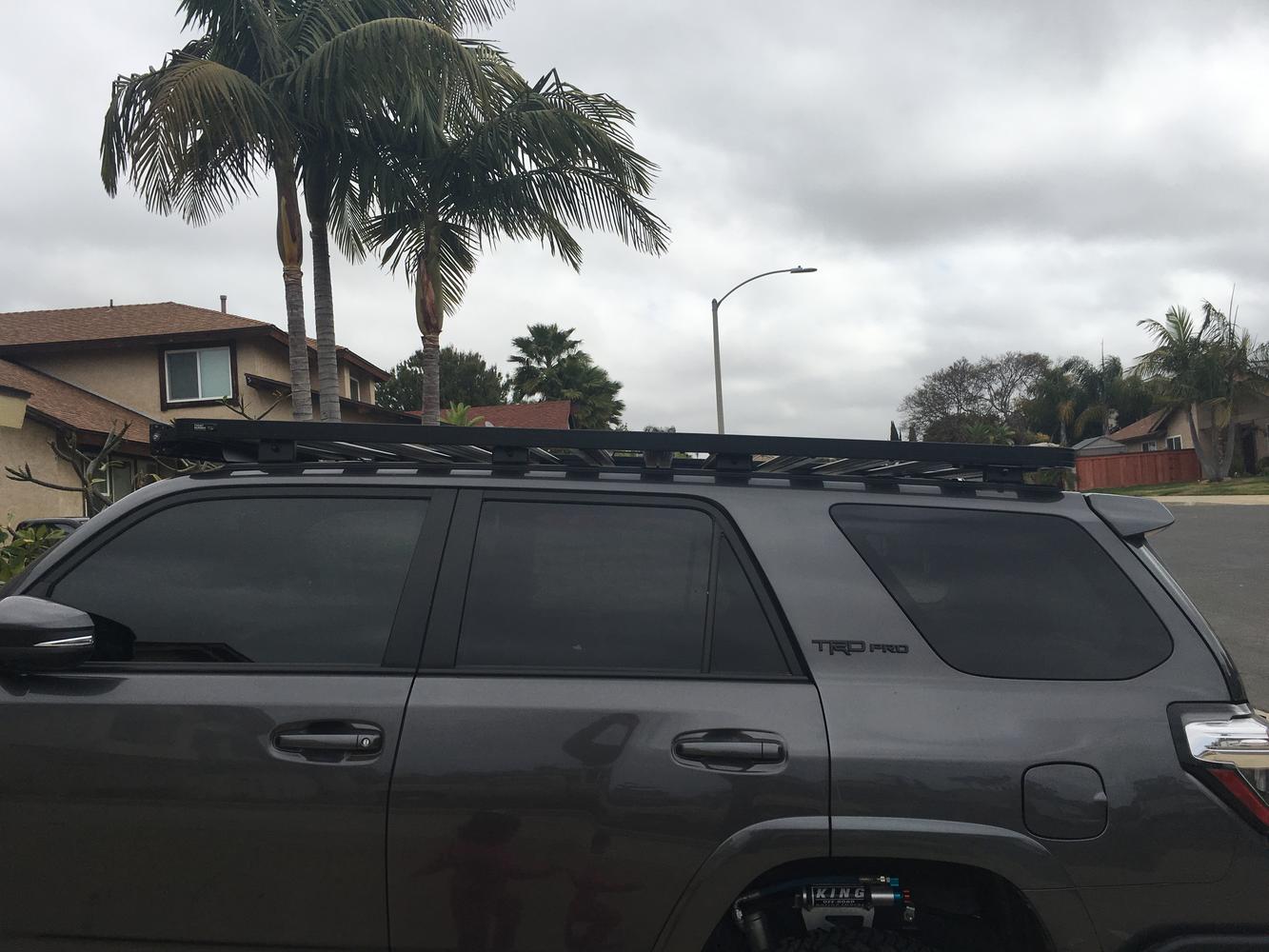

Just got my rack installed. This is with the (6) 40mm feet and (2) 50mm upfront.
And with the smaller xm antenna.

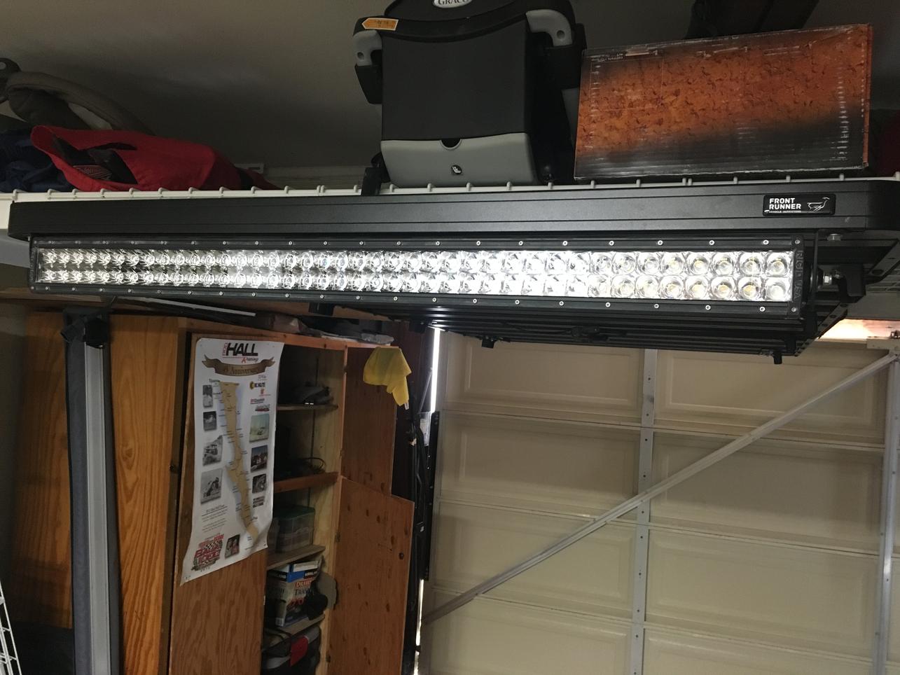

My front runner is much louder and, to be honest, annoying with my 40" e series light bar mounted to the front than the Gobi was. i am slowly ironing out the locations that are making the noise and they all seem to stem from the lightbar.
To be fair, i never ran the gobi without the light bar and had read that it was loud without the light bar or something else breaking up the air flow. The front runner with the light mounted below the front of the rack didn't have as much wind noise, but with the shorter feet, you can't run my light bar underneath. (I'll attach photos to better illustrate the two light bar setups so you can get an idea of what i am talking about)
overall, i don't regret the decision to go with Front Runner. the rack is infinitely better as far as configurability. It's a little pricier with all the accessories but is, lighter, won't rust, and adaptable to any trip or cargo.
hope that helps.
this is with the light bar below the rack leading edge

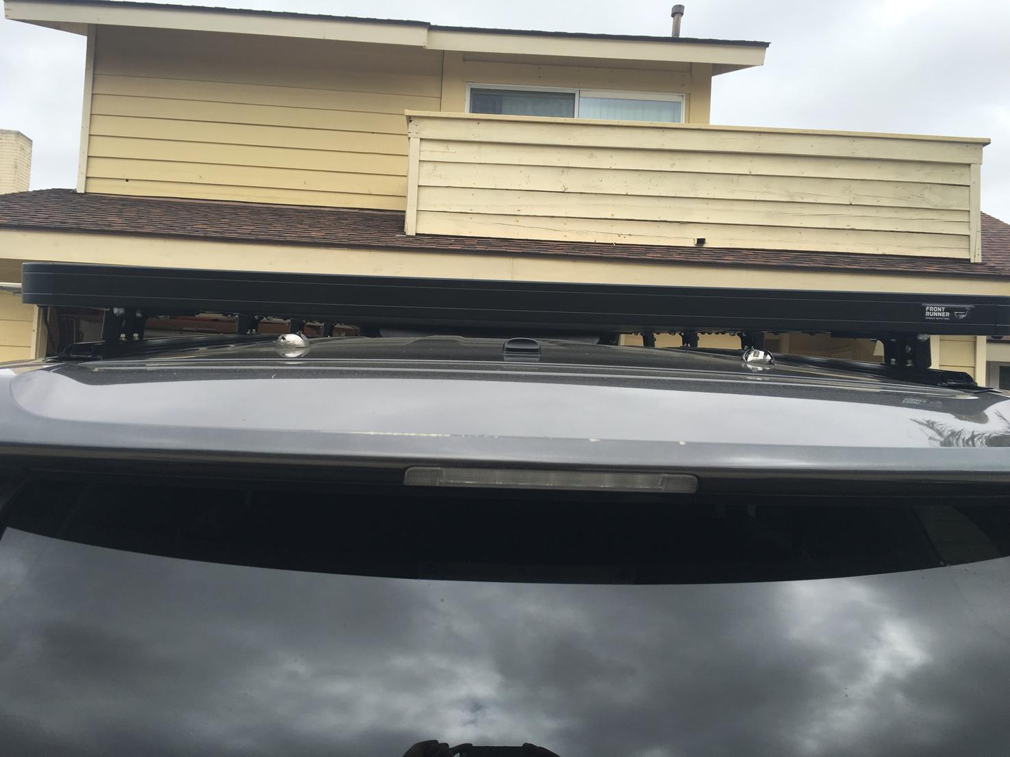

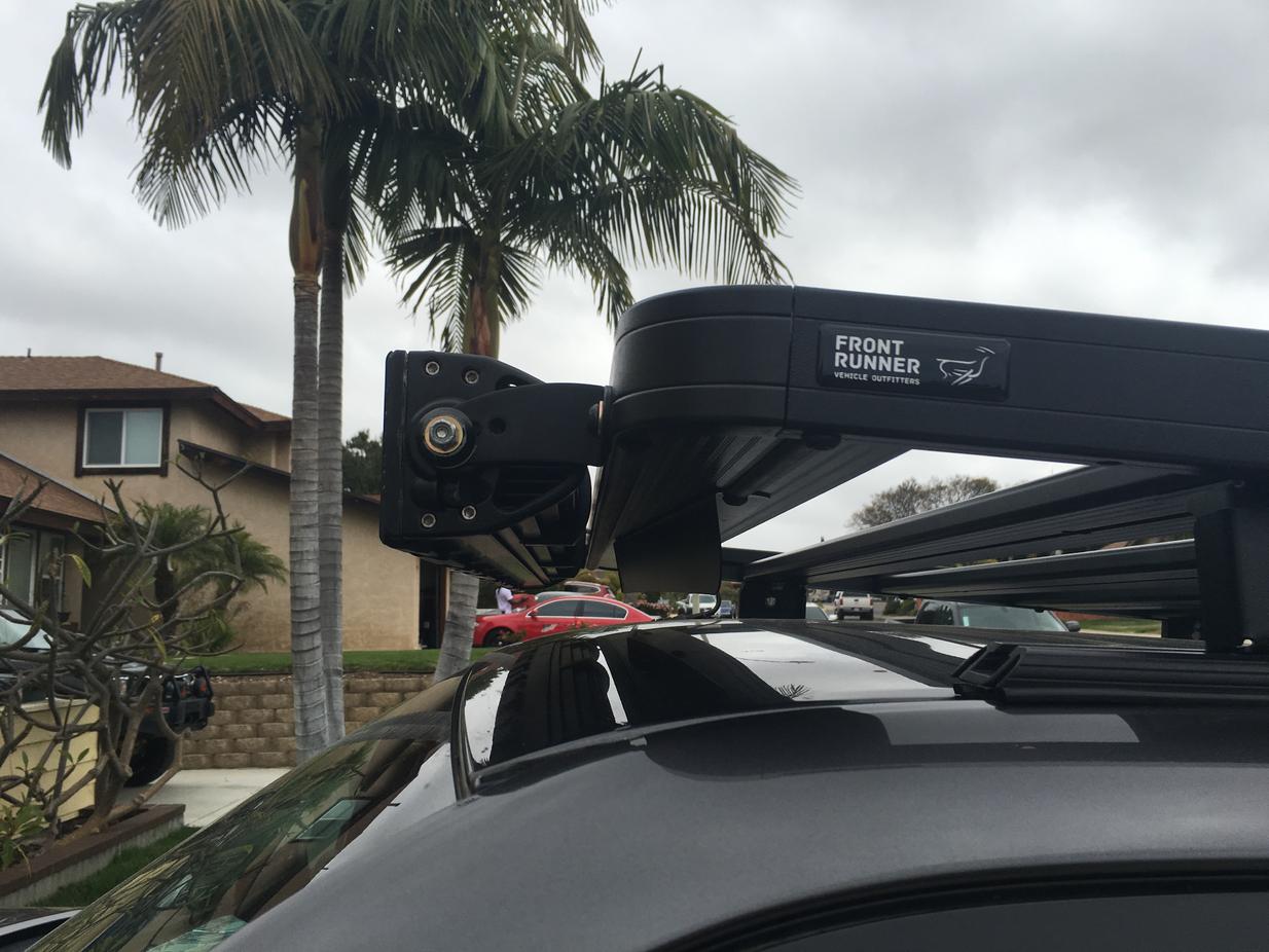

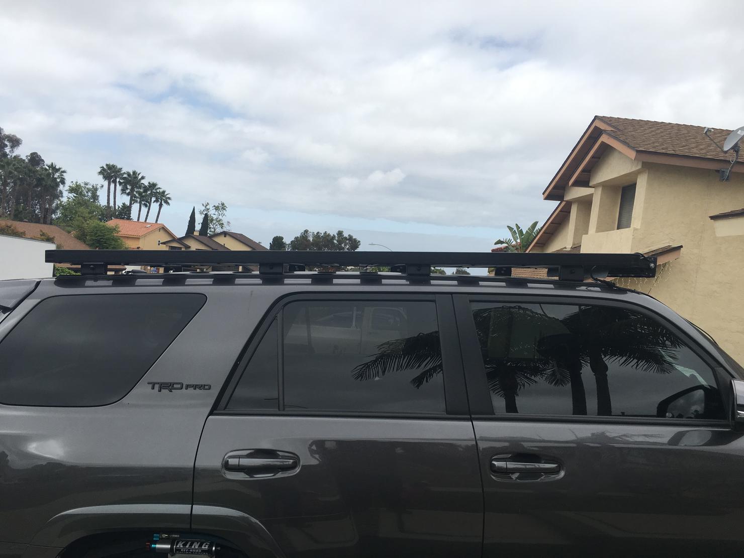

Here are some better photos. hopefully they come out well on here, its a bit overcast today.
this is with the light bar mounted to the front of the rack leading edge.
hope that helps.

I did choose to drill through the roof upfront. Its a little nerve wracking but doable if you plan it out and take your time.
The owner of Equipt told me that he didn't drill through he front of vehicle to mount his K-9 rack and just positioned the feet to apply pressure to the front of the rack to keep it down. While it obviously worked for him, it didn't make too much sense to me with all the wind going through the front, it would create a lot of leverage and just looked plain jury-rigged to me.
i don't plan on mounting more than a few wolf pack boxes and Maxtrax to the front so i am not too worried about the load on front of the rack. I can't vouch for how much that front mounting point can hold in terms of weight. I mount my RTT between the two rear OEM mount points.
Thanks for all the info and pics! Did you happen to test the Front Runner before mounting the light bar? I'm wondering if it was better before. I've done a lot of searching and results seem mixed, which leads me to believe a lot of it is probably sensitivity. I'm wondering if I should just stick with the short FR that doesn't overlap the moonroof at all.
The front Runner is not bad without the light bar mounted. It IS still louder than the Gobi but the Gobi also uses a rather large airdam.
the noise without the lightbar is just a heavy wind noise which is expected with anything above the vehicle profile, I wouldn't let it affect your decision if all your other requirements are met.
