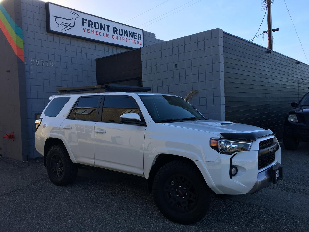

Stopped by Front Runner today and they installed the new rack and light bar. So happy with this rack. Glad I waited did my research on all the various rack manufacturers before going with Front Runner. This is the right set up for my needs.
Going to start attaching all my accessories tomorrow.
