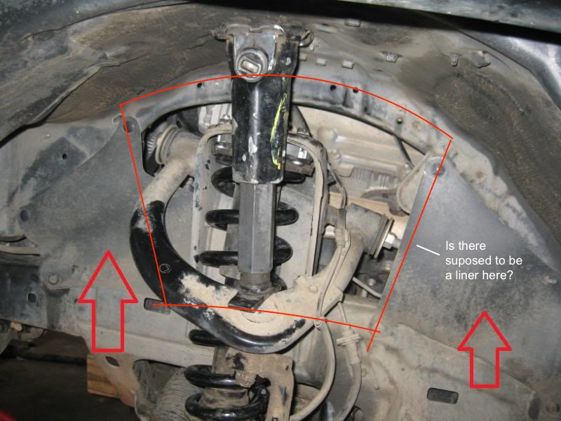

Anyway, I have never really looked in the wheel well and it just looks weird, like there is a liner missing. (see image for location I am curious about. That is not my truck but it is the location I am curious about)...
Can someone look inside their front wheel well and see if there is supposed to be a liner in that location?

Nope nothing should be there. All is normal.

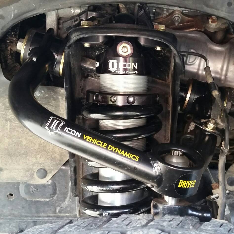

Here's a (closer) pic of mine.

Awesome
Thanks for that.

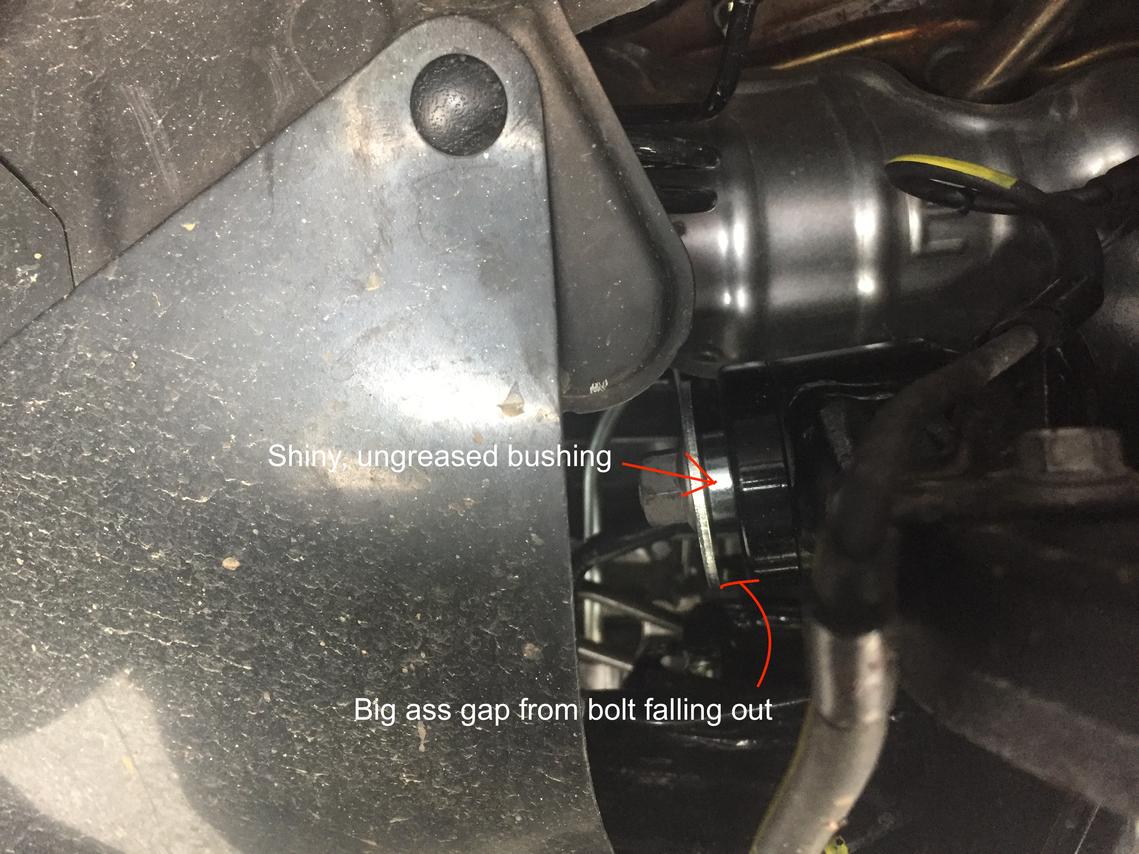

I have verified that they are the worst mechanics in the world (was driving and hearing clunking, looked in the wheel well (passenger) and the main bolt holding the new UCAs was loose! Loose enough that I could see 1/2" of the bushing that is supposed to be inside the UCA as it was working itself out (see image). They hadn't torqued anything apparently. It was hand tight lol. A few more miles and it would have been disastrous.
Anyway, I guess it was a little lucky that they screwed up because I could see that they had not greased anything (it is VERY clear in the SPC instructions that grease needs to be applied to the UCA bushings and the zerk)...

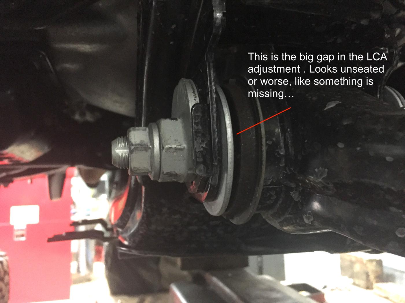

I have a new question because it looks like they might have screwed up the LCA when they did the alignment. I don't remember what it looked like before they got their hands on it but this looks wrong. Look at the big gap between the washer and the LCA. That can't be right, can it?

For the clunk, make sure your LCA cam bolts are torqued to 129 ft. Lbs. Also, refrain from posting multiple threads about (basically) the same thing.

Dude. If you had actually read the posts you would know that the clunk was diagnosed: it was because the clown mechanic had not tightened the bolt and the whole UCA was coming loose. I even included a picture of the loose bolt, ungreased, almost fully disconnected due to shitty mechanic work.
