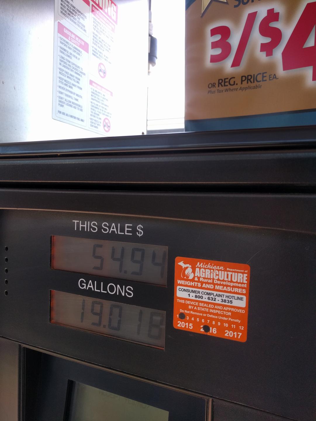

I see a lot of statements about the capacity of 4 runner tanks. I'll tell you that your 'capacity' which you all are determining by how much you fill up at the pump, depends on how you actually fill your tank up.
When you hold down the handle, gasoline travels at maximum flow from the station. Either the temperature change, flow speed or volume change makes the gas foam and take up more volume and triggers the mechanism to stop filling. If you give it a second and then continue to fill but only press the level lightly to reduce the flow rate, you can fill up much more gas.
I just filled my 4runner up with 19+ gallons. On the way to the station it was sputtering and I had to sway side to side to keep it flowing. Obviously this is not good for the car but the light goes on very late (unlike mr. 10 gallons). But, my point is more about the capacity! I'm not sure how I can fill up more than 18.5 so I'm going to call the weights and measures and complain as well.

Mr 10 gallon could also have a dented tank.
