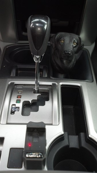

My choice, a '13 Sienna shifter knob.

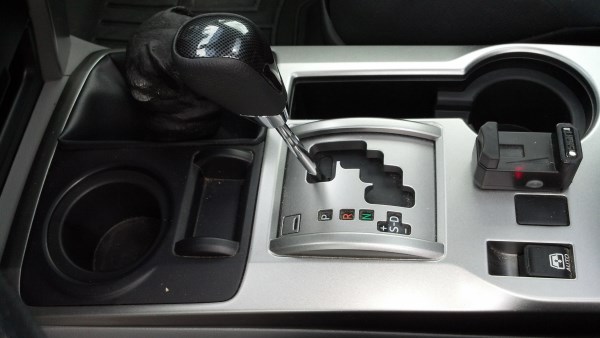

Check out my custom transfer case knob, always get the feeling someone's watching me :scared:

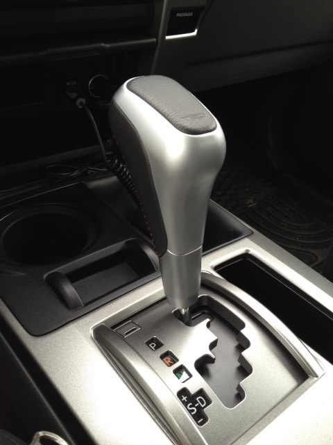

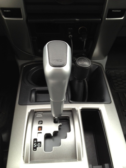

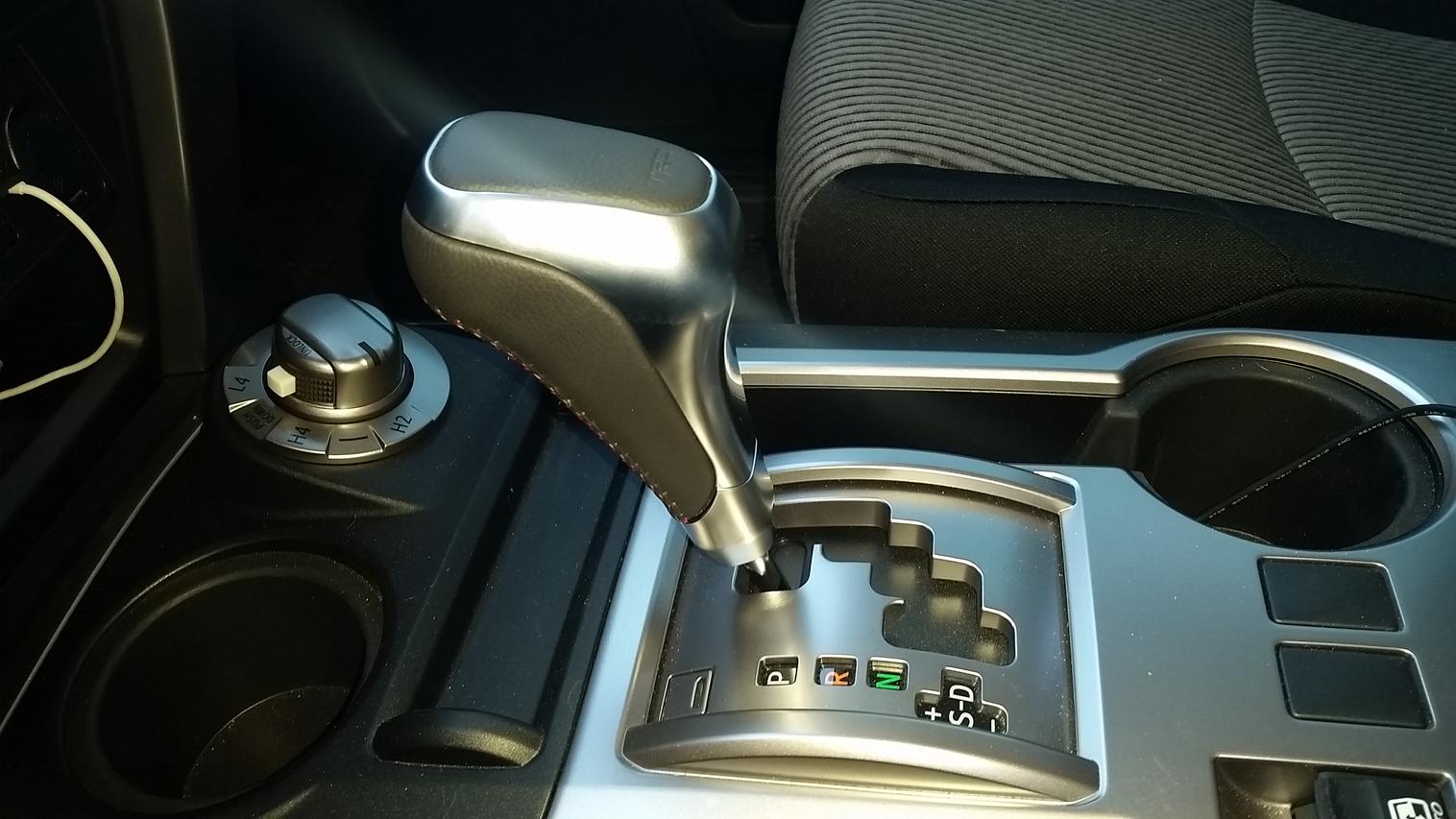

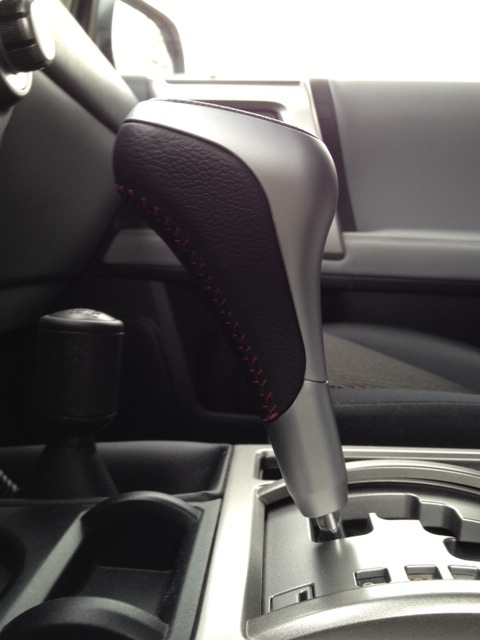

Installed this Leather TRD Shift Knob (# PTR51-00110) about a week ago....

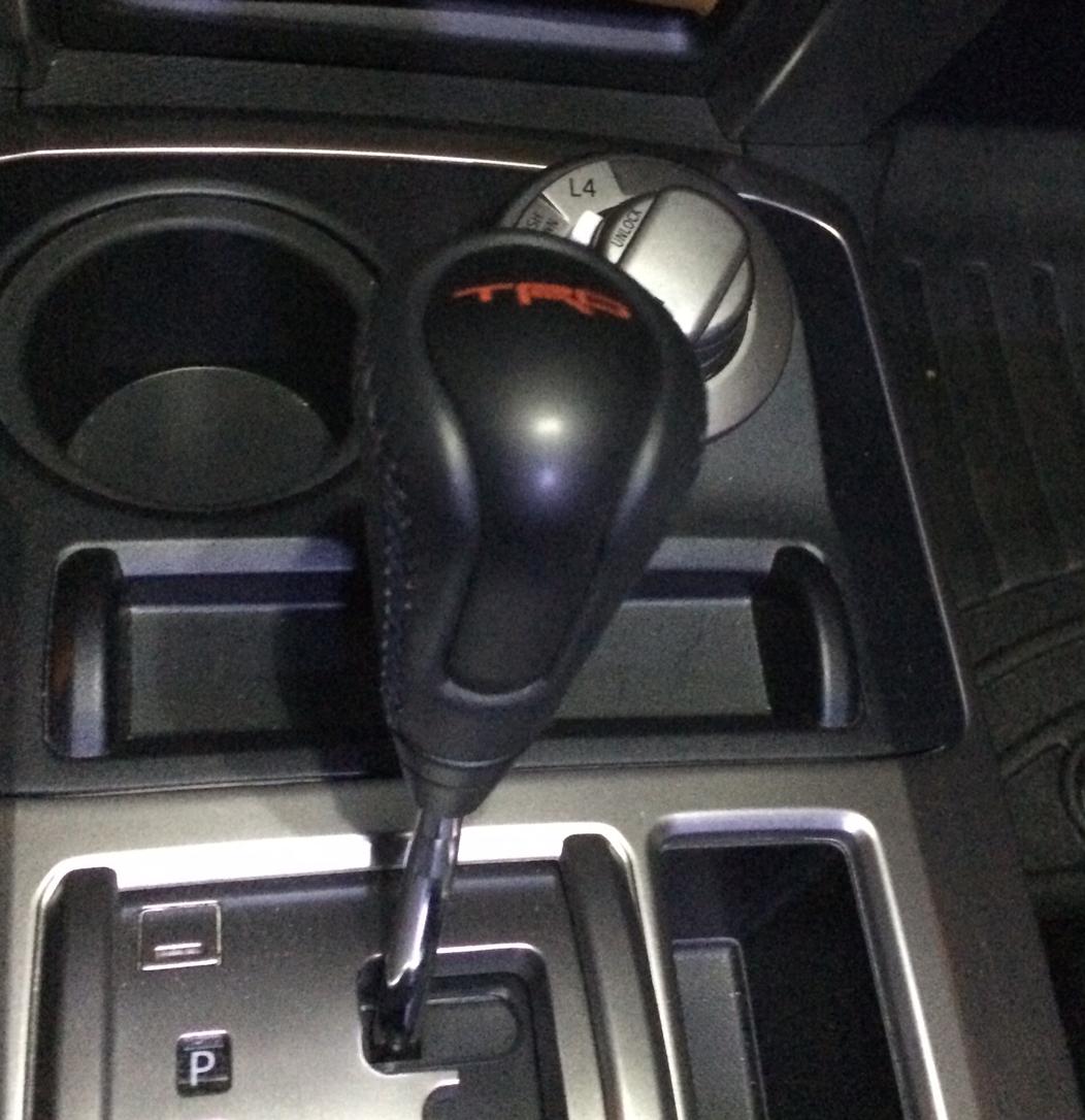

I love the look and quality feel of the TRD Pro shift knob. Best looking one IMO.
