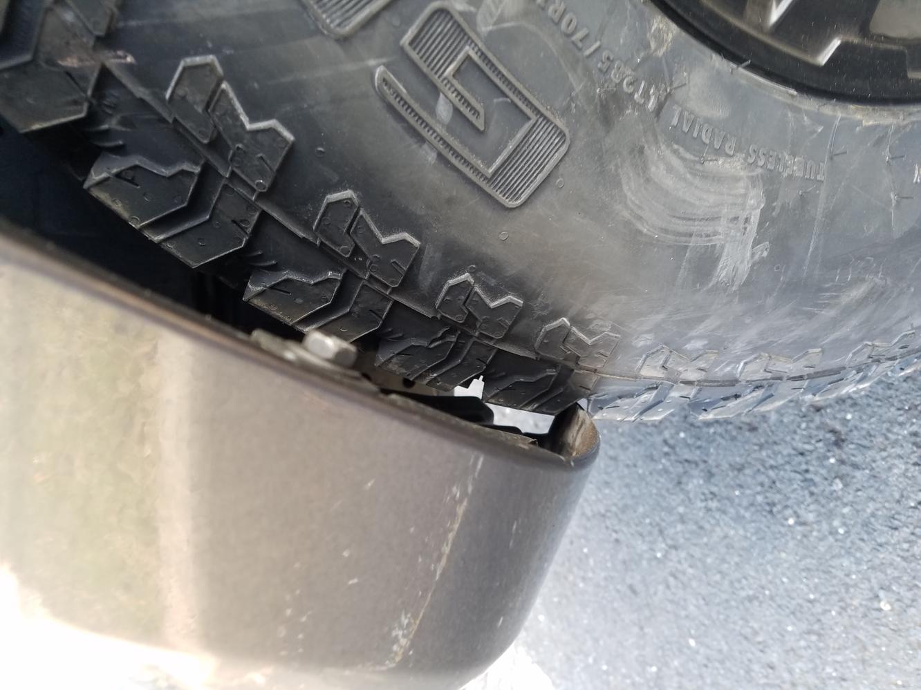

Just to give you an idea of how much you'll be trimming. I had my liner pushed all the way forward when my 285s were mounted and brought a razor knife when I picked her up. Trimmed the bumper in the psrking lot of the shop.
[emoji50] was it more than you expected?
