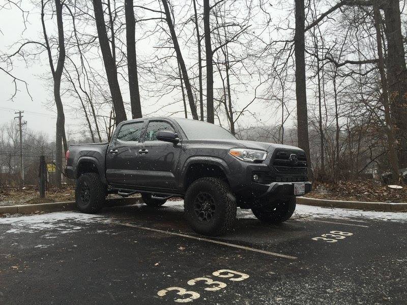

I can maybe sorta help with this. My 2016 Tacoma was lifted 3" on 285/75/16 General Grabber AT2 tires using the stock 16x7 wheel. Tires seat fine, wear fine, no issues at all. Not exactly apples to apples but close.
This is helpful, thanks.
I ended up going with 275s, but more because I didn't want to deal with rubbing issues.

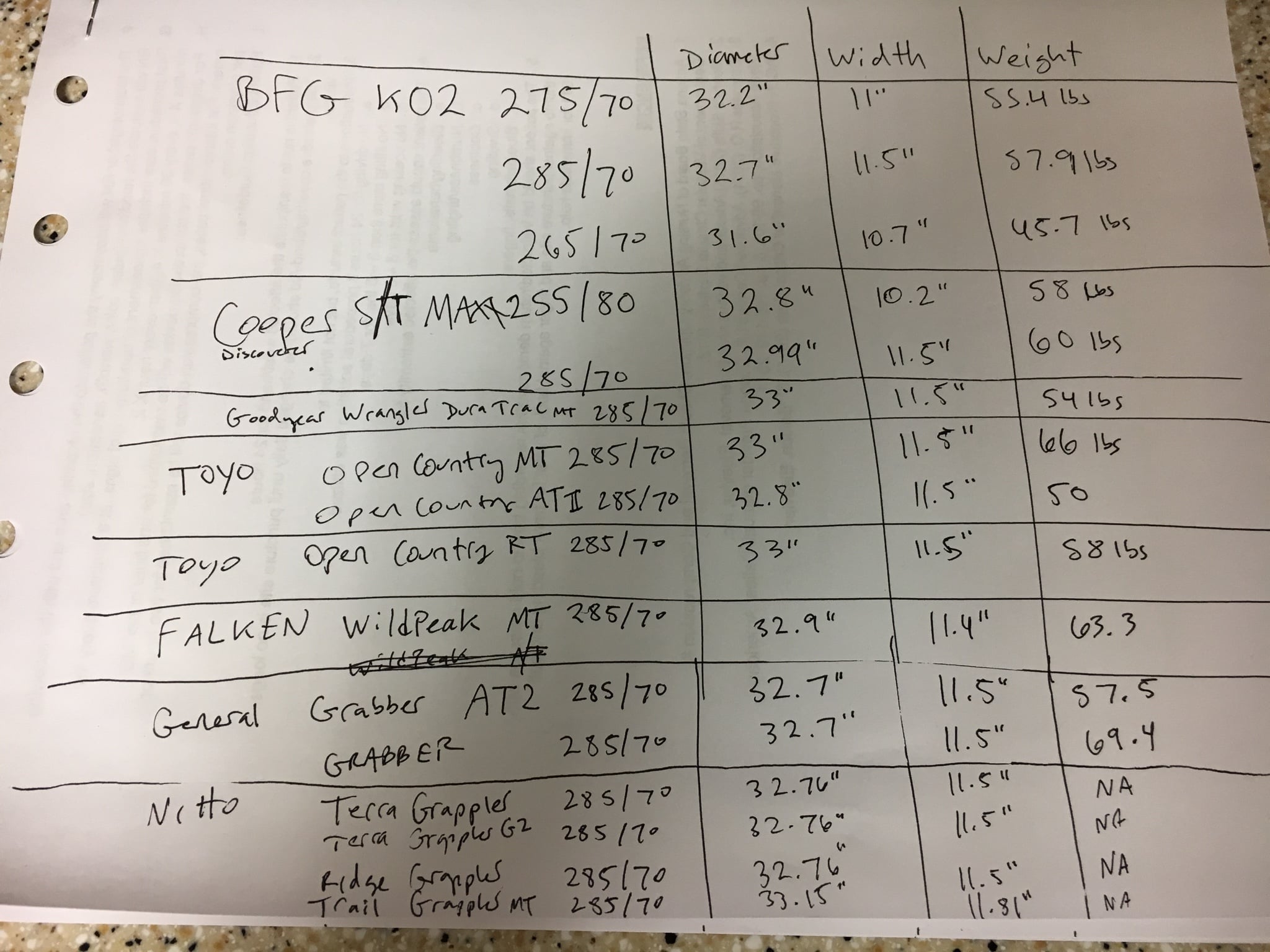

Here's a neat little chicken scratched grid I made on some popular 275 & 285 options, I did this mainly for tire WIDTH and WEIGHT.
