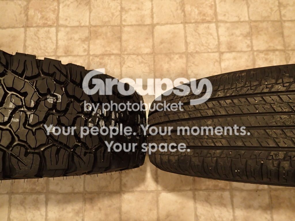

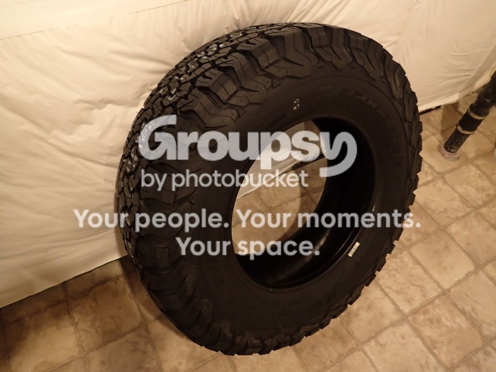

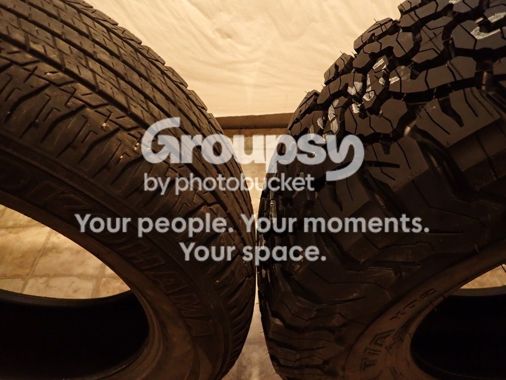

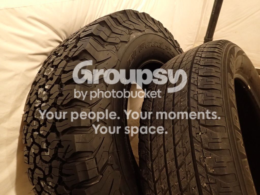

I picked up the tires during lunch, $796+tax for the set.
275/70/17 K02's compared to OEM 20s
