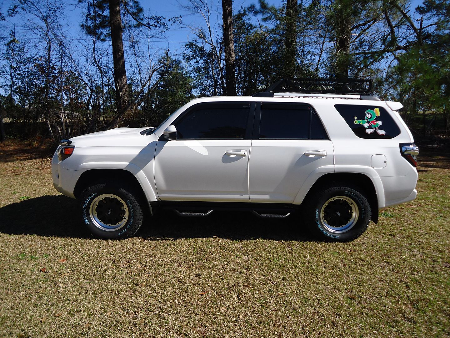

I originally went with the 1.75" front you have. My 265/70-17 Grabbers on an 8" rim with 4.5" backspacing had a slight rub on the left front fender at full right lock in reverse. Not enough to hurt anything, but enough to alarm my wife whenever she heard the grumble. So I'm thinking your wheel combo may do the same. Here are pictures before I added Spydertrax spacers that finally forced me to do the trim job.
