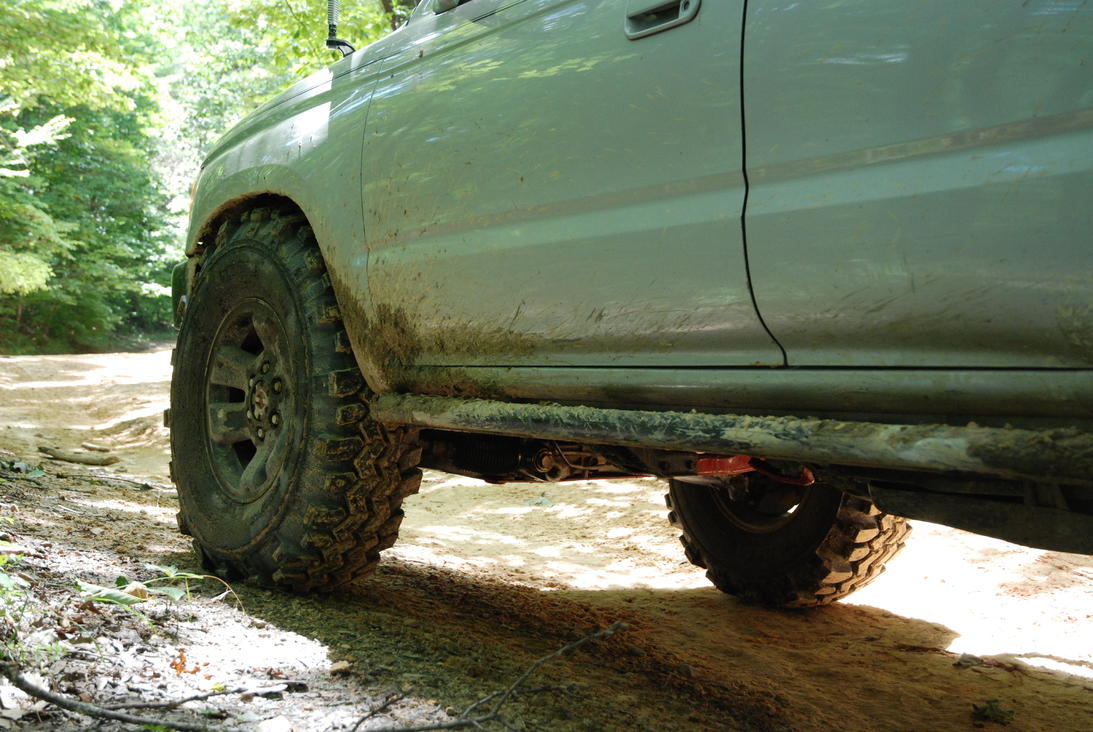

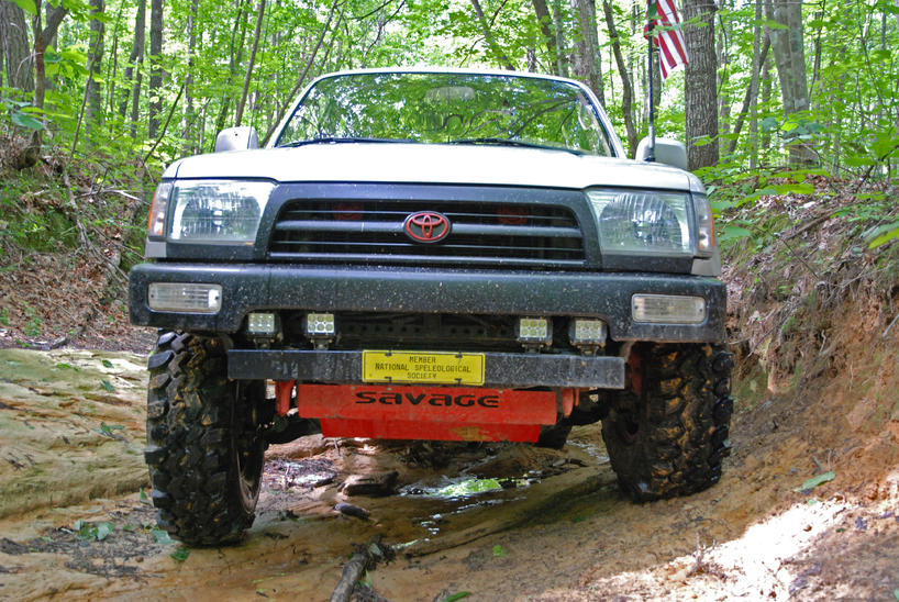

I have 34x10.50-16 super swampers on 99 talls with no rub. I had to cut/ pound my pinch weld and remove the bottom portion of the fender liner, but I have 0 rub!

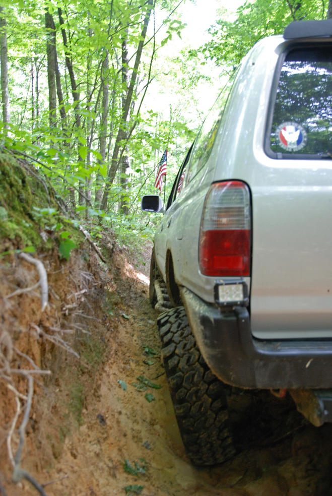

For the rear, I had to cut part of my bumper, but I think it would be fine with the 255/85s.

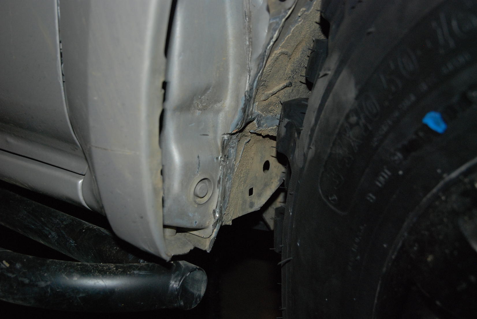

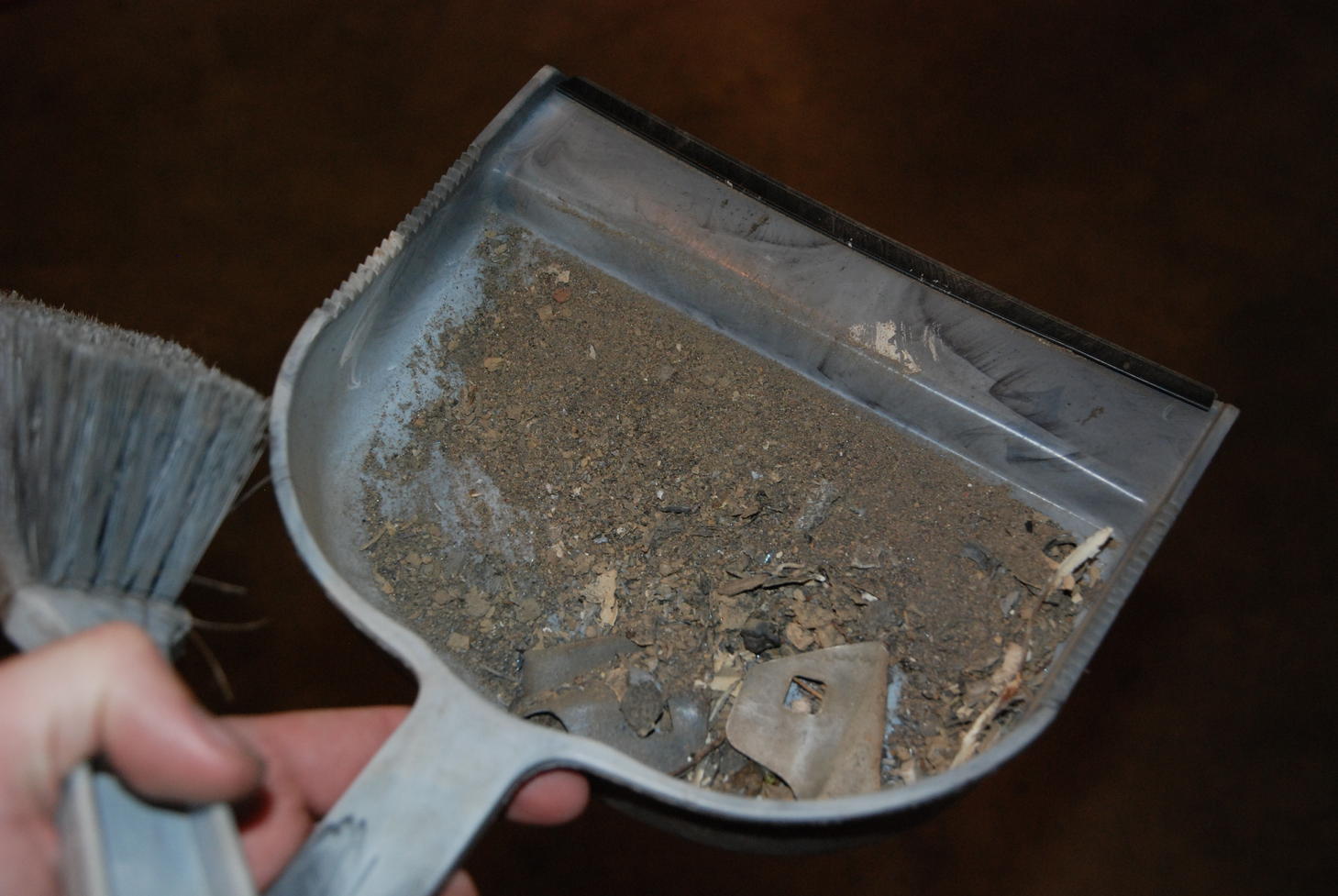

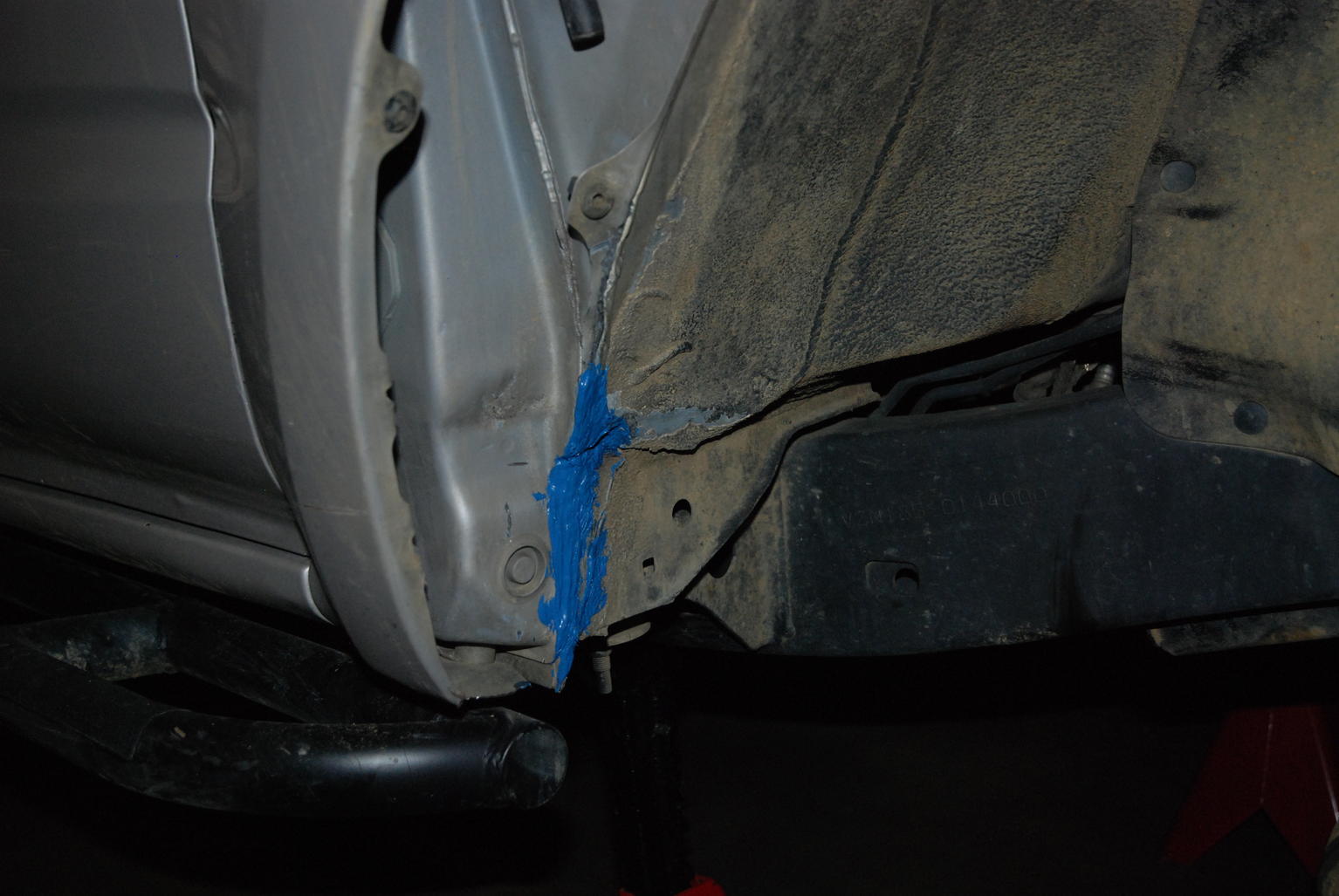

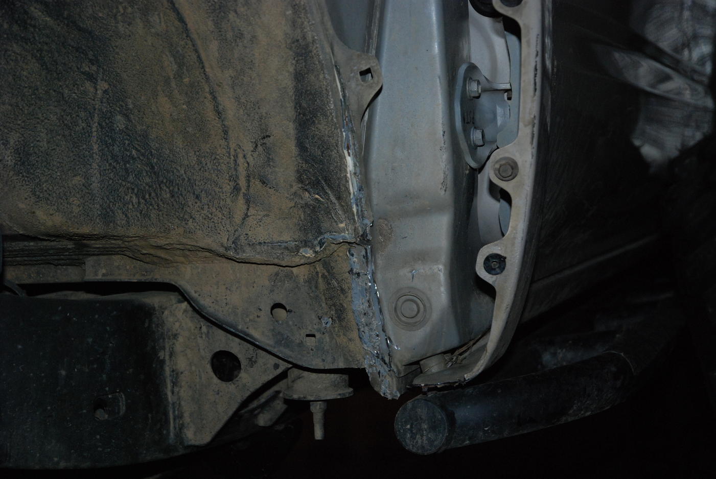

Here's all I did. Dfarms helped me with figuring it out. I cut across the pinch weld the folded it over with a hammer. I then hammered gently around the whole area. To check for rub, you take out the coilover and jack the suspension up to the bump stops and turn the wheel. If it rubs, hammer some more. After I was satisfied with it, I slathered it with some RTV silicone.
Passenger side
Driver's side
All the junk on the floor hahaha
And the results with absolutely no rubbing!
