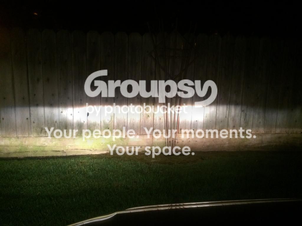

I was reading last night and came across this headlight mod. I never realized it was so popular! So I did it...
I used regular Philips H9's and 2011's. I followed the instructions I read in multiple threads here. Basically these bulbs can replace the stock bulbs in our headlights and highbeams. All that's required is to trim a couple of tabs.
I didn't take a bunch of pictures for a real writeup because I was in kind of a hurry. The only thing I had to do that I didn't read anywhere was trim one of the metal tabs on the H9. I used a dremel with a cutoff wheel for the metal tab, and a grinding bit for the plastic parts. Sorry again for not doing a real writeup. However, this mod is all over this forum and the internet.
Anyway, I did take a pic halfway through the installation so you can see the difference in brightness. This is with the engine running and the highbeams on. It is definitely a lot more output! The driver's side is the one with the mod, the passenger side is stock. Its noticeable in the pic, even more so in real life. Whiter too.

You mentioned "2011" bulbs.... I am assuming you typoed and meant 9011 which refers to the "HIR" type incan. bulbs.
The 9011's replace the stock 9005 high beam bulbs and are significantly brighter to my eyes, one of the best "bang for your buck" lighting mods there is. :wink2:
Awesome mod. I never messed with the H9's but supposedly those are a good improvement over the 9006's low beams.

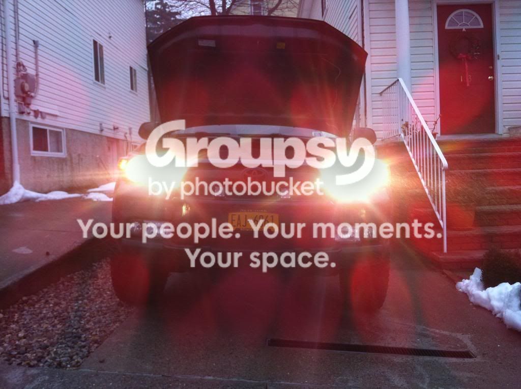

Truck is looking good by the way, I just noticed the LED's (Rigid D2's??) on the front bumper!

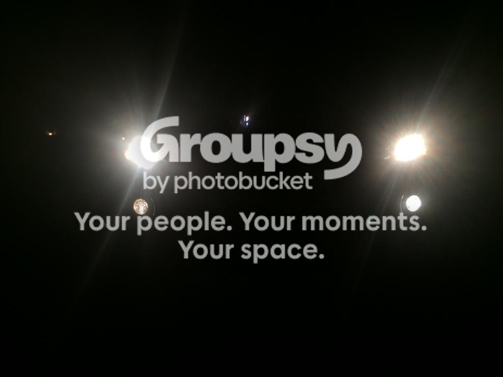

Let's say that in the garage the difference wasn't anything big. The light seemed a little whiter and brigther.
But once outside, in bad temperature, with blacked-out asphalt due to melting slush, the difference is clear.
Guesstimation is about 1/3 more light perceived up front, which is very good for such a low-cost and easy mod.
