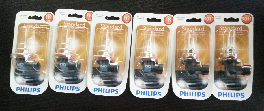

Look what just arrived, I've been wanting to do this mod for a while and well you guys gave me the last push :nod:
