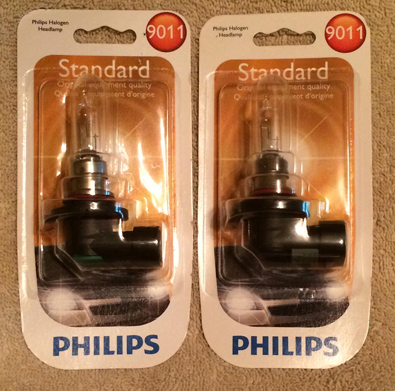

Installed my 9011 HIR Bulbs today....definitely tell the difference!
