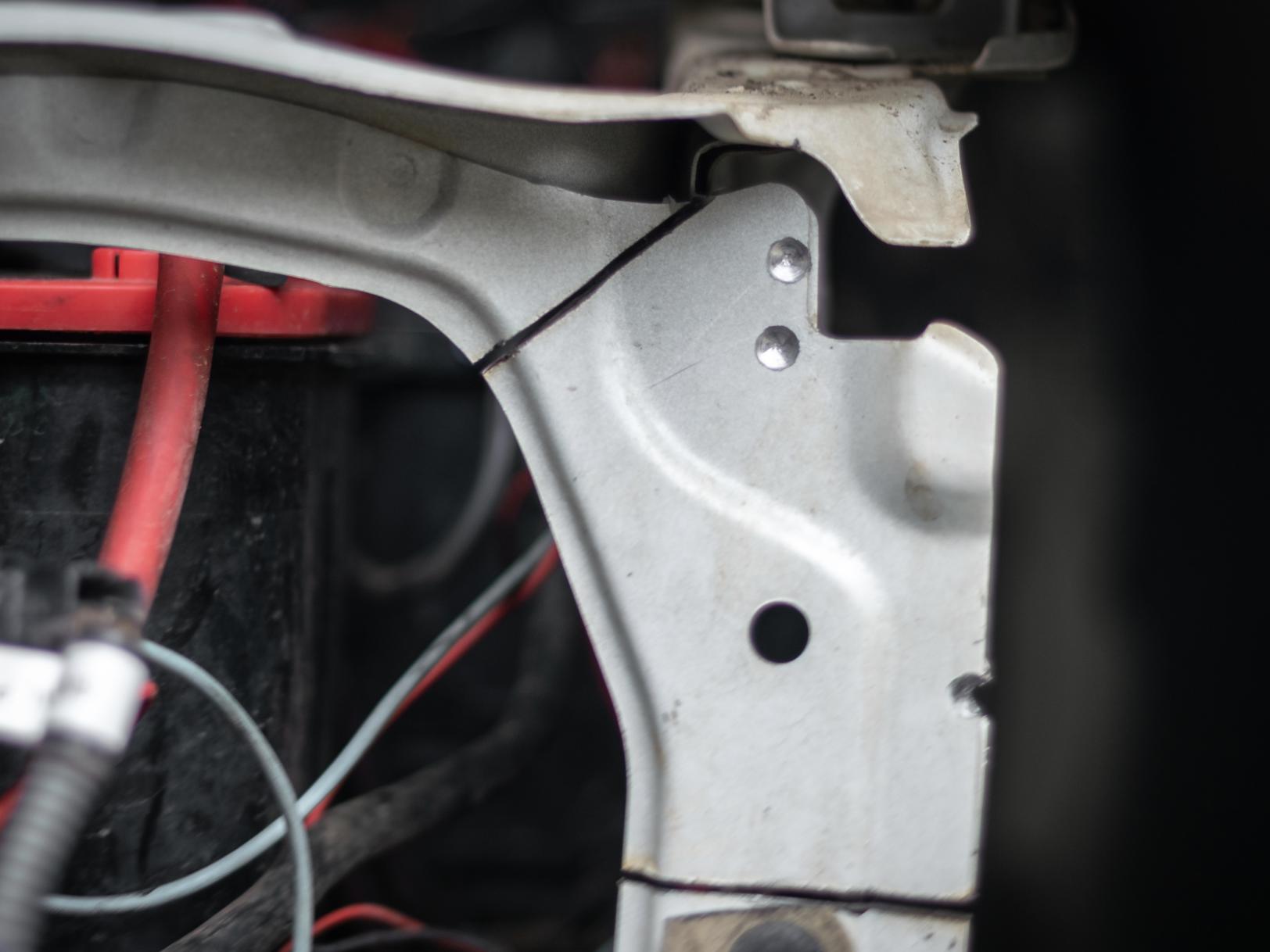

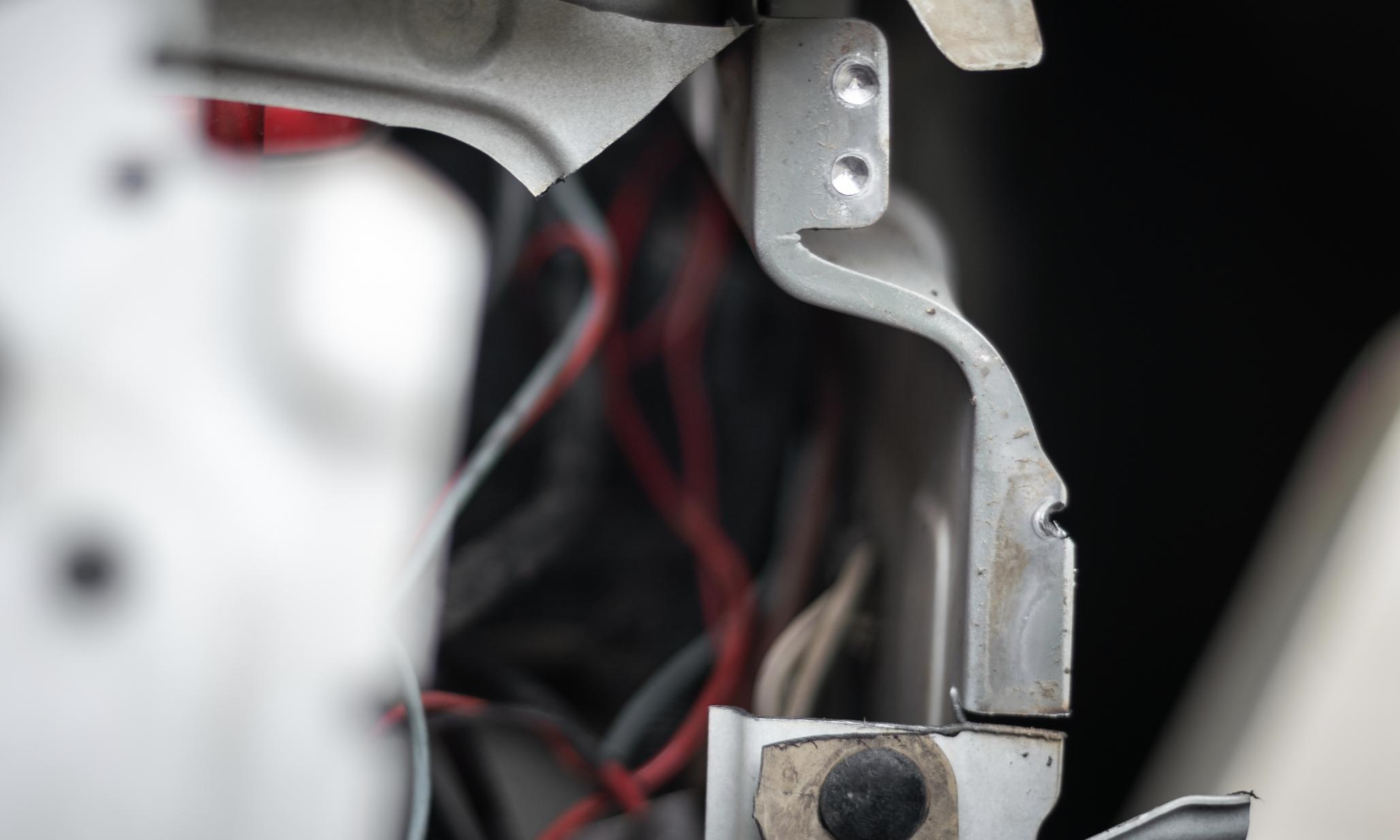

You have to call Kustom 54 and tell them you want that option. They don’t have it on their site because you have to cut the radiator support in order to fit them do to the size of the projector. Here’s the pictures that they sent me when I inquired about the 5.0s. I’ve cut so much off this thing now, it doesn’t bother me anymore.

I'd be really interested to see the back of these. I went with the IS projectors due to the limited space back there.
