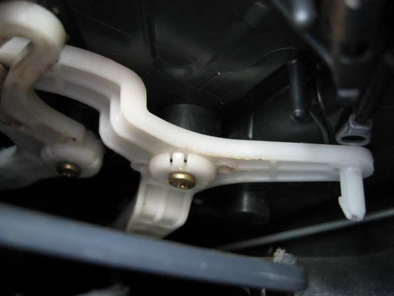

Take a look at the picture. Its from the passenger floor, looking up under from behind the center dash. See the eye-lit cable to the right of picture? Its disconnected from the white piece that moves your blend door and it SHOULD BE connected. Check if yours is the same way. Or see if you see any other cables disconnected under there. IF not i would check behind the center heater controls to see if anything is loose.
Other than that. It might sound like a bad (clogged) heater core.
I really appreciate your time. I have already checked that particular cable, and it's connected properly.

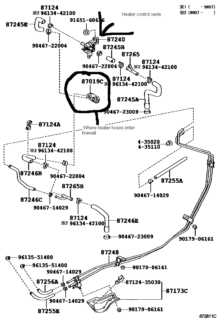

See if this picture helps you get a better idea?!
That's a huge help. I will be taking a look after work tonight and see if I can make sense of it. It's interesting to try to read this diagram however. The hose marked 87246E leads to... nowhere? haha.
Is it possible that the part labeled 90467-23009 attached to the hose labeled 87246E comes back and attaches to 87245A (other side of the heater control valve)? Are these numbers simply part numbers or reference numbers?
Also, I saw that you edited your post recently with t-stat instructions. I will for sure check this out as well. Thank you for your patience and help.

Part # 90467-23009 are hose clamps for the hoses.
I think they are reference numbers 87246a and 87246e go to either the intake and a steel heater hose not the heater valve.
