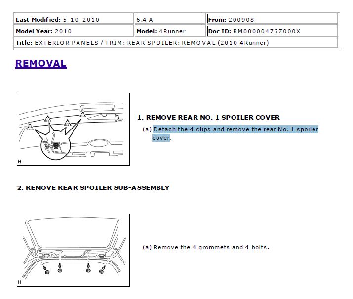

I’m probably being a knucklehead here, but I’d rather ask than break something.
I’m chasing a really annoying noise vibration that I suspect is the black plastic “No. 1 Spoiler cover” in the drawing. I want to remove the damned thing as my first step, but I’m stymied by “Detach the 4 clips …. etc”.
I just can’t make sense of the exploded view, and some prying and looking with my flashlight just doesn’t reveal any “clips”. Do I just yank the cover off?
Thoughts appreciated.

Just pull down on the plastic wiper motor cover. I ran out to the garage to get some pics for you. The white retainers are the same ones that are holding the door panels. Just pull straight down or use a trim removal tool and wedge it in the slot towards the back of the truck.

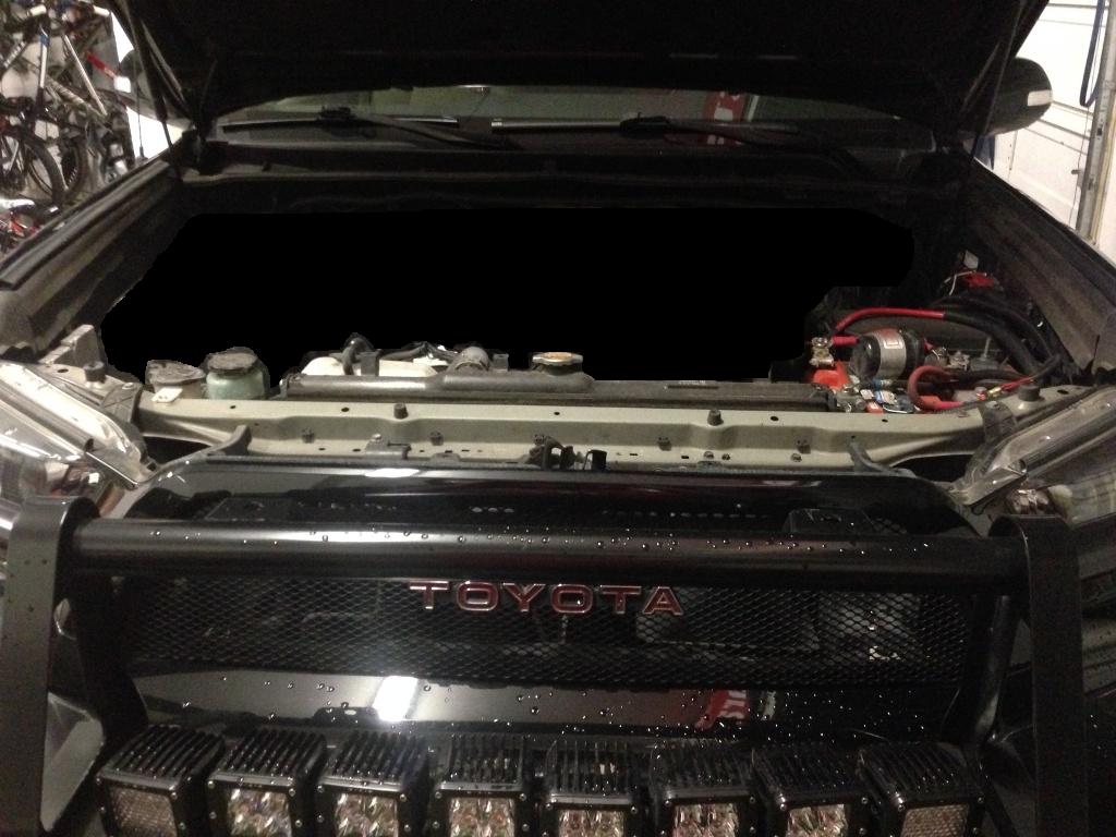

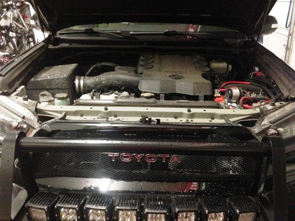

Ask and you shall receive. Although the FSM doesn't go into complete detail, I did my best.
BEFORE
And AFTER

Why can't the stupid RM just say yank the cover off, hrm?
Why can't the stupid reader just look carefully at the blown up cutaway diagram in the RM and realize that it depicts a clip which needs to be pried off, hrm?
Well, now that it's off, and I've seen the 'clips', I still don't understand the drawing of it. Ah, no matter, as long as we have the Duc Support Line. Thanks again Duc, we'll miss you if you ever get a yob.
Absolutely no help now, and not sure if you knew or realized, but future ref anytime you see dashed lines indicating a location or around an object in the manual it means that is it behind something or not visible from the diagrams view.
