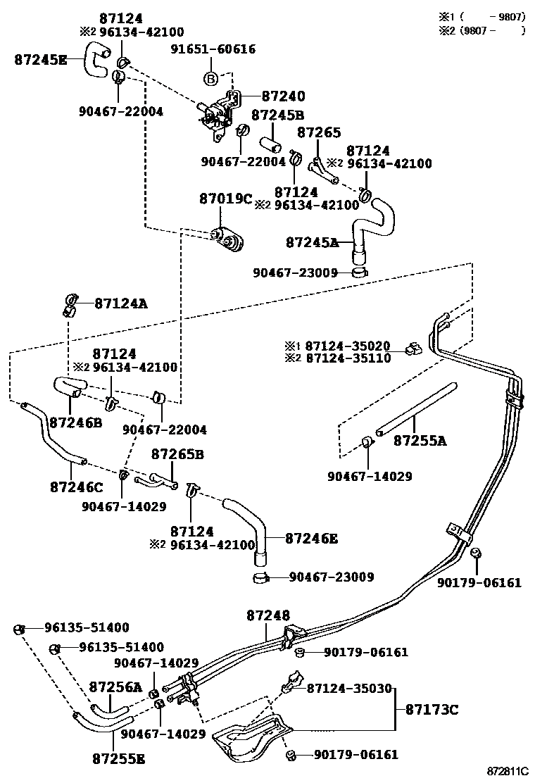

Believe these are the two hose you're referring to. They are for the rear heater.
87246C HOSE, HEATER WATER, OUTLET C **245-3D090
87255A HOSE, REAR HEATER WATER INLET, A(FROM ENGINE) **245-35770

Thanks Durk. I went to the dealership to confirm and they seem to be the right ones. I looked at the links you gave me, but they were $30 after shipping and would take a while to get here. Amazon was a couple dollars cheaper, but wouldn't be here until next week. I ended up just getting them at the dealership for an extra $8 and I get them Tuesday... just in time for my weekend - Wed/Thurs.
Appreciate the help as always!!!
