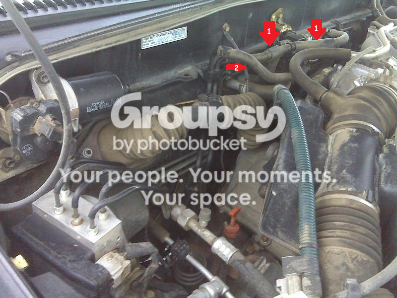

I'm replacing all of my coolant hoses and I can't seem to find these last two. I've been to the dealership and what they think the two hoses are they can no longer order. They can't even give me a part number of what it's supposed to be.
This pic isn't my rig, but it has the same setup on the firewall as mine. Hose 1 goes across the clip and has one protective sleeve on either side. It's about a foot long. Hose 2 is about 5 or 6" long then a soft 90* turn to just above the arrow in the pic.

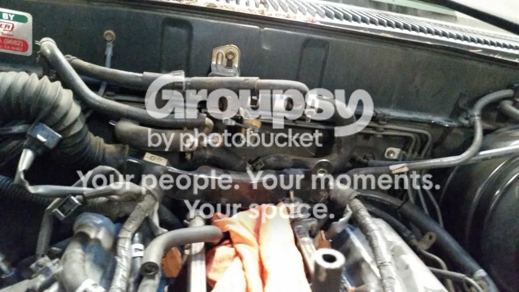

Turns out I do have a pic of my own firewall...
The two hoses front and center.
Anybody have any idea what these part #s are and where I can get them? I would prefer Toyota brand hoses, but at this point will take anything I can get.
Believe these are the two hose you're referring to. They are for the rear heater.
87246C HOSE, HEATER WATER, OUTLET C **245-3D090
87255A HOSE, REAR HEATER WATER INLET, A(FROM ENGINE) **245-35770

Thanks Durk. I went to the dealership to confirm and they seem to be the right ones. I looked at the links you gave me, but they were $30 after shipping and would take a while to get here. Amazon was a couple dollars cheaper, but wouldn't be here until next week. I ended up just getting them at the dealership for an extra $8 and I get them Tuesday... just in time for my weekend - Wed/Thurs.
Appreciate the help as always!!!
