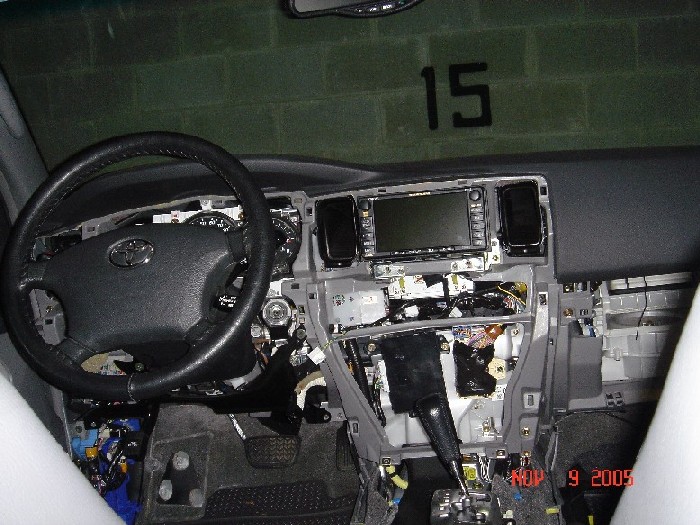

I have installed a New 2006 NAV unit into my 2003 T4R.
It was a drop in replacement. I got a camry unit with JBL AMP from 4Runner. I am not sure of hte year on the JBL amp.

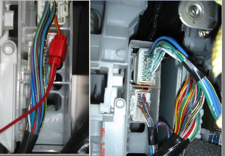

I do however have a problem. I cant seem to find the reverse sencor wire. The wire harness mentioned in the install guide (by the way great guide) does not match colors on my car. The one behind glove box.
Look at the pic provided my harness is on the right there are no red wires. I am stuck. The system seem to work ok, but i am sure i am missing something.

Question Question!!! I have not been able to find the reverse sensor. So i did not connect to it. Unit seem to work fine without it. Where is the reverse sensor? The color of wires on the diagram I found here is different. What do i do?

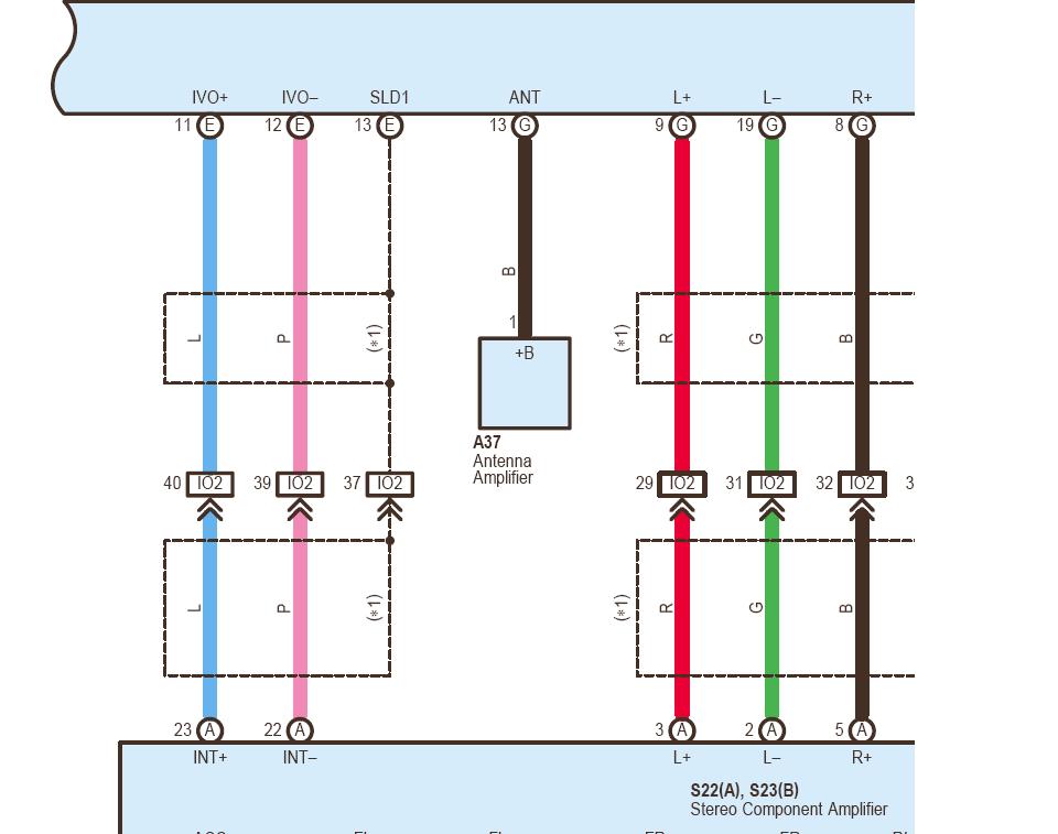

Instead of installing the seperate speaker... I tried this, and it has worked on my fathers 05 Limited. (It also worked on my 06 Limited) with JBL 10 Speaker, and adding a Nav.
