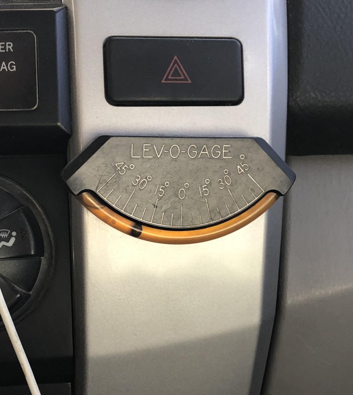

Almost forgot about this easy addition. Lev-O-gage. This was something I kept when I sold my old square body GMC High Sierra. I sticky back hook and looped it on there. I’ve seen guys put em on the B-pillar too.

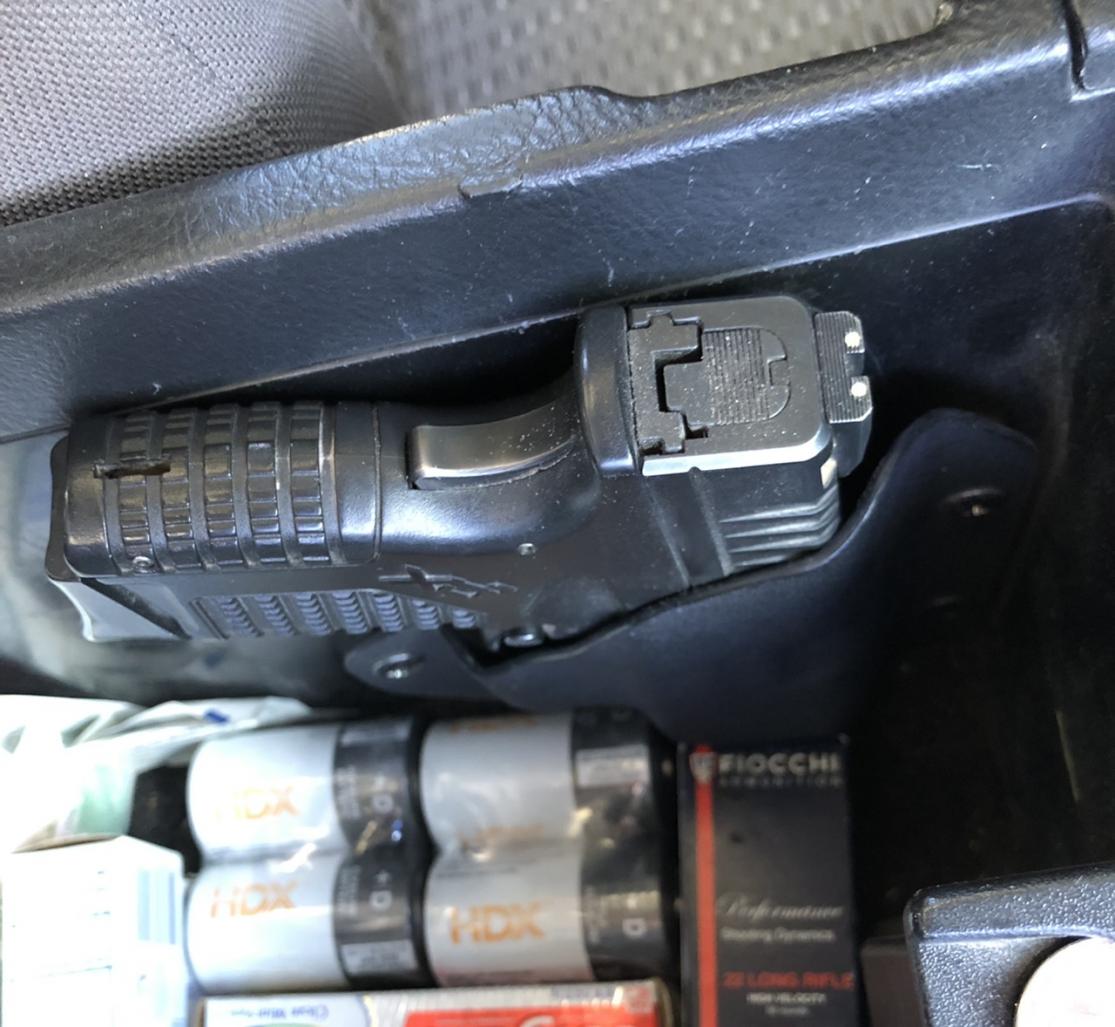

Kydex holster
Made a holster inside the center console a few years ago out of .95 Kydex plastic for my Springfield XD-S .45
It should go without saying. Be sure to check your local laws in regards to concealed carry of a firearm in your vehicle if doing a mod like this.

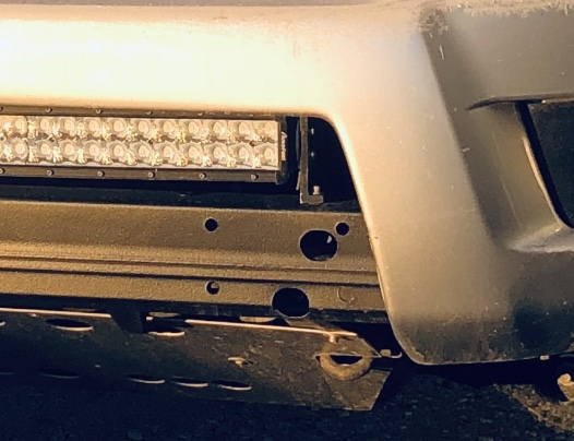

I mounted a 32” curved light bar to the top of the crash bar in the lower grille opening.
I bought the 40” light bar new in box from my buddy for forty bucks. I made brackets to mount it to the roof rack.
I bought these cheap GS Power ditch light brackets for a Tacoma off of Amazon along with some cheap Nilight light pods. The fit is decent.
You have any pictures of how you mounted the light bar to the front cross member? I've got a Stedi Light Bar and want to do the same!

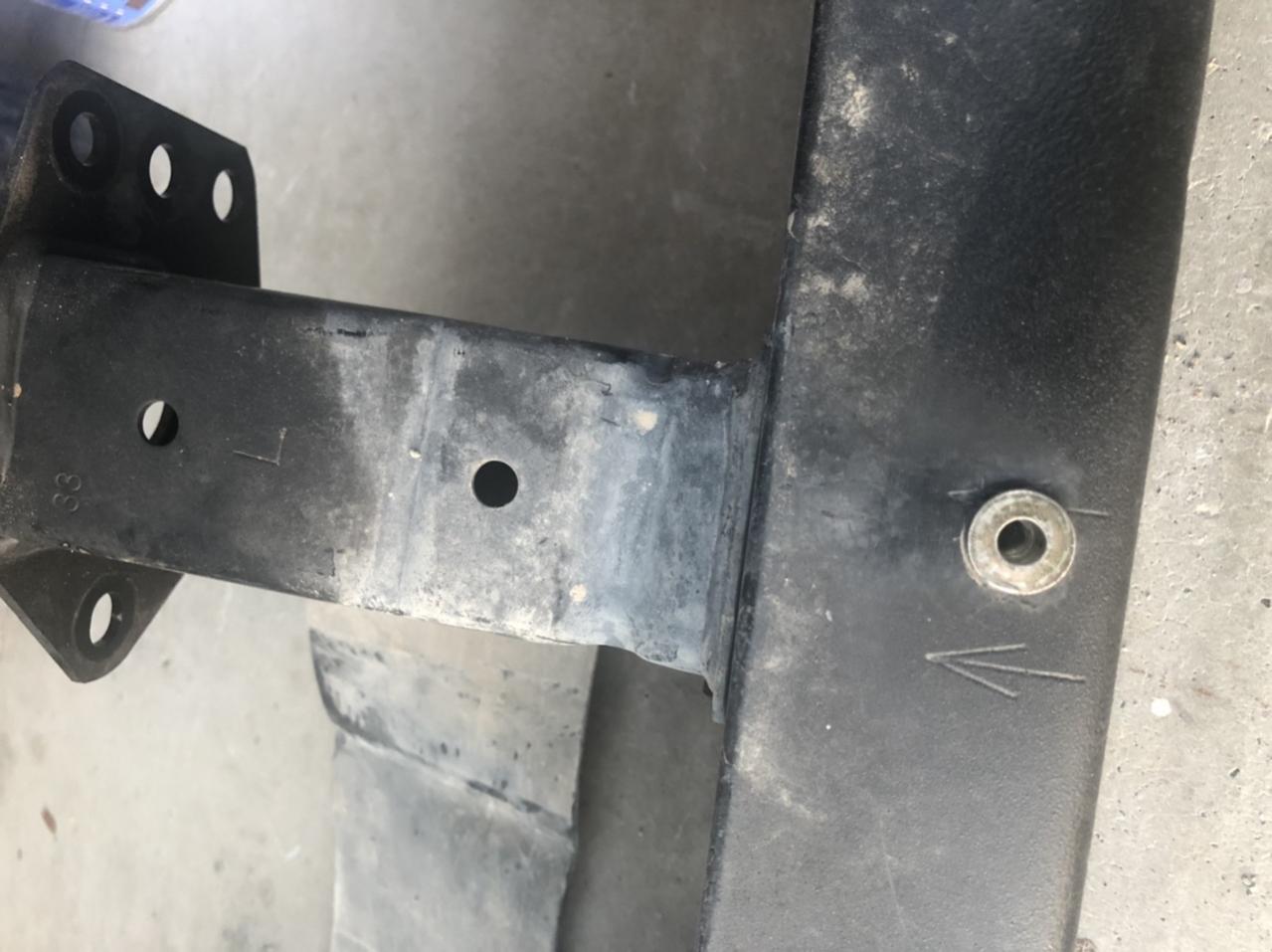

I used a right angle drill, a uni-bit and some rivnuts or nutserts or whatever you prefer to call them (shown in previous post #32)into the top of the crossmember. Pretty straightforward if you have access to this type of hardware.

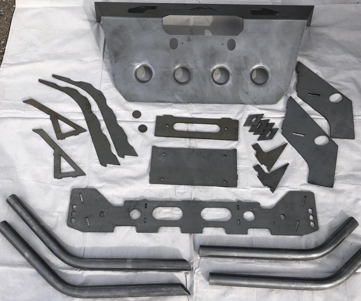

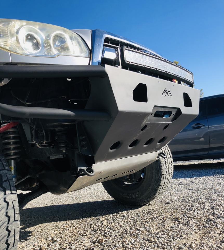

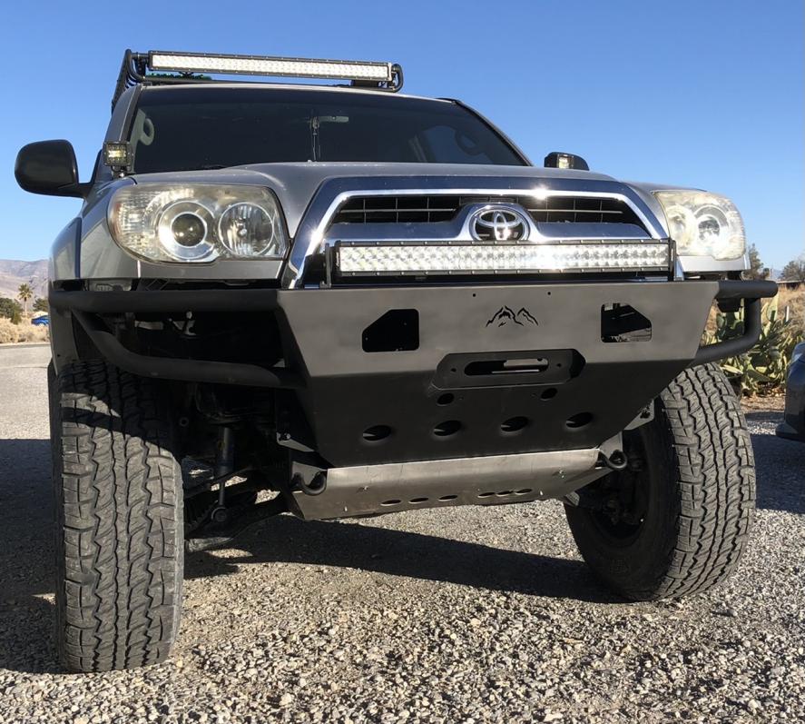

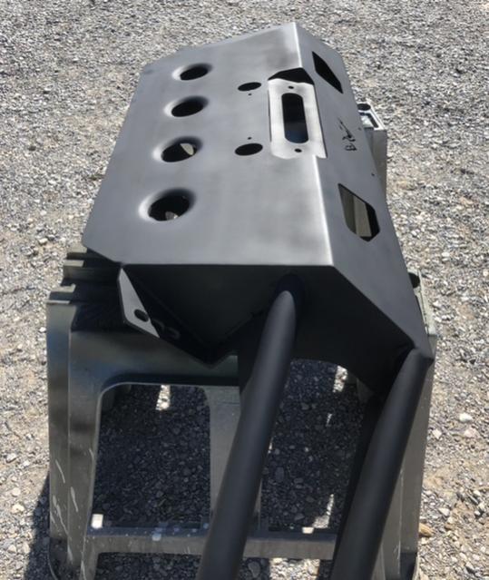

True North Fabrication DIY kit

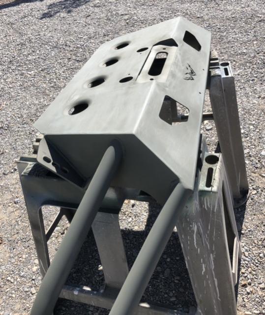

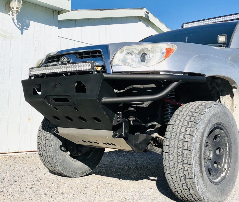

Started my True North bumper build.

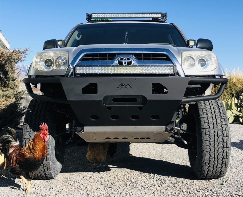

More angles.

Nice build! I especially like that True North bumper and definitely like their slim rear bumper!
On the cowl snorkel, might try spraying some dry graphite lube on it to quiet it down.
Thanks man, yeah I love how the bumper turned out. I do like the rear bumper kit they make but I’m gonna go in a different direction out back. Seeing the minimalist bumpers some of the other members on here have made lately has me inspired. Both [MENTION=83833]thegame7[/MENTION] and [MENTION=122249]originalg00kster[/MENTION] have built some awesome rear bumpers lately. I’m thinking something along those lines with a swing out similar to what @Porcupine82 had made. The wife informed me she wants her new kitchen before I get to do anything else besides maintenance to the T4R so it’ll be a while.

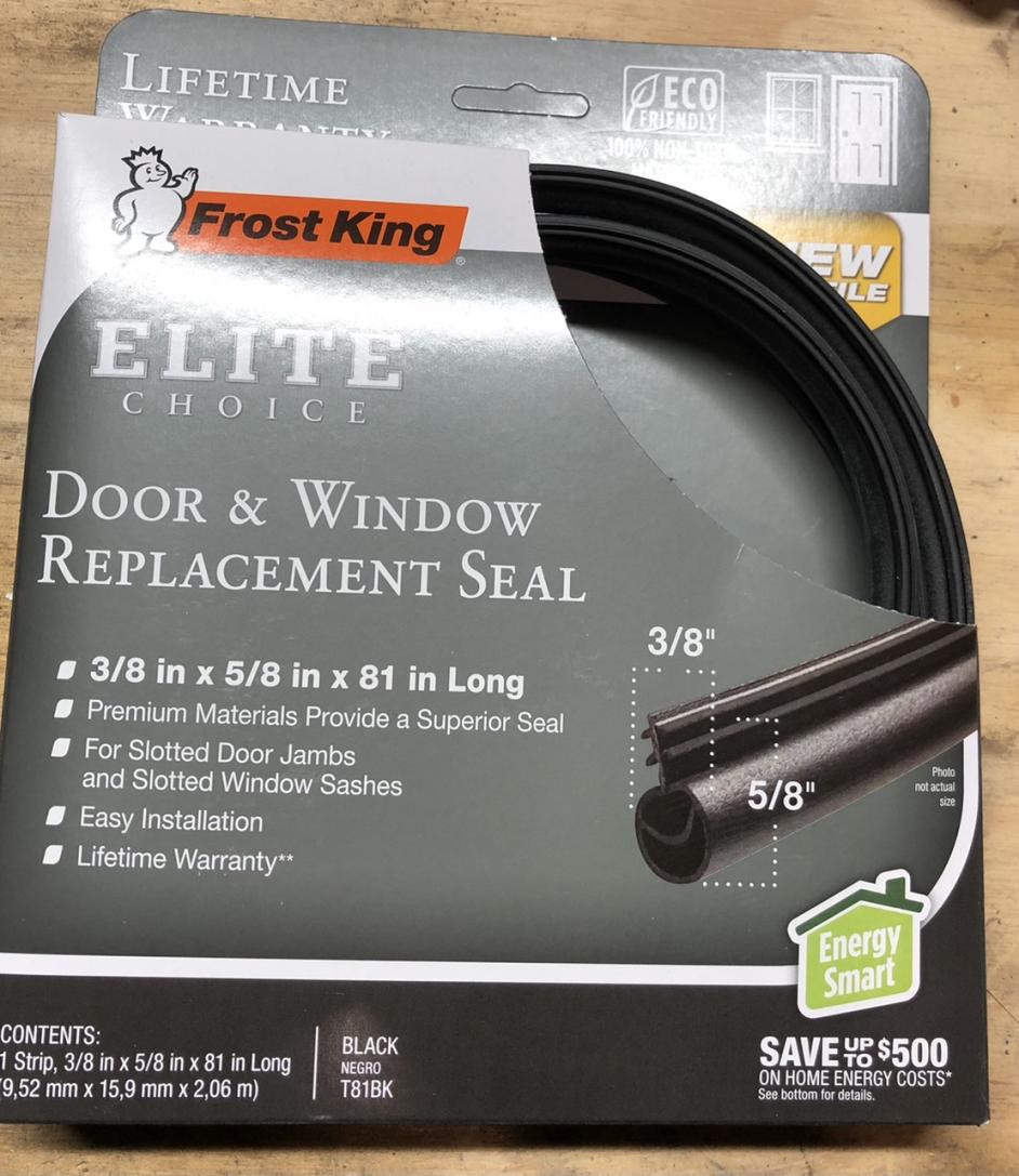

I’ll have to try some graphite for now but the real issue is that I’m a dumbass and used too large of a hole saw. Measure twice cut once as they say. If I can find a softer weatherstripping that’s thin enough to fill in the gap it’ll be ok.
I’ll have to check out those other bumpers. I prefer the minimalist but functional bumpers. I started building a Coastal WIY rear bumper but even without the tire and ladder swing outs, it’s very heavy. Decisions, decisions.
Found this weatherstripping at the Depot. It fills the gap that was left between the firewall and the pvc pipe I used for my intake. Yes, I cut the opening too large. Anyways this stuff holds tight due to ridges and is soft and pliable. No more squeaky intake on cold mornings.
use a heat gun to soften it up before you mold it into the hole. it'll help out a lot.
As soon as I replace my heat gun lol.
The stuff I used first was automotive door edge molding that had the adhesive in it. I got it warm with a Mapp gas torch and it molded ok. It just wasn’t thick enough to fill the gap.
The new weatherstripping is pliable and the barbs on the edge hold it nicely to the firewall. It’s a cheap temporary fix.

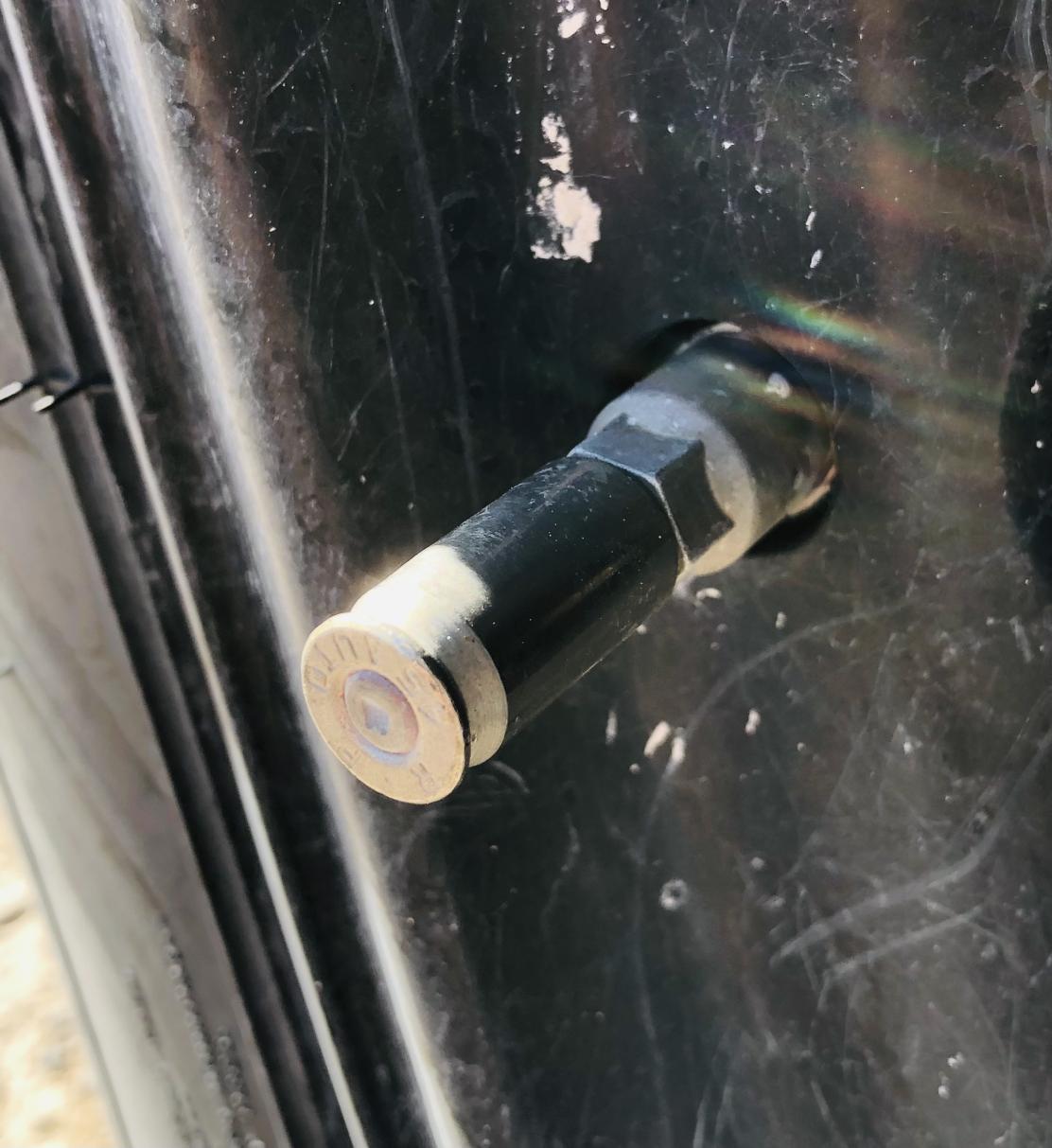

Made these a while back. Used 5minute epoxy to glue plastic valve stem caps into some spent .45 acp shells.
