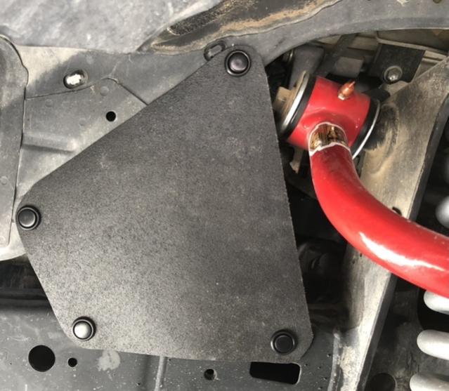

Splash guards
Made new splash guards out of rubber carpet runner from the Home Depot.
Mine had dry rotted and fallen off long ago.

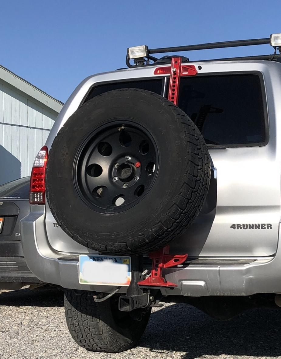

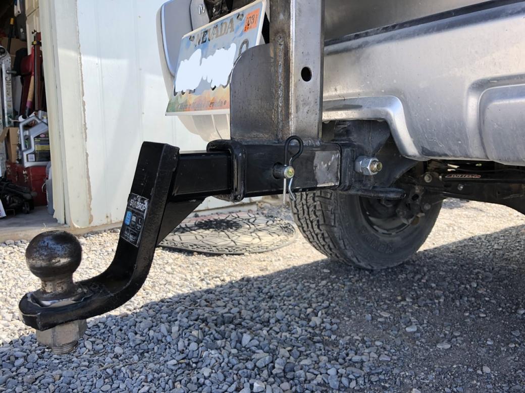

Tire carrier

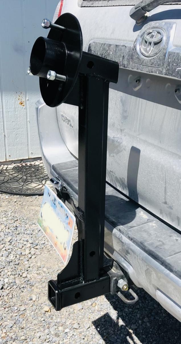

I set out to build a tire carrier that I could still tow with. I’m not worried about access into the rear hatch. The motor doesn’t work and isn’t a high priority.
I had most of this laying around. I used 2” square tube, a 2-1/2” hitch extension, 3/16 flat stock and a repurposed spare tire mount off my old trailer. I bought M12 1.5 lug nuts and bolts from O’reillys along with an LED lit license plate bracket.

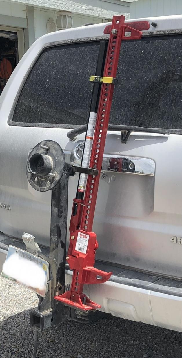

Spare tire carrier

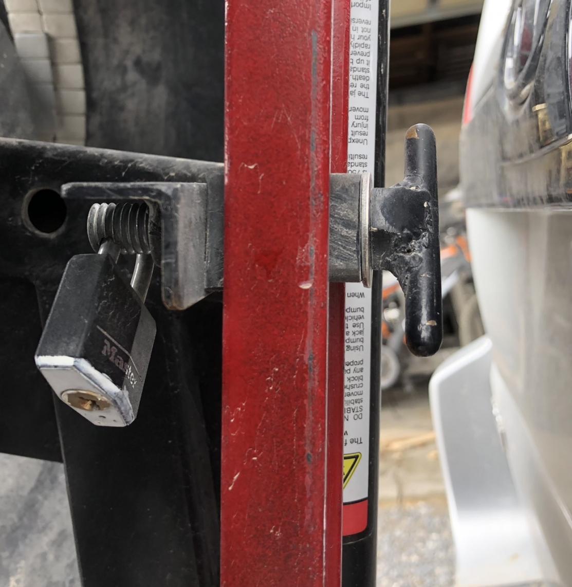

Later on I added brackets to mount my Hi-lift. I had another Hi-lift stolen off my 4Runner when I lived in Las Vegas. I’m rural now but don’t trust humans that much. Made two mounting points with locks. Cross drilling 1/2” bolts to fit small padlocks works well. I also used small pieces of leftover UHMW body lift materials to isolate the jack and keep it from rattling.

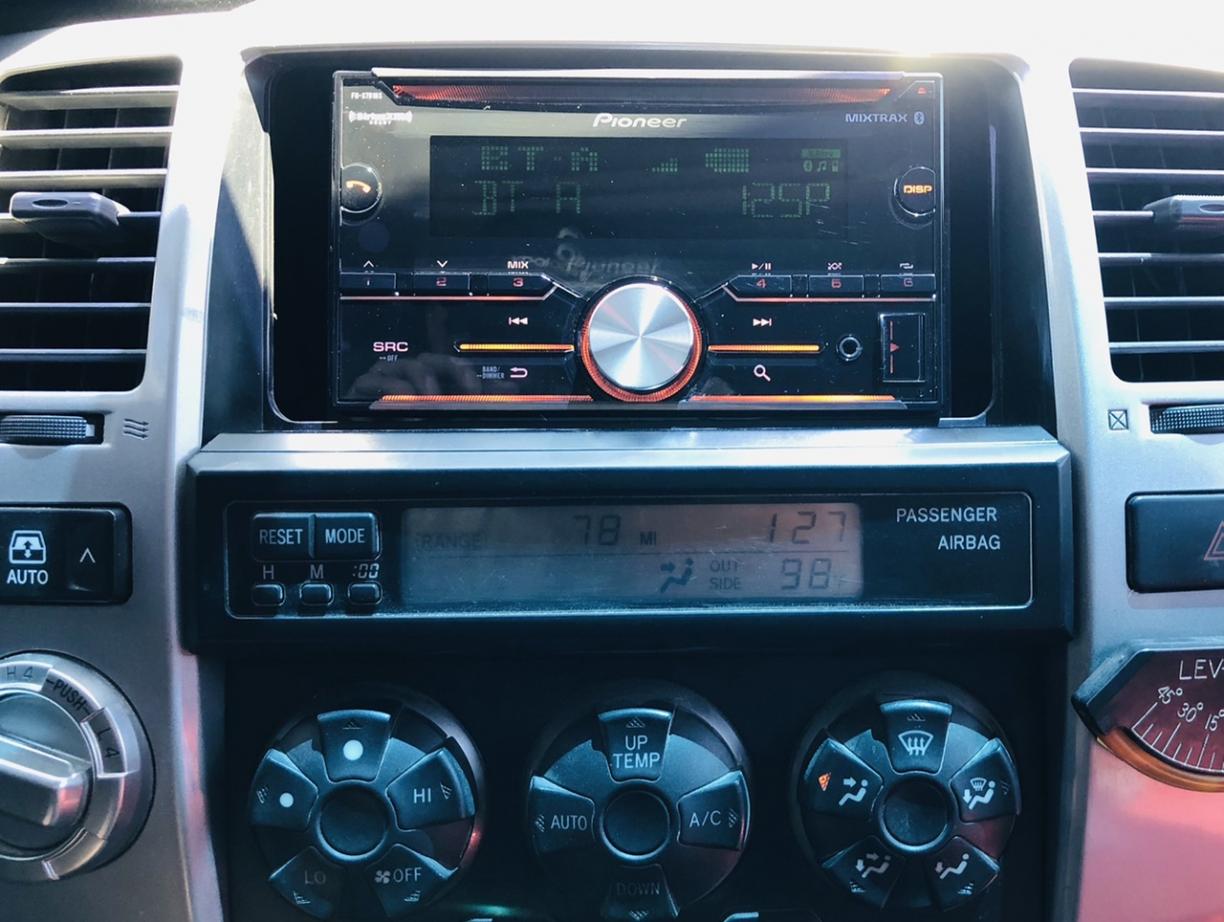

Head unit
Replaced the factory head unit with a Pioneer FH-S700BS. It’s a pretty basic unit that has bluetooth and a usb on the front. At the same time I installed Crux SWRTY-61S to retain steering wheel controls. This thing sucks and rarely works. Kind of a waste.

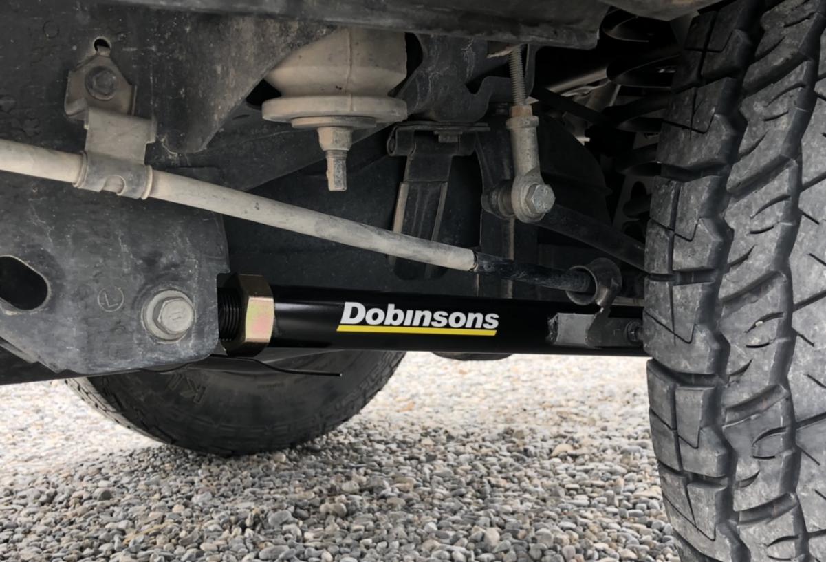

Dobinsons adjustable trailing arms
Replaced my lower trailing arms with adjustable from Dobinsons.

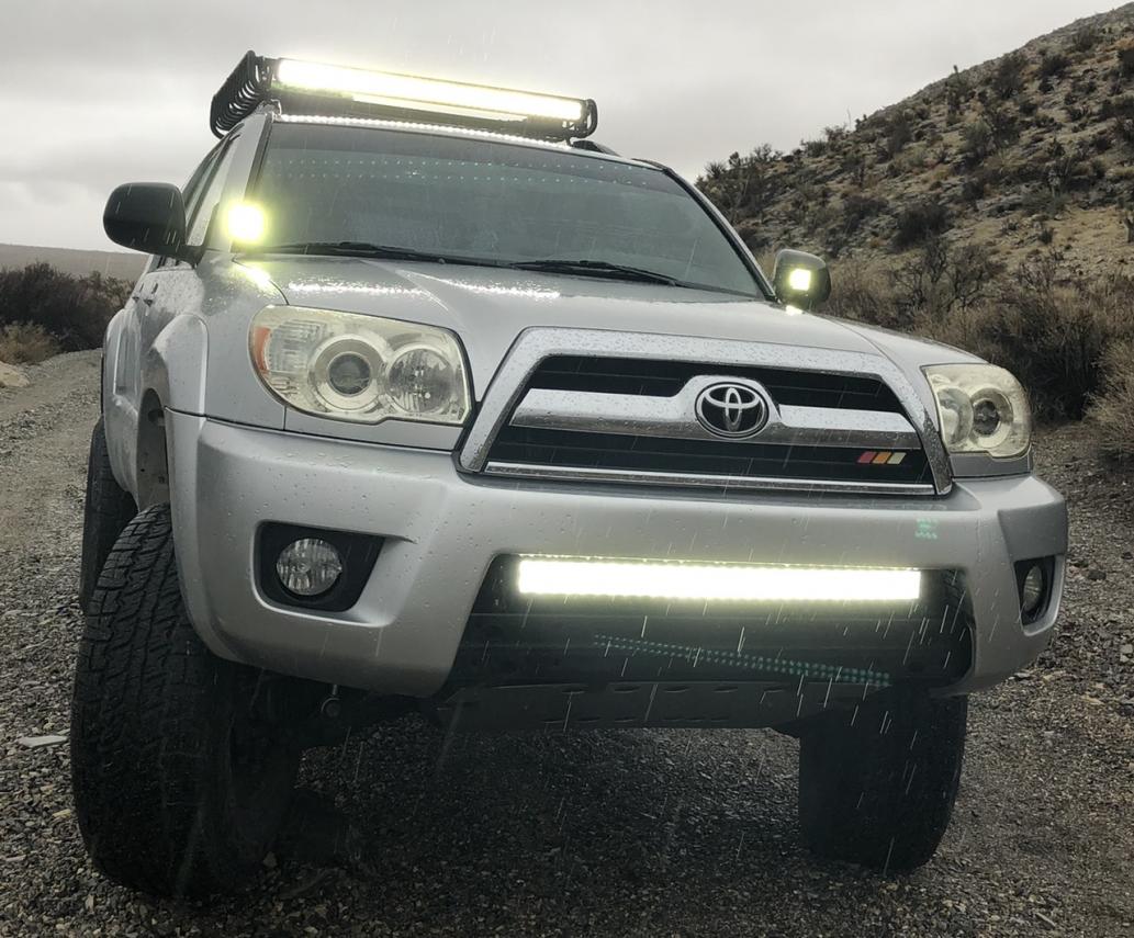

Lighting
The lighting has gone through a few changes.
Currently I have Auxbeam FT-1 H11 low beams, Auxbeam FT-1 9005 high beams and Sealight 3000k 9006 fog lights.
I’m researching new H11 low beams as I found out that these H11 LEDs are not legal according to NHTSA. Fog lights are going away once my bumper kit arrives.
I mounted a 32” curved light bar to the top of the crash bar in the lower grille opening.
I bought the 40” light bar new in box from my buddy for forty bucks. I made brackets to mount it to the roof rack.

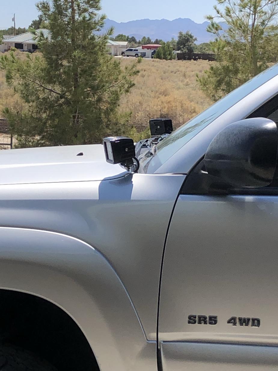

I bought these cheap GS Power ditch light brackets for a Tacoma off of Amazon along with some cheap Nilight light pods. The fit is decent.
Amazon.com: GS Power Engine Hood Hinge Ditch LED Mount Brackets for Auxiliary Offroad Pod Work Light. Fit Cowl Panel at Windshield Base Compatible with 2005-2015 Toyota Tacoma : Everything Else

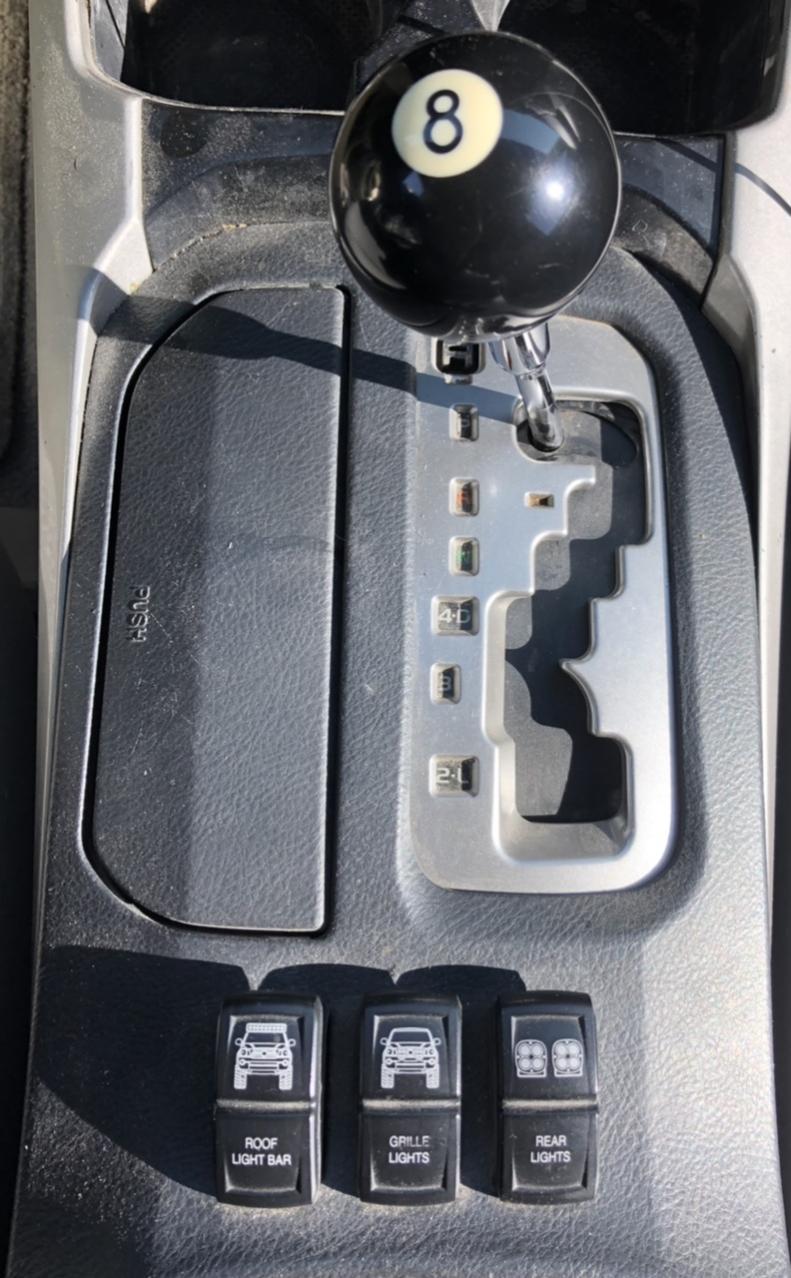

Shifter
Made this 8 ball shift knob several years ago. Drilled the center and found out it has a metal core. Tapped it match the thread pitch. Had a chrome faucet part that covered the narrowed section of the shift lever.

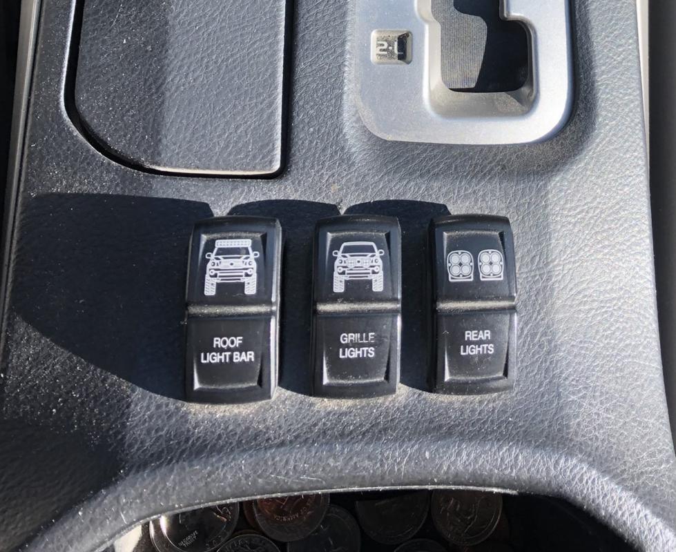

Lighting switches
Moved the DAC button I never used to the dash. Installed these OTTRATW switches in the center. They’re rocker switches and the fold out tray in the center touches the middle one. Will change them out to push button eventually.

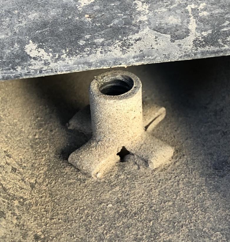

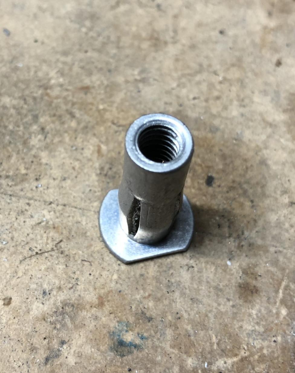

Hardware

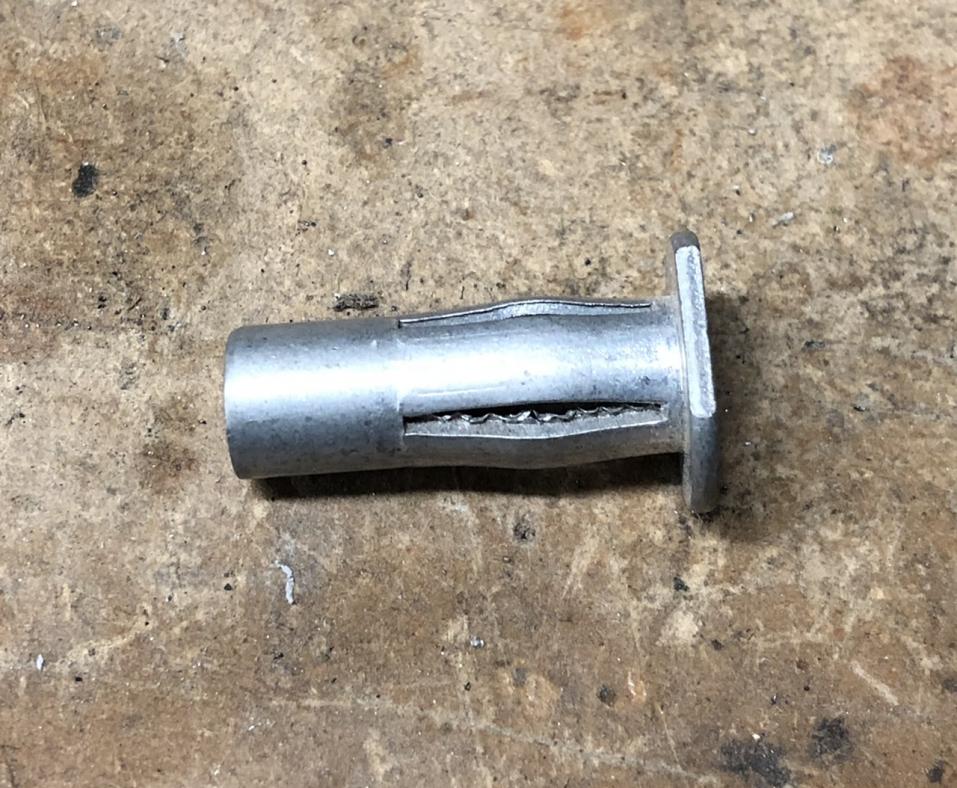

I got a bunch of spare hardware from work van shelf kits. I find these little nut inserts very useful. I drilled holes in the top of the crash bar and inserted these. Made a quick easy way to bolt in the light bar. They’re 1/4” sae. I’d like to get a rivnut tool with metric hardware.

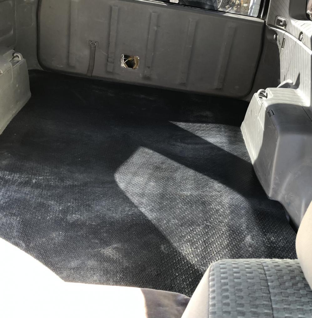

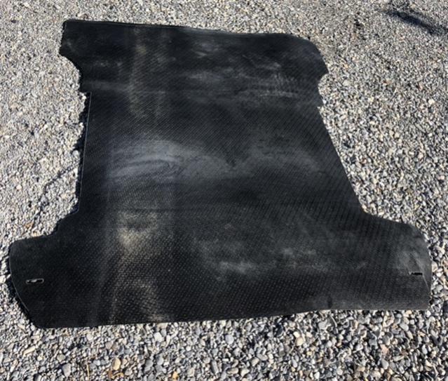

Cargo liner
Made a cargo liner from 40 mil HDPE plastic I got from my boss. This was one of 14 layers used to line haz waste landfills. Light and flexible. Wanted something to cover the entire cargo area and seat backs when they’re folded forward, which they usually are.

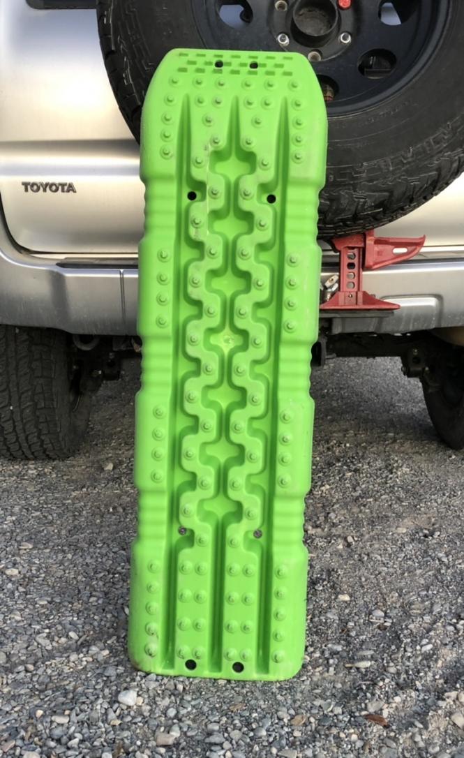

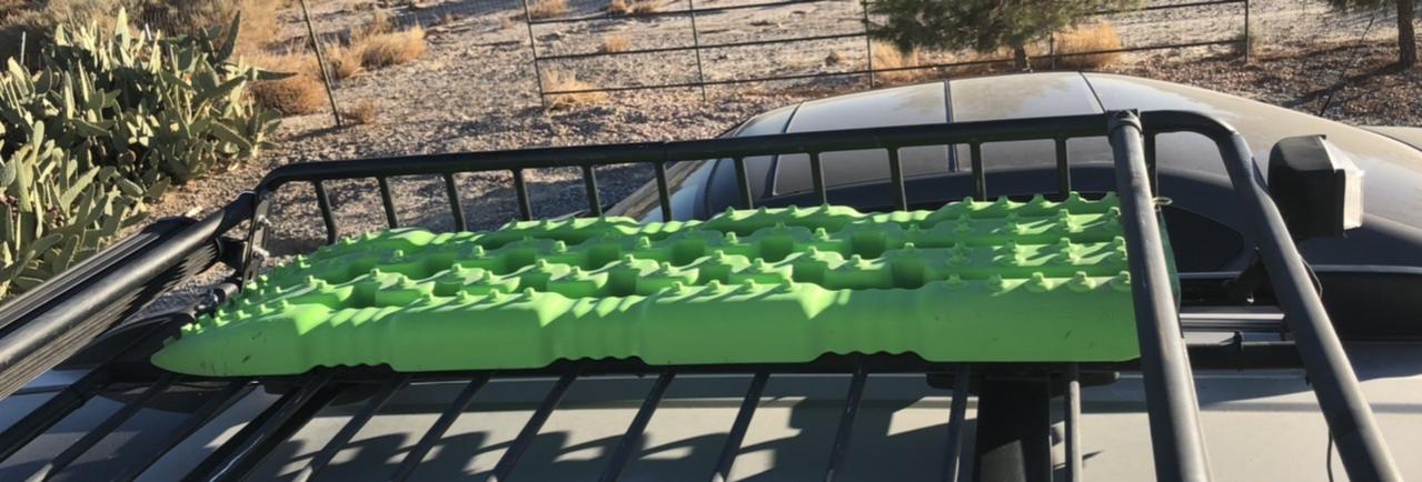

Tred board
Finders keepers loser weepers. Found this Tred board on the side of the highway. Made some brackets to mount it to the roof rack. I like to use firearm cable locks for tools and shovels. Worked good on this so I don’t regift it.

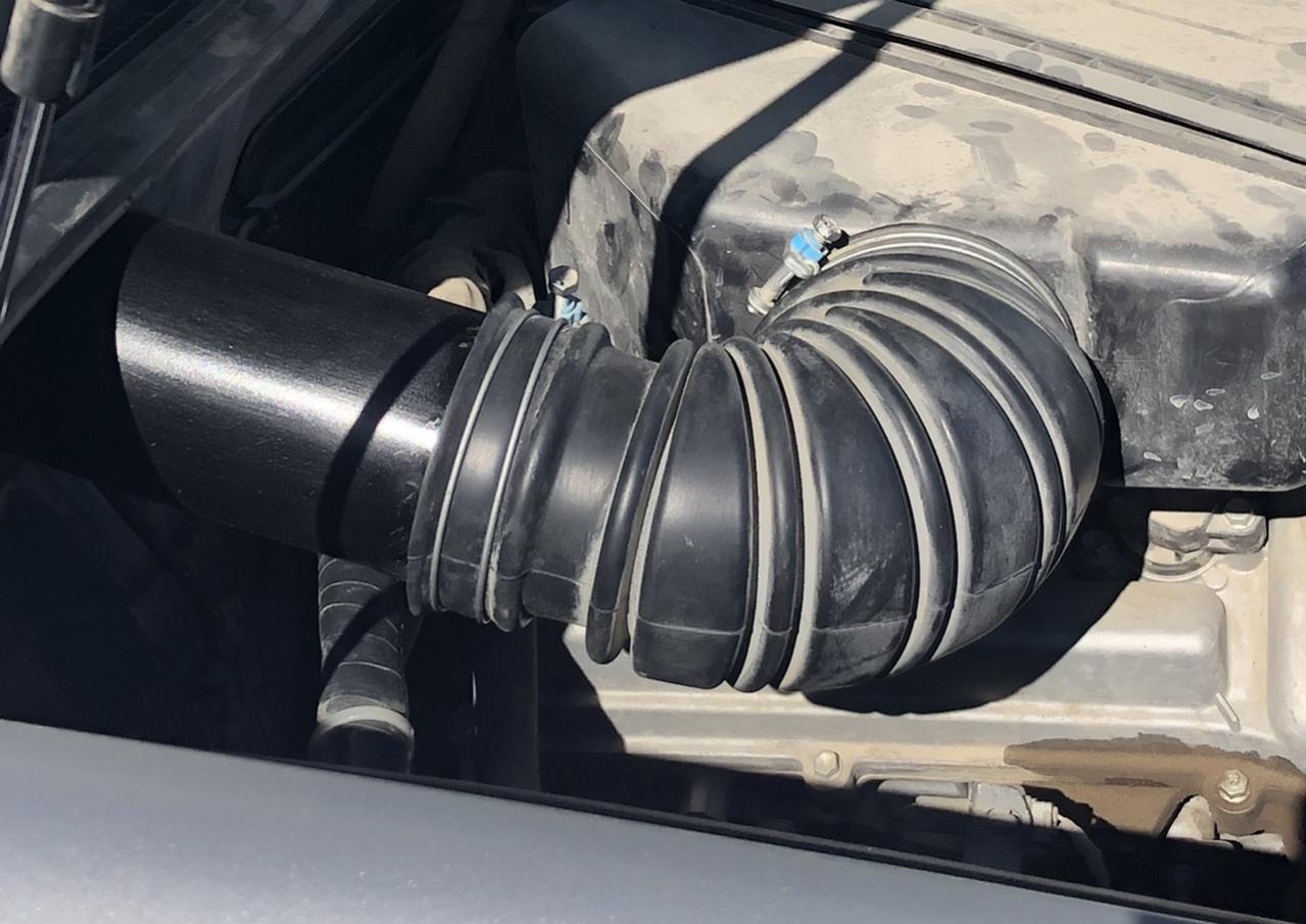

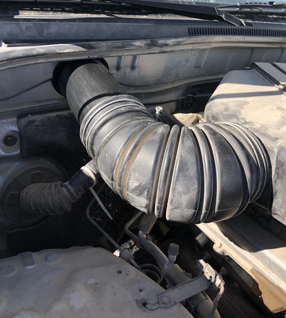

Cowl “snorkel” intake
Not really sure why I pulled the trigger on doing this mod. If anything it makes room for a second battery and on board air. Kind of regret it but oh well. Heard about the cowl “snorkel” intake mod that Tacoma guys had done as well as some 4Runner owners.
Used some 3” schedule 40 pvc pipe and my factory intake tube which I cut. Cut the firewall using a hole saw. Had some old door edge molding that I used around the cut, it’s very squeaky.

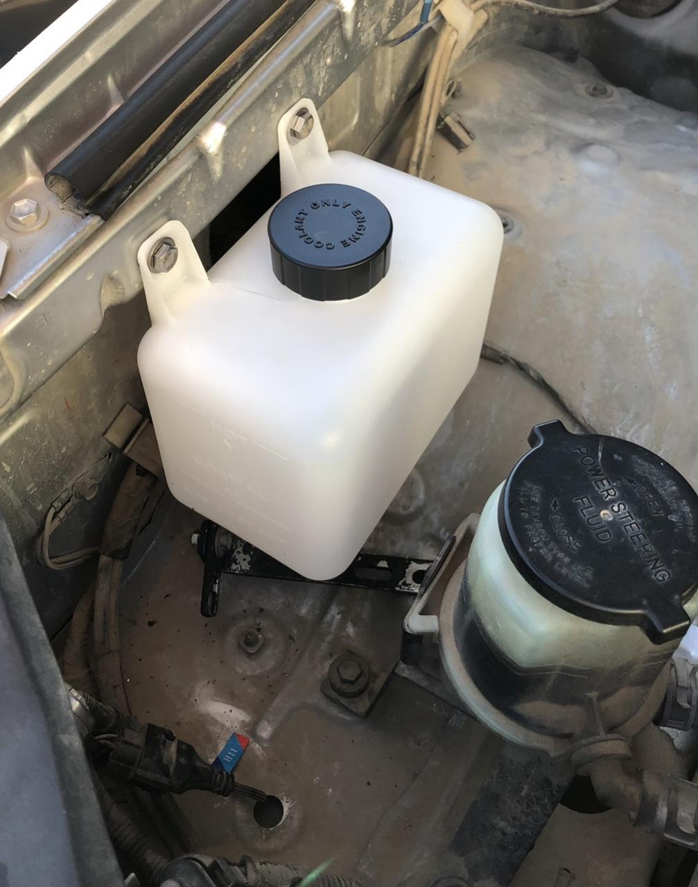

Washer fluid relocate
Washer fluid relocate mock-up. Getting ready to move the washer reservoir once my bumper gets built.
