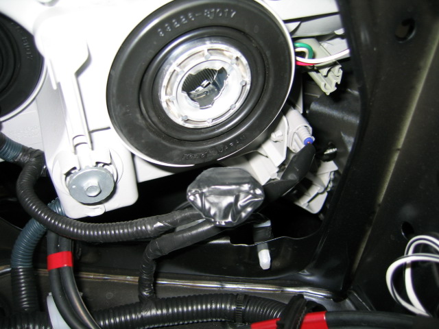

Now disconnect the harness connector from the bulb on the passenger side headlight. Since this connector will not be used to connect to the XenonDepot harness, you can seal it with electrical tape to protect it and keep moisture out. After that is done, go ahead and remove both of the H11 halogen bulbs from the headlight housings by twisting them counter-clockwise.
When I install my kit, I do not have this connector open, it is connected to the hid kits. When I was installing my kit I was using your instructions and I was scratching my head on how you have an open connector and that I do not.
As for the aming mine seem to line up perfectly, so I do not have to make adjustment. These headlight are awesome so damn bright. I'm loving it.
The factory connector on the driver side should be the only one connected to the HID harness. This one is only used for triggering the system on and off, not for sending power to any bulbs (since the factory bulbs are gone). The HID kit has wires crossing from the driver side over to the passenger side and those handle everything for the pass. headlight. The factory connector on that side should be hanging free and unconnected to anything.
is it bad if i have both connected? a friend of mine have pretty good knowledge on electrical stuff he said it's ok. maybe its just a user perference?
1MZ-V8,
The connector T4Runner06 is referring to, is the stock passenger headlight plug that goes to the halogen bulb (which he has taped up). I'm not sure if Xenon Depot has changed their wiring harness kit, but the kit I got and most likely T4Runner06's only has three plugs/sockets total. Two will go to the HID ballasts and one is from the factory headlight wiring. If they changed their wiring harness kit, then maybe it will allow both sides of the headlight to be plugged in. But as T4Runner06 said, it wouldn't matter or hurt anything, because the factory headlight wiring is only used to trigger the HIDs via the relay. The hookup to the battery (fused postive) and ground wire provide the power.
Hope this helps.
