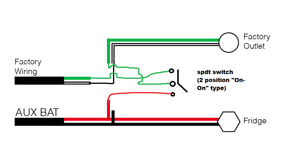

I've installed a loom to run from an aux battery straight to the fridge in the back. I thought it would be nice to have the ability to use the other 12V outlet with or without the car running, maybe through a simple switch to select between the existing wiring and the new wires to the aux battery.
I'm not much of an electrical genius and have poured through some other threads, can't seem to wrap my head around this one. I have seen Antmans 12V mod up front, but I was hoping to use the AUX battery for the always on.
Here is a diagram, sorry it looks like a 3yr old drew it. I'll add some photos when I put it all together, if it works out.

Before you start, please double check with a multimeter, but I am pretty sure the white wire is constant ground at the factory outlet and the green is the switched +12v.
Basically what you want to do is cut the green wire and connect the outlet end of the green wire to the common terminal of an SPDT switch; connect the harness end of the green wire to one of the switched poles; and tap into the +12v of the fridge wiring and connect it to the remaining switched pole. Since the factory outlet already has a constant ground, you won't need to tap the ground from the fridge wiring. I don't know what gauge wires you have running back from the aux battery and how your fuse situation is along the route, but it would not hurt to throw an inline fuse between the SPDT switch and the aux +12v connection--you don't want to burn up the factory outlet...
I recommend a 2 position
("ON-ON") SPDT switch for this because logically speaking you would probably only want to select one or the other, and not completely off? This link to the schematics of the switch I am talking about might help you visualize it better:
http://www.delcity.net/images/linedrawings/7700018.pdf
If you wanted to be able to completely switch the factory outlet off indefinitely, just find a 3 position SPDT switch and flip it to the middle. For example like this one:
http://www.delcity.net/images/linedrawings/7700028.pdf

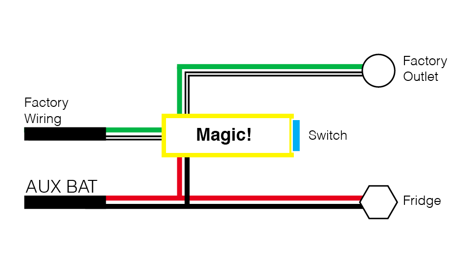

Here is your diagram, converted from something that looks like a 3 yr old drew, to something that a 1 yr old drew :)

Awesome, thanks for the input. This looks like what I had imagined, a simple on/on switch to select one or the other. The diagram lines up with what I read earlier from the 12v mod upfront. I did test the lines and you are correct about the green/white lines.
I'm running 10 gauge wire with a 15amp inline fuse at the battery, it is the wiring loom from ARB for their fridge. My concern now is splicing the positive line from the aux battery, Is this ok with no protection between the two outlets? If the fridge is plugged in and I'm using a device plugged into the other outlet, if they could potentially damgage each other.
I'm not exactly fluent in electricity so I want to make sure I don't miss any gotchas before I send power down the line.

I think the factory cigarette sockets are fused at 15A, so technically I guess you can just tap the +12V from the fridge harness straight to the SPDT switch and not risk burning anything without an additional inline fuse, and assuming you used thick enough wire (~16-18AWG). But let's put it this way, it will definitely not hurt anything if you threw in an inline fuse at the tap, and put in a slightly lower amp fuse.
As far as interference between the fridge and the cigarette socket mod, you should not experience any issues that can cause permanent damage. At best if you drew too much power at the socket and the fridge at the time time, the 15A fuse by the aux battery would blow.
Personally though I would go with Harper's suggestion and just get it over with all at once and run a fuse block setup back there; and then distribute the power as you please. This way you can neatly add to it in the future.
