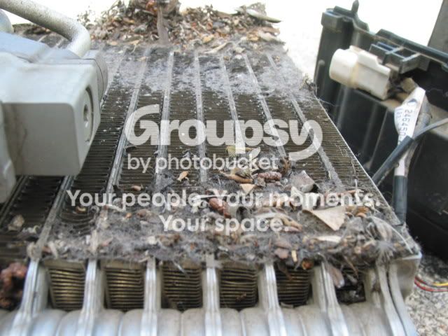

96 286,423 miles and a/c works great....I did have to replace the expansion valve at 223,500 miles and also the receiver drier since I had to crack the system open for the ev. Cleaned the evaporator core cause already in there for the ev replace.
