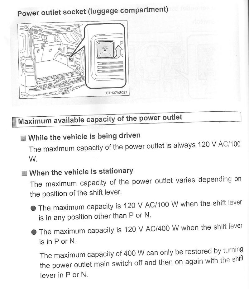

Power
Copied from my Owner's Manual for a 2013 TE. Prior page shows console power the same as the rear power outlet - 100/ 400w.
Looks like 400 at idle in park or N and only 100 when running. I would have expected to get 400w when running down the highway. Photo follows:

Here are the specs right outta the manual...
Maximum available capacity of the power outlet
■ While the vehicle is being driven
The maximum capacity of the power outlet is always 120 V AC/100W.
■ When the vehicle is stationary
The maximum capacity of the power outlet varies depending on
the position of the shift lever.
● The maximum capacity is 120 V AC/100 W when the shift lever
is in any position other than P or N.
● The maximum capacity is 120 V AC/400 W when the shift lever
is in P or N.
The maximum capacity of 400 W can only be restored by turning
the power outlet main switch off and then on again with the shift
lever in P or N.

Looks like if you were to try and draw 500w, the protective circuit in the inverter would shut it off.
I know, what good is 400watts?
