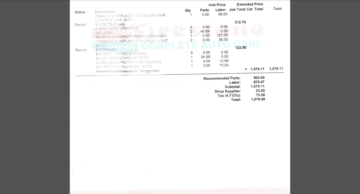

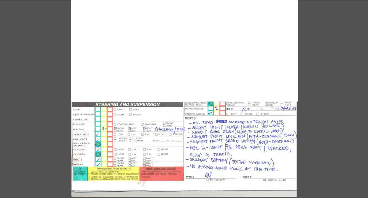

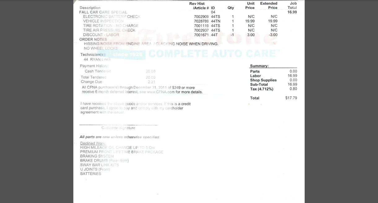

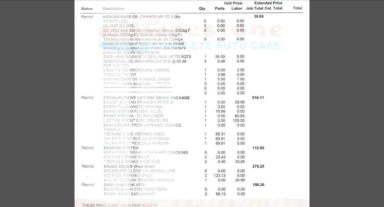

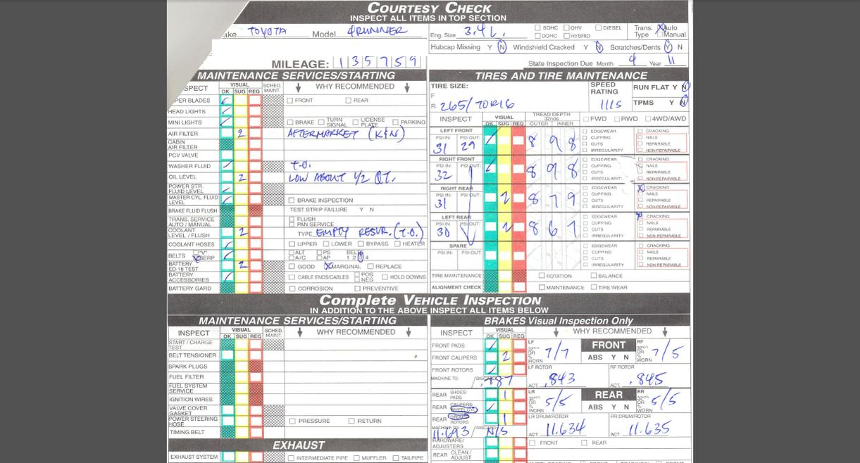

Ok, I have scanned the repair sheets that the repair shop gave me. This sheets list everything that the repair states is wrong with my 1998 Toyota 4Runner Limited:

You may need a press for the Ujoints, but try greasing them first. That said, no one has been able to agree 100% on the type of grease being used.
Turn the drums, don't buy new ones. Everything else can be done without too much effort.
Get a set price on the labor before he picks up a wrench. For Hawaii, $35/hr. Maybe $40.
I'd be getting second and third opinions before you go buying things. Go to your next shop and ask them whats wrong with it... DO NOT mention anything that you may think is wrong with it, or anything that the previous shop mentioned.
- If you end up with multiple shops wanting to do the same repairs, something is broken/breaking.
-If the second shops just asks you for $150(overpriced, I know, right?) to change your brake pads.. hah.. You know that the first one is trying to rip you off.
- REMEMBER: Shops/Dealerships WILL take advantage of anyone they find to be even a little clueless about automotive repairs.

Just about all of that stuff of that stuff can be done on your own with help from a buddy and you can get some parts from general auto stores or you could go all OEM. It will save alot on labor. Depending on age and how many miles, some of that stuff could be needed due to general maintenace and they could be taking you for a ride with other stuff. By doing it on your own you could probably save $800 and possibly use better quality parts and fluids.
According to that, the ONLY thing I would pay for would be the U-joints.. and even those are doable DIY.
1) Oil Change - $30 in your back yard.
2) Brakes - If your Rotors are > 30,000 miles.. Replace them. I believe stock replacements are ~$70 from your local Autozone.
Pads: If they aren't over 1/4" thick, replace them. Toyota 4runner Brake Pad - Auto Parts Warehouse
3) Brake lines - I'd get a second opinion, I've never heard of them going bad.. but I doubt it's something ANYONE would want to let go.
4) Rear Drums - Unless they're stock and over 150k miles.. get them "Turned" you use roughly 10%-15% of your rear brakes at any time.... (Besides the parking brake, which I doubt you need in Hawaii)
5) Sway bar Link kit - $198? LOL. Do a search on this site, I believe the going rate right now for the washers + bushings is around $20.. and takes 5 minutes to change out each side.
6) Stabilizer bar - Remove and replace? Wtf for? to F up your alignment so you come back to the shop? Maybe someone else can comment on this...
7) U-Joints - 98 1998 Toyota 4Runner U Joints - Driveline and Axles | Drivewire.com Please, someone else comment, I've never needed to replaced this.
8) Battery - You can have it checked at any Auto parts store for free.. Do this before you replace it.. even a brand new stock replacement battery will NOT cost you $122. And the auto parts store will install it free of charge 95% of the time.
