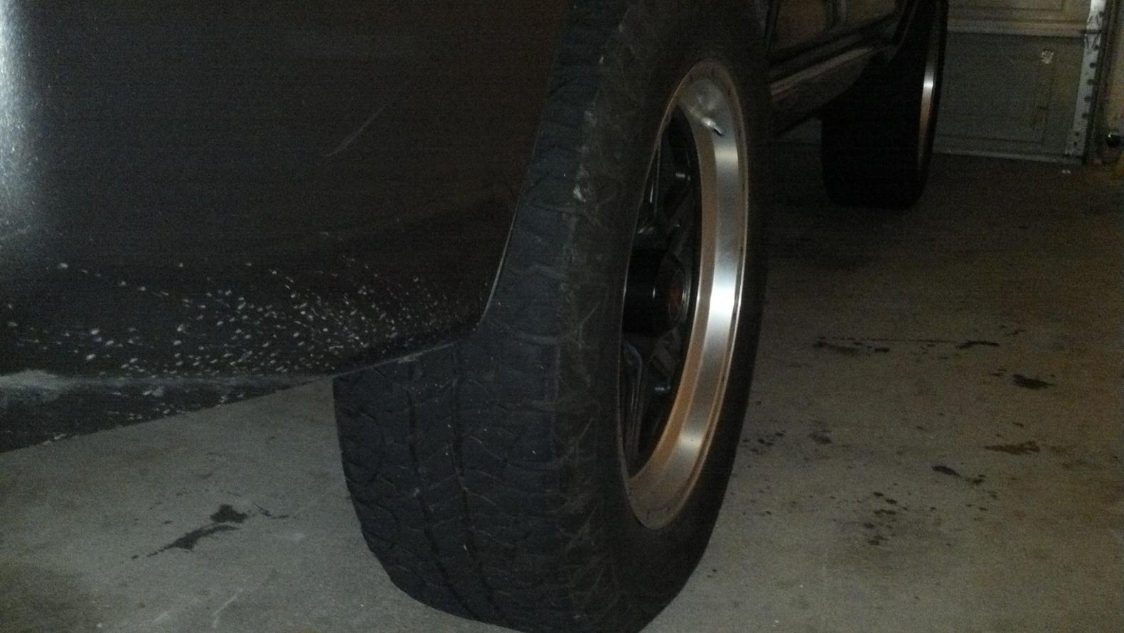

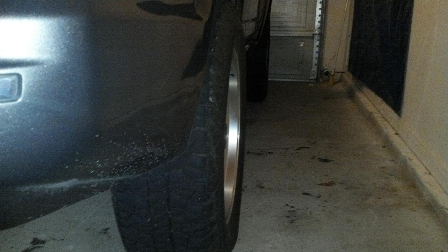

I will have pics of a 9" -12 setup soon. Since you are lifted you may want to go with wheel specs that are much more aggressive, like i posted above, as my specs will fit under the stock fenders sans lift.
the specs are in the original post
