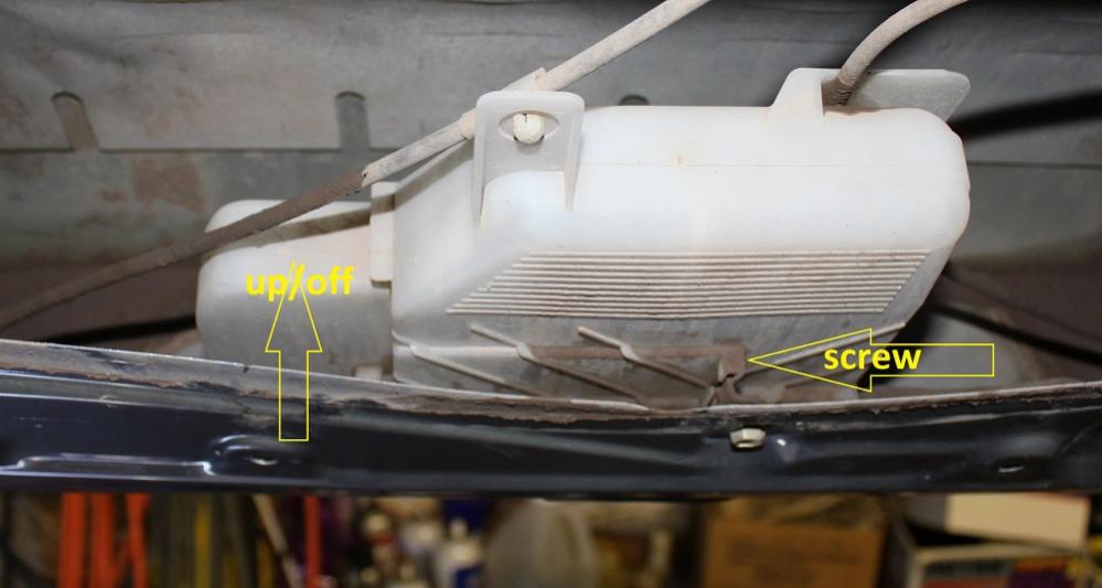

The white cover has 1 philips head screw holding it on, then pull straight up, hard... pics added for clarity.
The left side just pulls straight up and off to expose the levers.

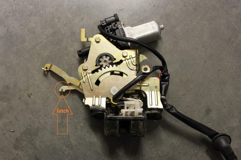

The smaller lower lever is the latch release.
The upper lever seems to go down and in when the door lock pulls itself in and latches...electrically.

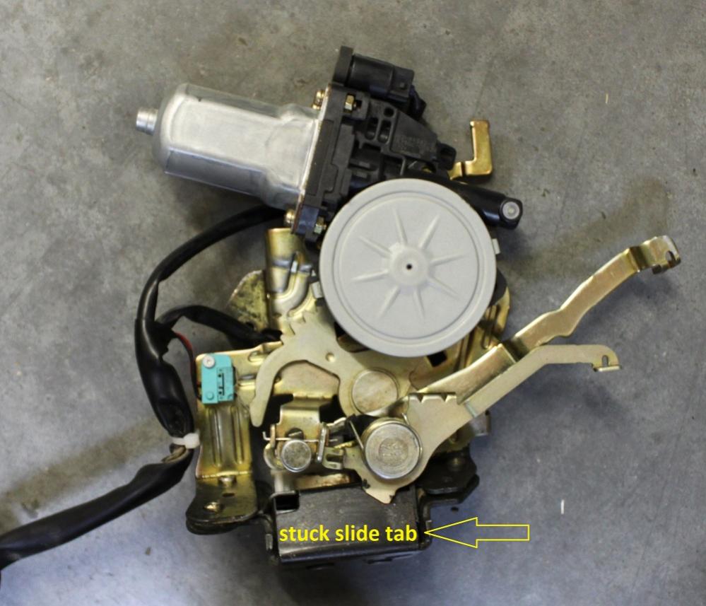

When i had mine apart it was mostly failed due to part of the latch that stuck.

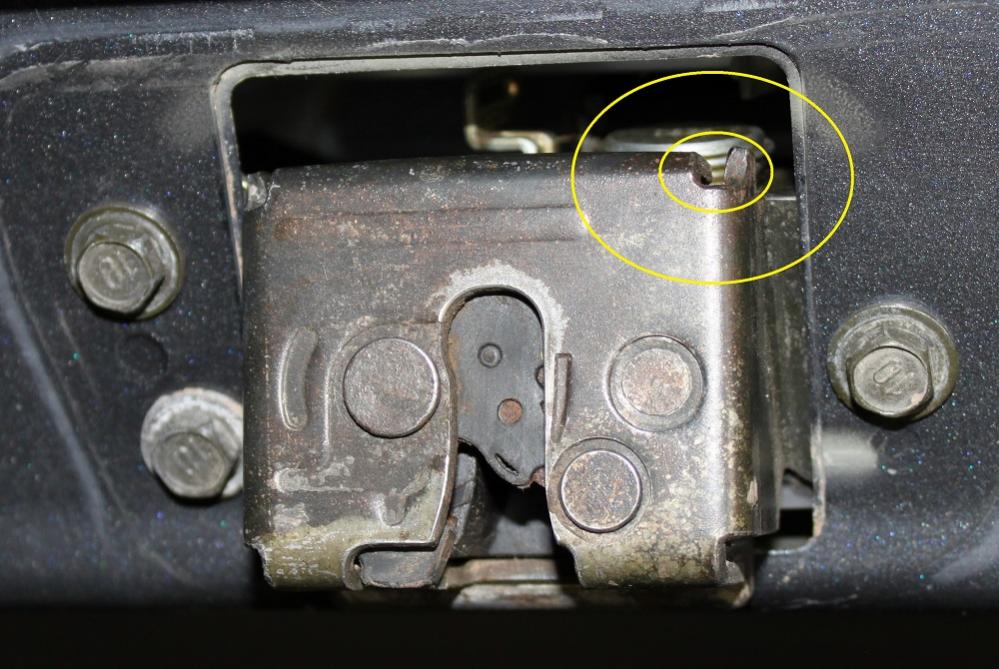

It is a small metal sliding tab, part of the latch... in double yellow circle, pic.
Hard to see or really get at. Cant see it in pics because it is internal to the latch.
If you could poke around in the passenger side of the latch, behind the unit and rear door outer shell, like a small straight pick like tool... might be able to free up the stuck slide tab part of the lock...maybe.

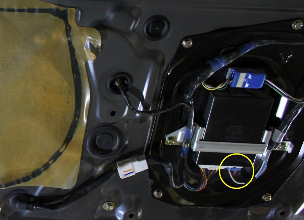

Rear MPX door unit, unplug bottom right power plug, 10 count, plug back in and 2x door unlock on the key fob to reactivate the rear door switch.
