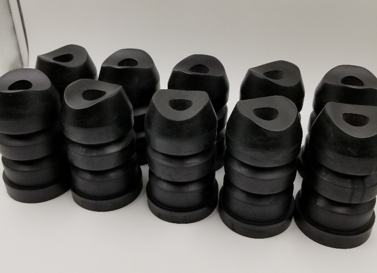

I have the rear bump stops built for you guys that ordered a set from me. Here is a pic of them complete.
Unfortunately, My stupid mounting hardware ended up being a special order from my local Copper State. So I'm a late shipper. :wtf:
So everyone's order will be shipping out this coming Tuesday 5/15. :sorry:
No excuses, but I've been so damn busy with work this entire week has blown by. I should have had the hardware in hand sooner!

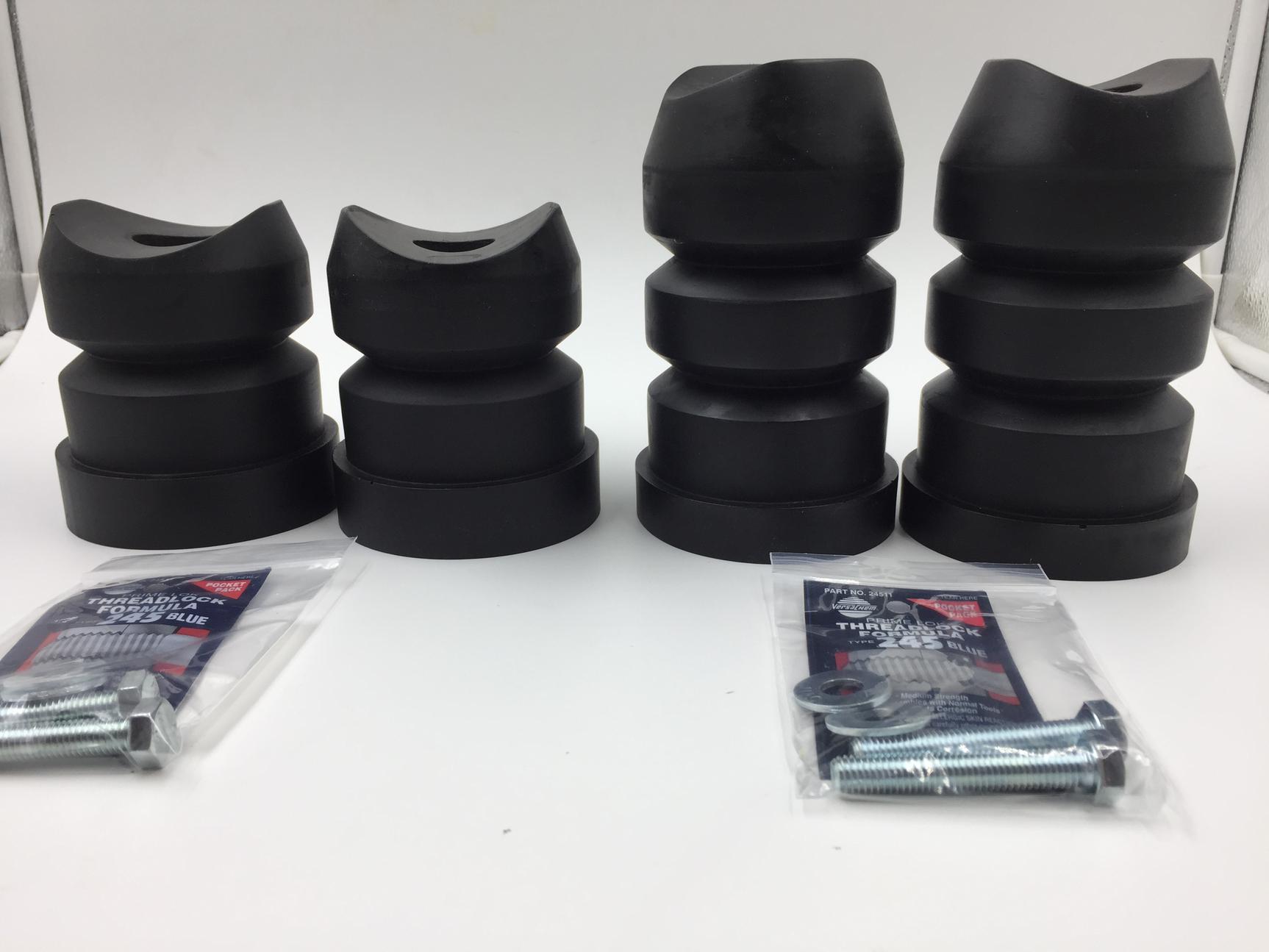

Here is a pic of the latest version of my 3.5" and 5.25" rear bump stops.
Each version has a cast in place 1.5" washer to prevent separation and are each made using two different durometer rubbers.
Pretty sure I'm the only dual durometer rubber bump stop on the block... I know at least on my block for sure! :bump:
No hard contact/bump like when using the factory bump stops with spacers.

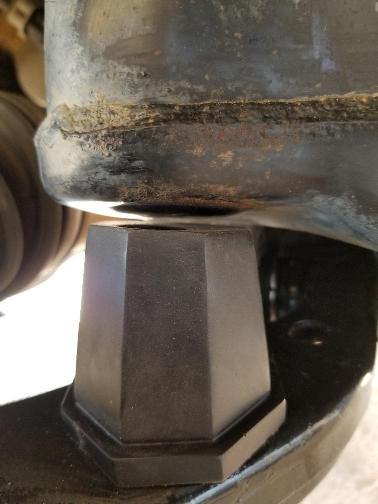

I just received the rear bumps in the mail today. They where delivered in 2 days. They where packed very well in the perfect size box. Not that you can really hurt bump stops but it shows some pride in work to make sure even something as simple as boxing is done right.
In the package where 2 bumps, 2 washers, 2 bolts, and a one use package of blue loctite. The loctite was another really nice touch.
Here's the goods:
Here's a side by side of my custom mount for my old Daystar bumps. You'll notice my old set-up is about an inch longer then the new bumps. The Daystars are really soft for the first 1/2 of travel so I needed that to help with cushioning coming off rocks hard. The new bumps are noticeably firmer.
The install was about as simple as it gets. It honestly took me more time to get my old bumps off then get the new ones on. Here's the bumps installed on my rig.
I'm still in the middle of my damn diff break in period so it'll be another week before I can really beat the shit out of these things. I'm confident that they will be an upgrade to my old bumps. I'll keep this updated after they get some hard wheeling under them. Initial impressions are hugely positive though.

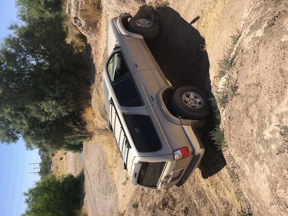

Plastics guy and I went out and tested the snot out of these bumpstops, trying to break them. I can say they are super duper heavy duty. Also plastics guy is an awesome person, I'm glad I got to go out wheeling with him. This dude is about his business.
The other side is stuffed hard, at one point the shock was the only thing limiting travel. I hope he posts his shots of the bumpstops at full flex.
