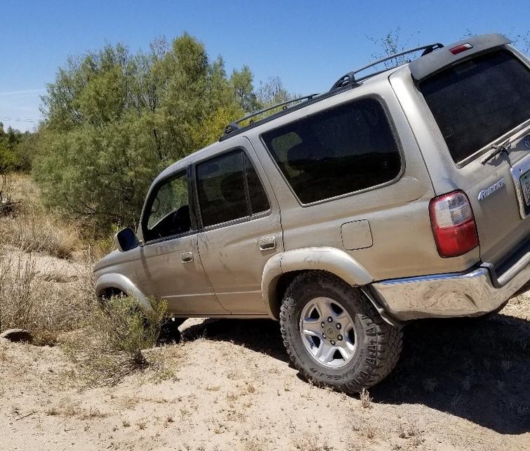

Went out with [MENTION=84129]97t4r81[/MENTION] today strolling down the Santa Cruz River right through Tucson! It was kind of crazy to have traveled so far into town all while following the river banks.

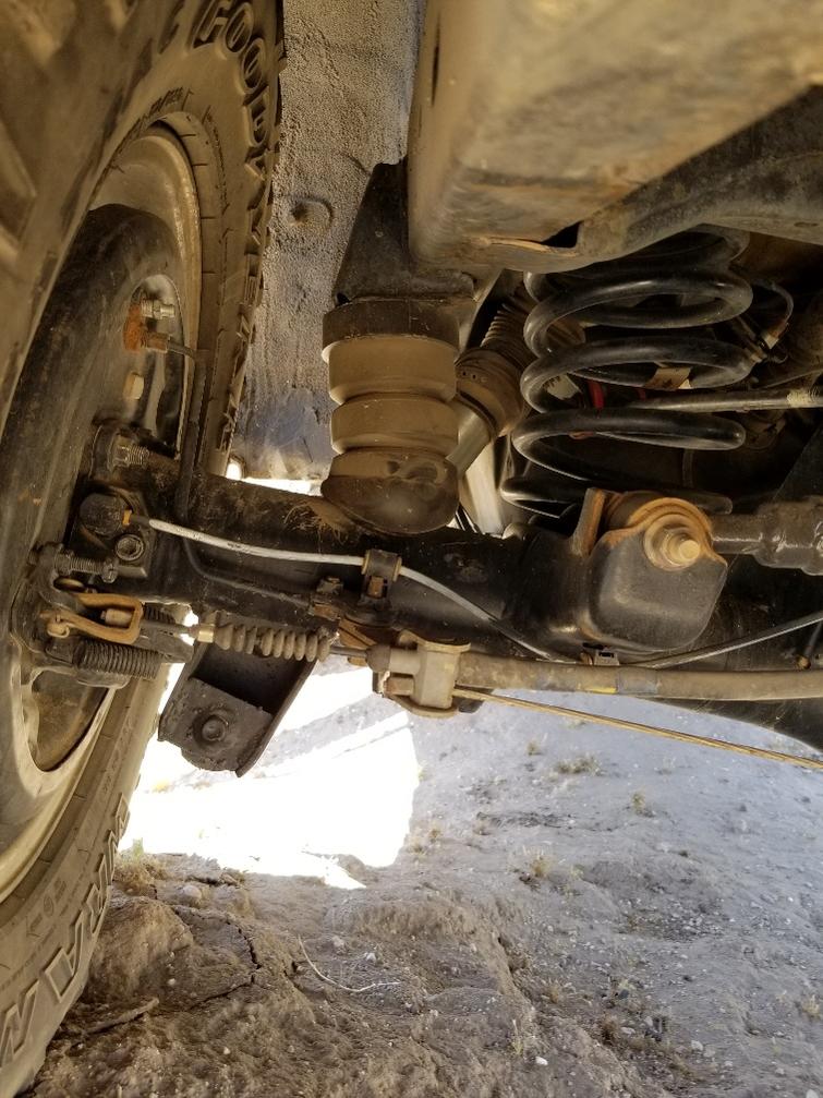

Here's some more Bump Stop Porn to look at. I have been running this same set very hard, Tons of 3 wheel action. in the pics you can see how the bump stop looks like while the weight of the truck is fully being supported by my bump stop.
[MENTION=118730]AssBurns[/MENTION] had asked about how much compression am I getting. I had time to get the measurements today. The length uncompressed is 5.25". Fully flexed and with all the weight over the bump stop, it measures 4". So it looks like 1.25" in compression.

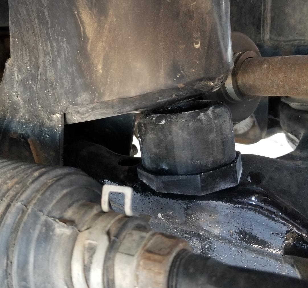

I finally have the front bump stops worked out. I was working on getting my bump stops as short as possible with them still being effective of coarse.
I have tested these as much as I can. I am very happy with how they came out.
I am ready to send out some Beta sets to be further tested.
Who's in?? $50 plus shipping
In the pic this pic the bump stop is just making contact. The front OEM bump stop still has a 1/2" gap until it will contact. With about an additional 1/2" compression the OEM bump contacts and both bump stops (my aftermarket and the OEM) start working together for the remaining 3/4" of up stroke.
