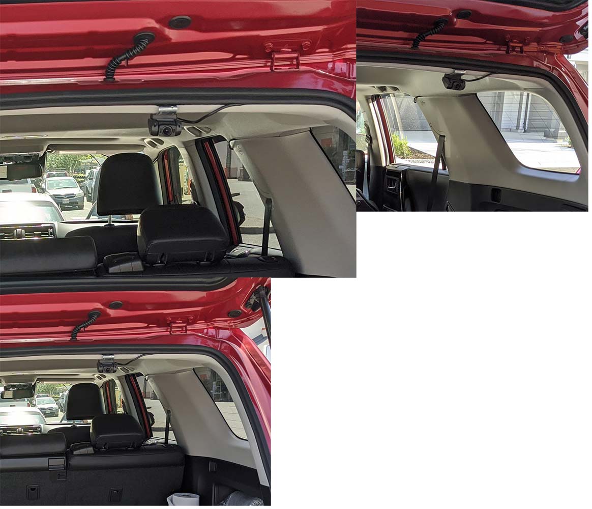

That's how mine is set up.
Imgur: The magic of the Internet
Obviously for the missing lines, both lines meet at the corner. Same concept as the front right corner except on the other side. A cheap money clip or a clasp-like with a silver plate and insert it in between the head liner and use 3M tape for the camera/clip. No drilling, no tearing needed.
Unless your rear camera is a brick - this should be the perfect solution for you.
Yeah yours is very similar to mine, but I guess yours is even more low profile. I also moved it "forward" a bit to be a bit closer to the window, but that also means it doesn't tuck into the roofline as well.

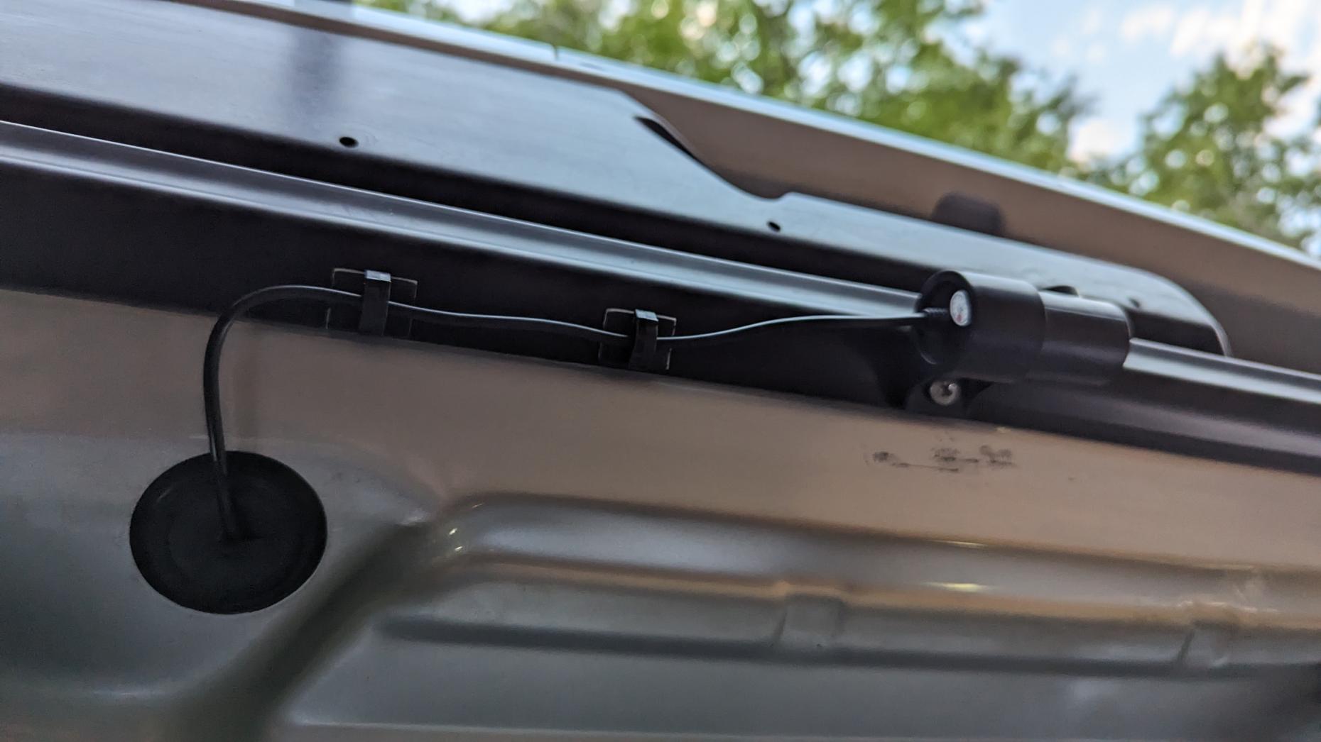

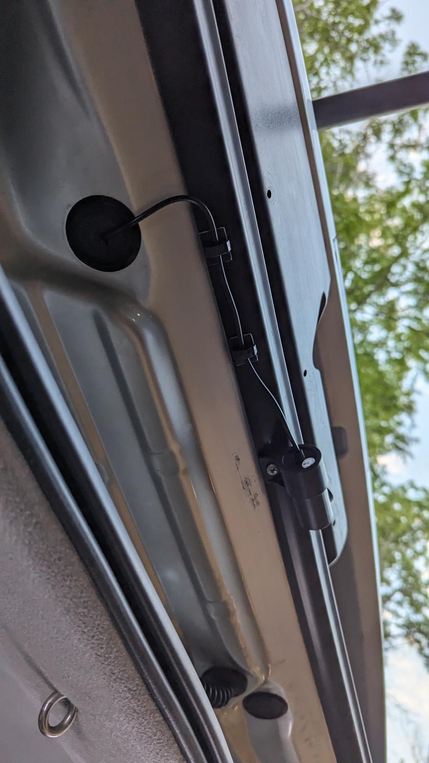

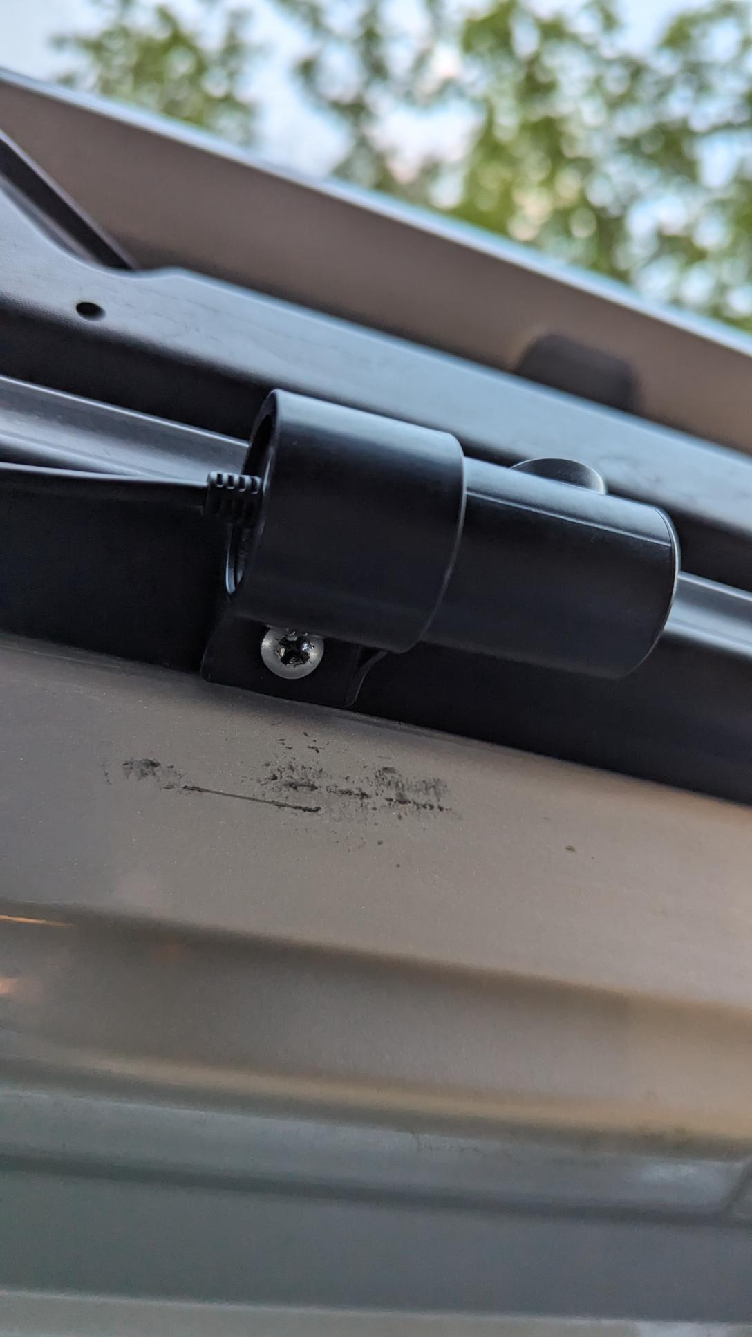

I ended up doing this. Drilled a small hole in the mount, cleaned the rubber at top of window very well, stuck it on then reinforced with a self tapper. Checked the window slot, and it didn't pop through to hit window. It's about as high as it can go!

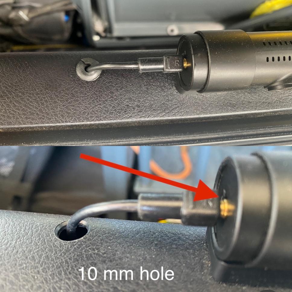

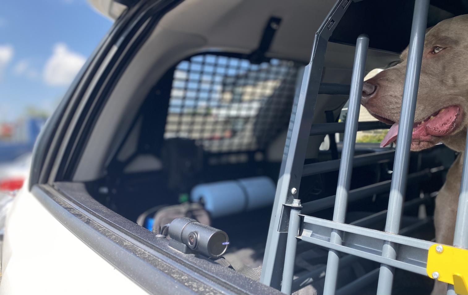

Mounted mine of the bottom of the window
Drilled a small hole to run the wires for the BlackVue and used 3M tape for the camera on the moulding. Threw a small grommet in the hole for the finishing touches and I have had this set up for a year at least and the rear window is down quite a bit for the dog. No issues with it moving around or the wind blowing it out the back.
Wow very clean, love this idea
Here is a better pic of the hole and grommet.
