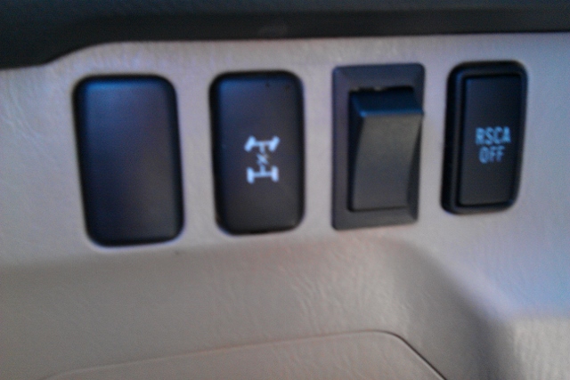

today i did the vsc/atrac/abs off mod. i did the method of damaging the factory wire.
i used this rocker switch in one of the blanks left side of steering wheel
Scion OEM Style Rocker Switch
i didnt get a pic, but as stated in other threads it took minimal shaving and fits great and looks great..
Using the switch, i liked it in sand or to have 2wheel fun as others have said, but i prefer just vsc off when doing steep hill climbs..

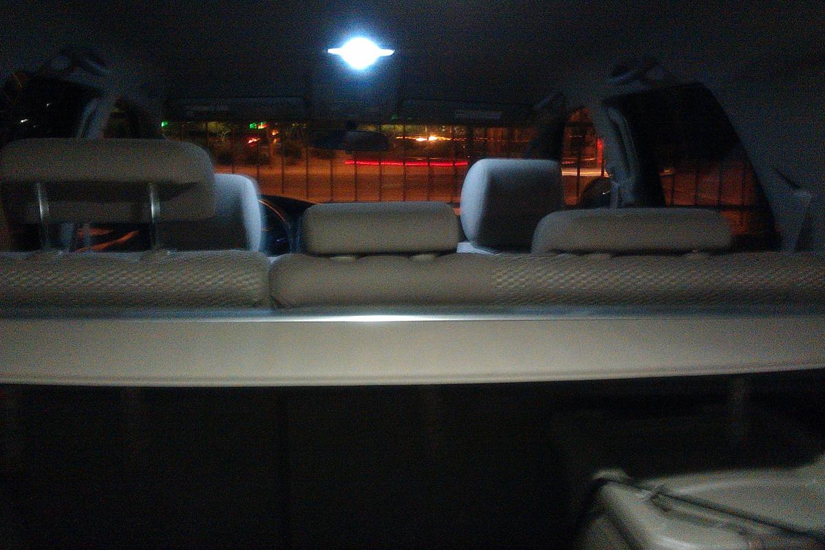

10 piece led interior lights from classy auto on amazon $26 shipped
no instructions, but install was pretty simple, took me about 30 minutes for all of them.

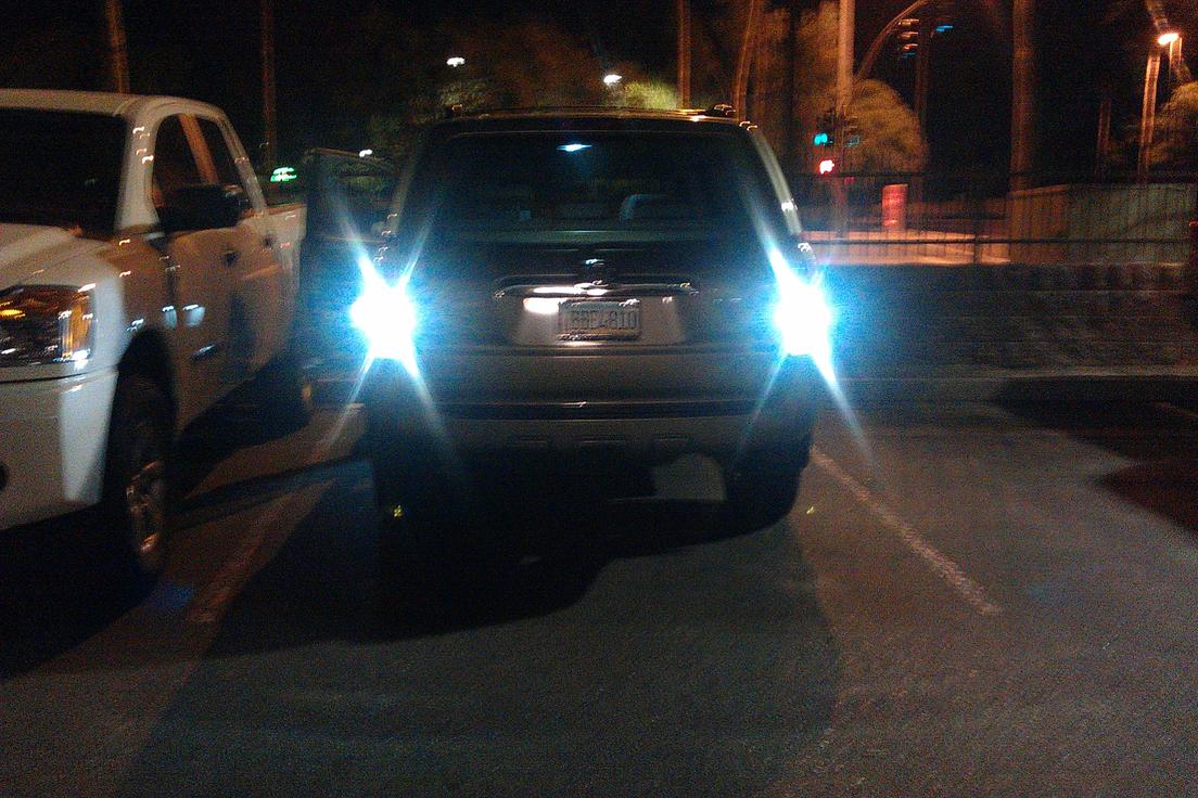

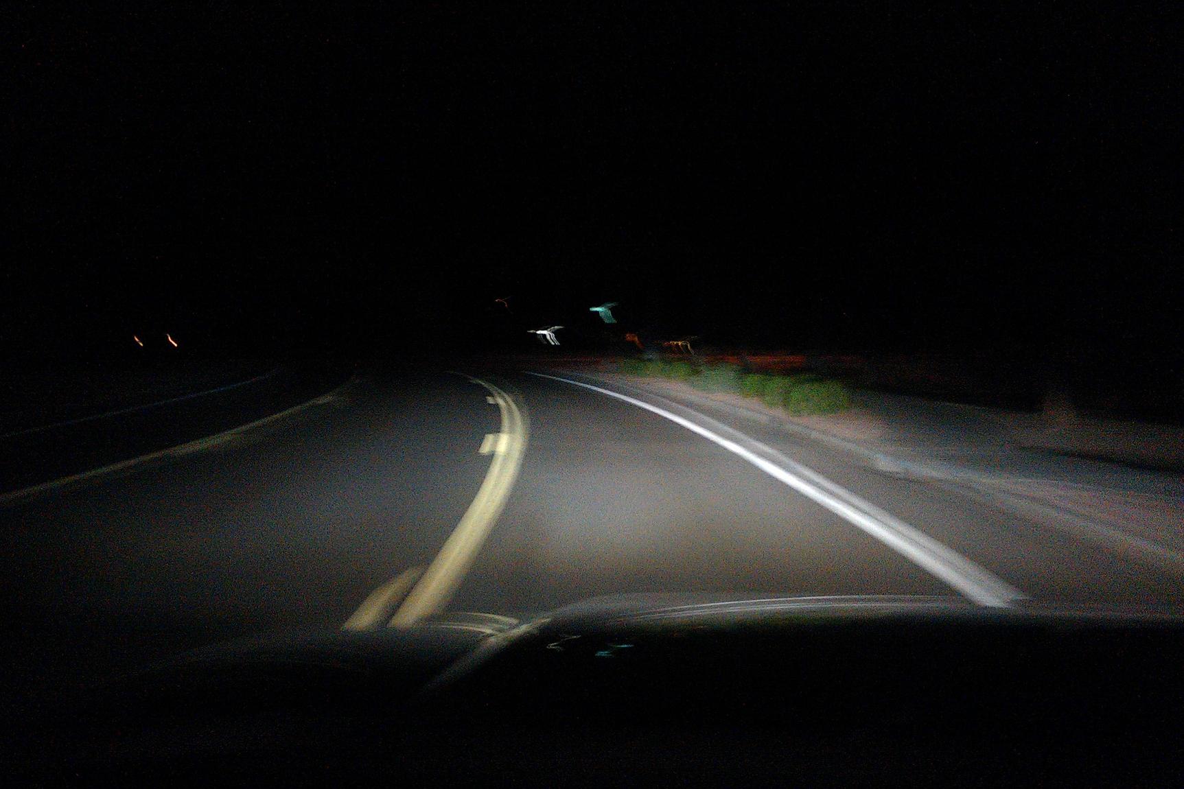

ddm hid headlights w 5000k bulbs $55 shipped
shipping was fairly quick considering they came from china. no install instructions, was a little confusing at first but got it installed pretty easy. used zip ties for mounting. work great and bid difference in light and visibility.

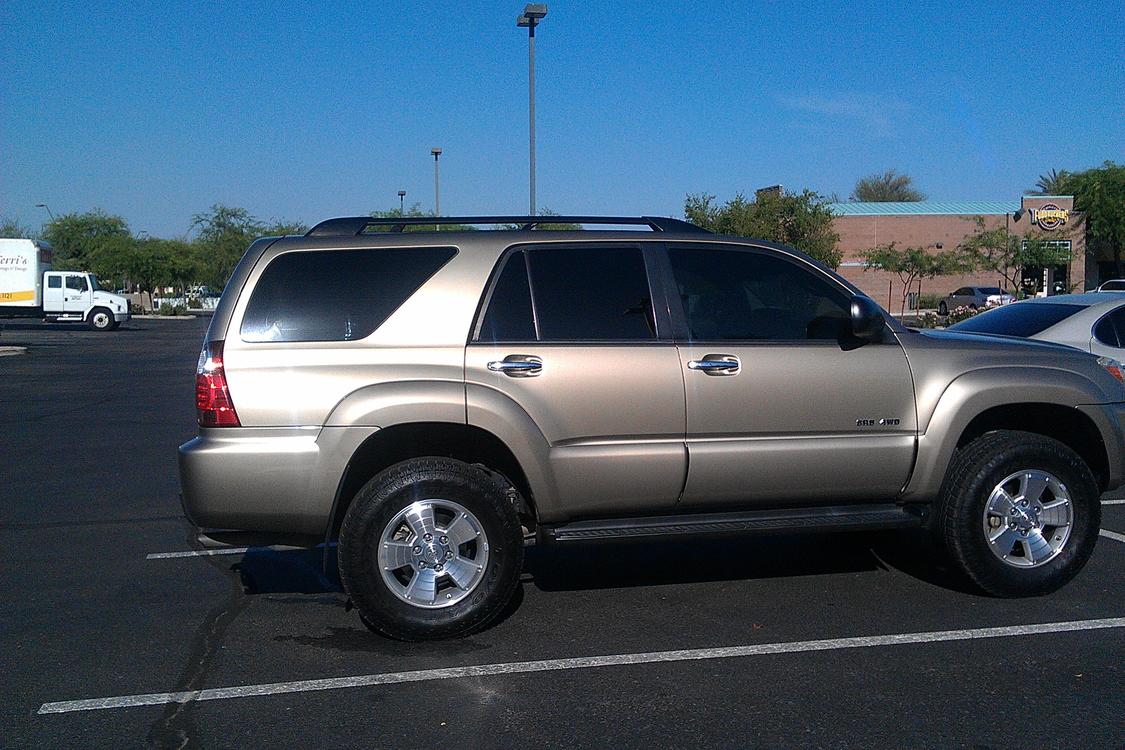

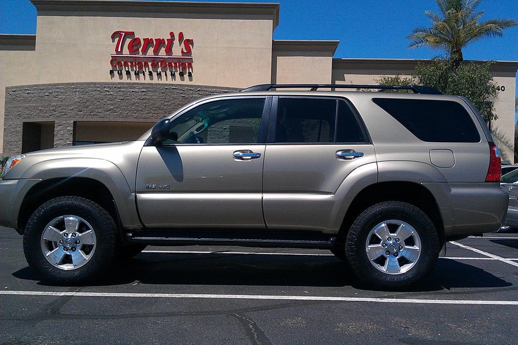

daystar 2.5/ 1.5 spacer lift kit $160 shipped from autoanything.com
only thing I don't like bout autoanything, is they wont stop sending me emails even after ive opted out and asked them to remove me from their list.
I used the install suggestions from this thread http://www.toyota-4runner.org/4th-gen-t4rs/68638-daystar-2-5-1-5-install.html
I was hoping for a 2 hour install, it took me 4 hours even with impact gun, shop hydraulic jack, air ratchet, ratchet wrench, and plenty other useful tools.i followed the given instructions except on drivers side I had to remove the shock to insert the top 3 bolts into upper perch because the angle wasn't allowing it to go in. I had a bit of trouble on both sides getting the bolts that hold the lower control arm to the bottom of the ball joint, took me about 20 - 30 min each side. otherwise the front went as planned. the rear wasn't as easy as mentioned by others, and I don't know how you did it with prying. I used a spring compressor. this was definitely a two man job, and I wouldn't advise trying to tackle it on your own. I didn't get measurements prior to lift, but will get some today post lift.

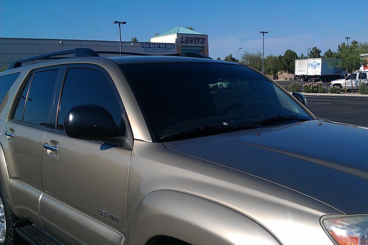

tinted my windows this weekend.
limo on all rear windows
30%(AZ legal) on front doors
limo windshield visor strip
