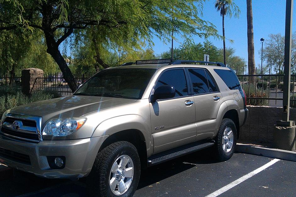

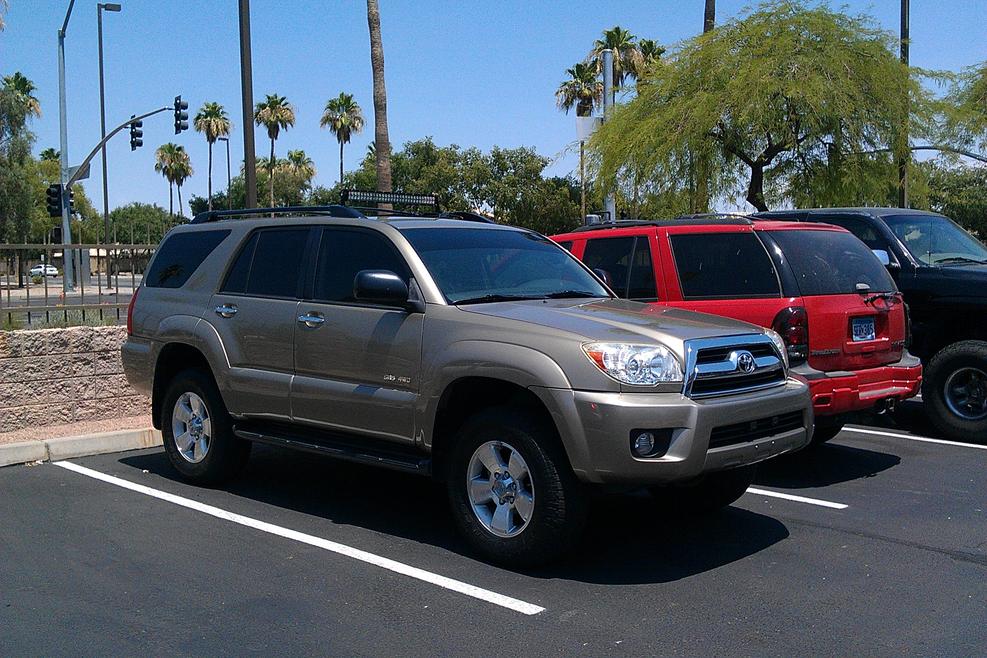

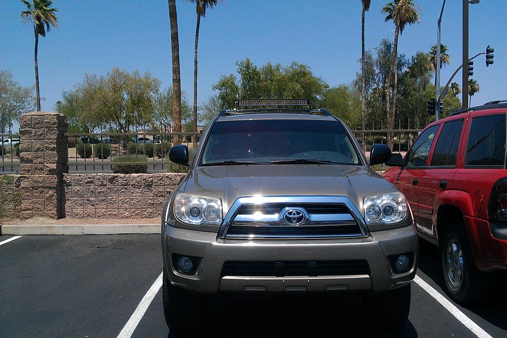

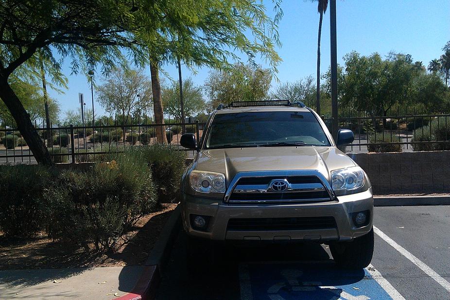

ok so im trying to figure out my options for mounting my 31" hanma lightbar.
I want to mount it to the stock roof rack. At first thought you may think it might not look right because its not a 40 inch, but with I test fitted the stealth install by bannerbuilt http://www.toyota-4runner.org/4th-gen-t4rs/139354-stealth-led-light-bar-install.html and theres only about 3" of space on each side and looked fine. but I kinda wanted a lil more aggressive look with it being a little higher off the roof. anyone have any other mounting options for this hanma lightbar to be mounted to the stock roof rack.
if anything I was thinking I can fab a bar across using the draw bolts idea to mount it to the roof rack.
temporarily mounted my lightbar to see if I like it before I do the wiring.
tell me what you think. I think I like the lower more stealth look.

Lower looks better. BUT, the front half of your car is going to severely cut the beam that would normally be directly in front of your truck. The fact that our OEM roof rails don't begin until almost a full 1/3 of the way back along the roof doesn't help either.
Take a side profile pic and use a ruler to draw a line from the middle of your light bar tangent to the point on your truck where a light beam would clear the body, then project it to the ground, and that's where your light pattern will begin.
If you want to mount your bar that close to the roof, you'll probably want auxiliary lights of some sort on your bumper to really light up the area directly in front of your truck.
yes, that's my other concern. I got the flood/spot combo. I would prefer it on the roof, but front of truck is also an option. I eventually want to install a winch so I don't really want to put it in the lower grill, and I don't want to mod the upper grill so behind there doesn't seem to be an option. Nor do I want to put holes in the bumper so on top the bumper isn't really an option. hmmm???
