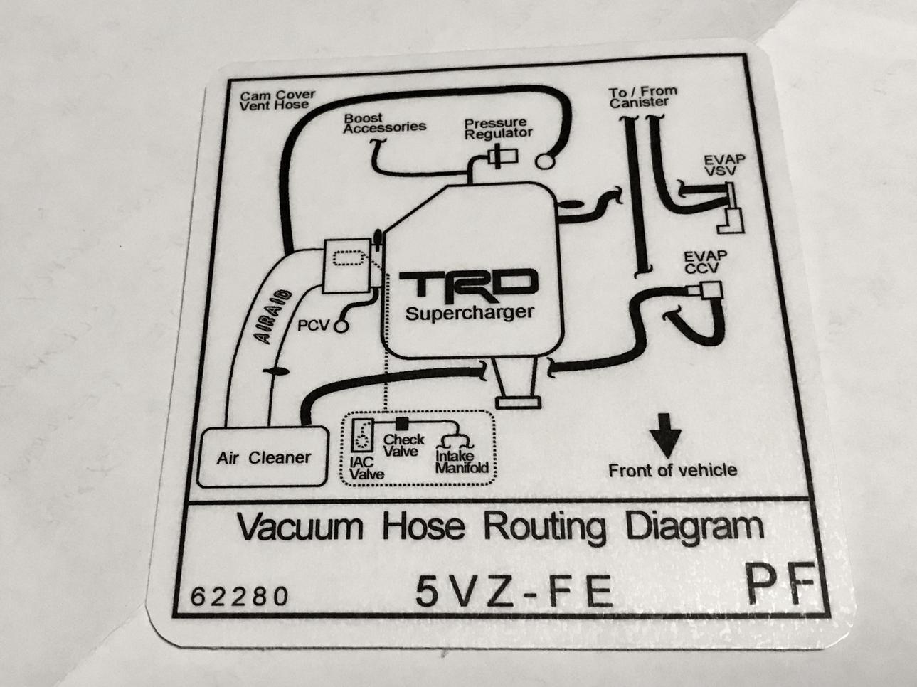

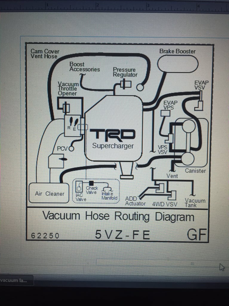

Let's not forget to update your underhood vacuum diagram to match all those newly routed hoses
Example of another member's updated version I created (yours would be a little different)
I can happily add an "air raid" style intake as well... Look like its factory

I like the diagram. Thanks for sharing this.

These stickers you make are fricken' rad dude. I would be honored to slap one of these custom made ones under my hood if you're offering?

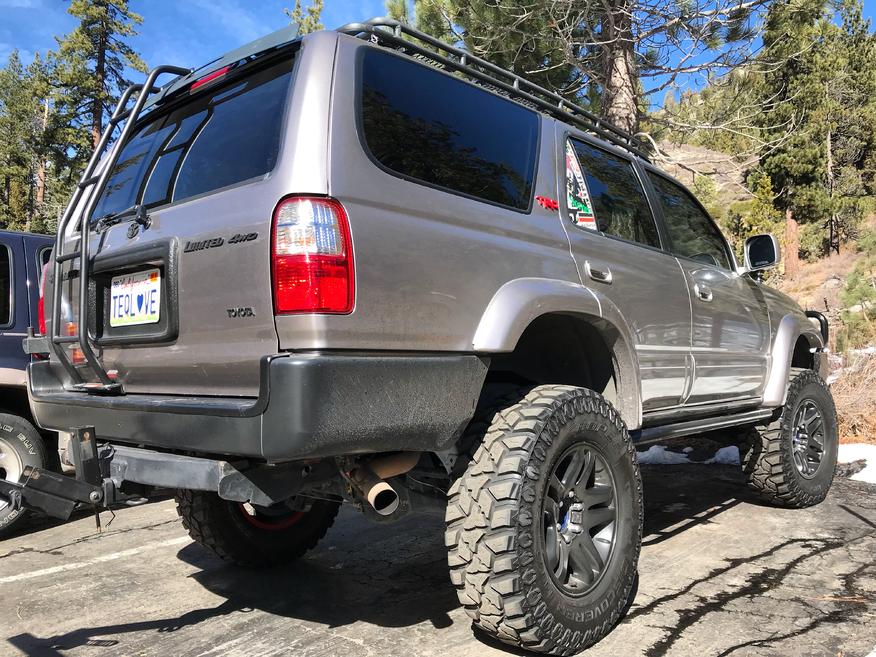

Lake Tahoe Trip 2018
Took the bae to Tahoe for the week for her birthday to snowboard & relax.

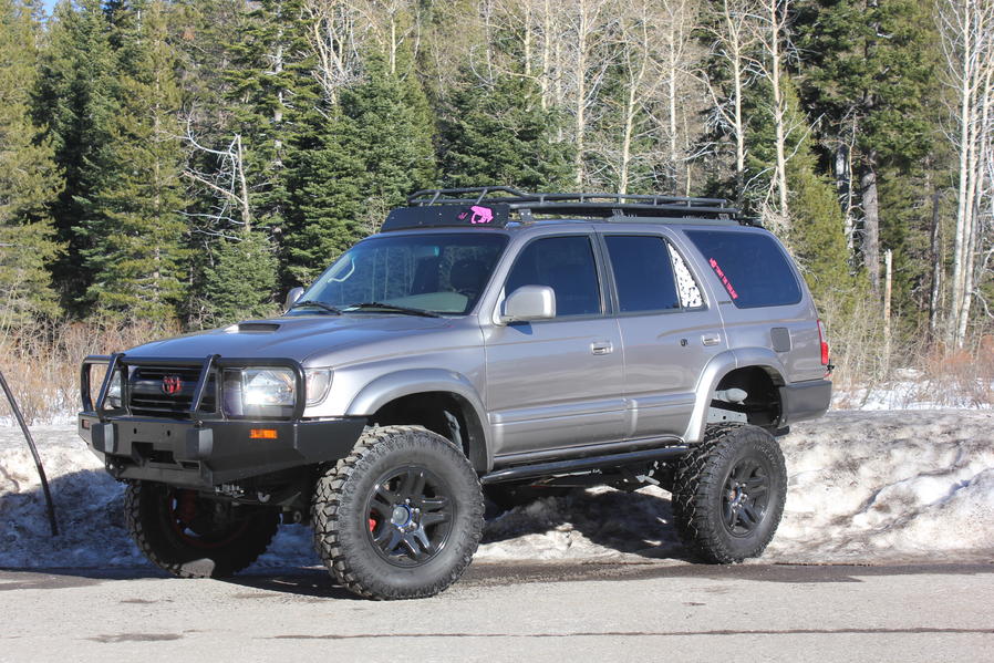

First impressions of the TRD Supercharger is pure stoked-awesome-sauce.
This thing really helps with getting up hills no doubt.
So far it has been running great, no issues I can detect & the truck seems to be happy even at these higher altitudes.

A little progress report since I was in Tahoe is that so far I noticed my gas mileage on long trips hasn't really been affected...
I got almost 260 miles per tank on the way back from Tahoe & on the way up the hills & driving around town I was right around 220 miles per tank like I usually was before the supercharger. going up the hills in Tahoe I left the OD on & saw my transmission temps reach temperatures of almost 220 degrees & as soon as I turned off OD I dropped to 141 degrees. thats a pretty significant difference in trans temps so for those of you who don't play with the OD button on the shifter you should really start. Since I have replaced my transmission approximately 1 year ago now I have had 0 issues so I'm very happen with the remanufactured transmission from Toyota. it pulls strong & I drive pretty aggressively... sometimes. The 4runner doesn't care about hills like it use to... I just keep my foot on the gas & it just climbs nicely. pretty rad to feel the difference. you kind of have to drive your own 4runner before & after to really appreciate the difference in power, performance & ease of driving.

[MENTION=127339]4Reak Show[/MENTION] makes some frickin' legit hood stickers for the vacuum line routing.
DUDE!!! These are awesome! thanks again & the custom AIRRAID airtime brings it all together. seriously fricken rad man. This is something everyone needs that has any kind of custom items under the hood.
He even added the AIC check valve on this sticker! stoked!
Glad you're satisfied. I think they're a nice little detail that is overlooked and actually pretty important for some people.
Plus I think it could throw the smog techs for a loop as well.
And again, you're sticker actually helped me to acquire the later model 3rd gens design, so it was a win-win

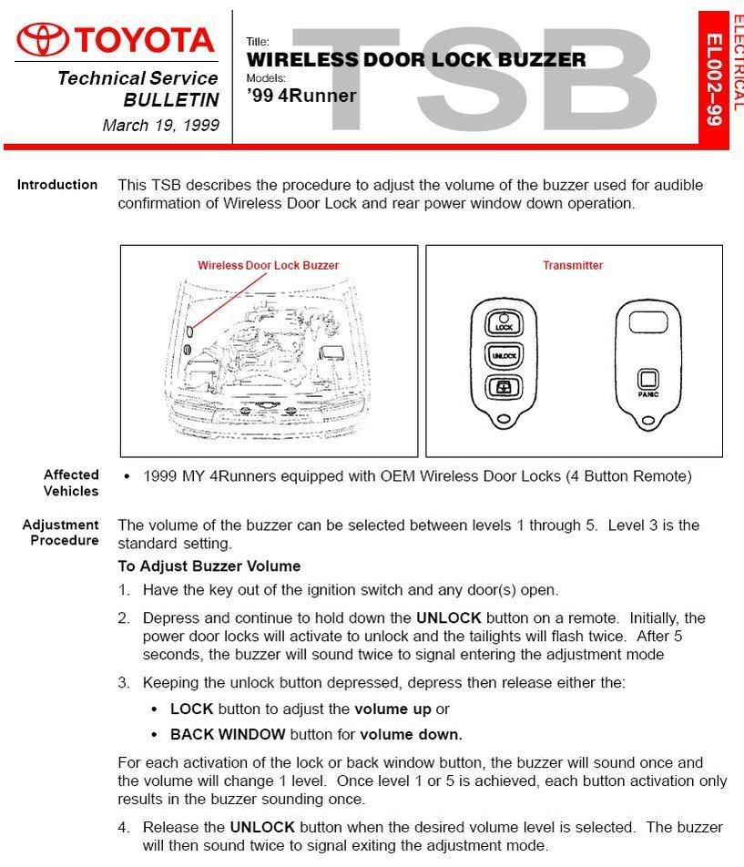

I tried this out yesterday.. it works but volume level 4 & 5 just kind of sounds weird. Not like noticeable increase in loudness, I noticed more a tonal difference. I guess it might depend on where you stand in relationship to the speaker module that makes the locking tone but it’s good to know you can adjust the volume using this TSB.
I’m going to try this riiiight meow.
Never knew you could adjust volume, mine is pretty quiet.

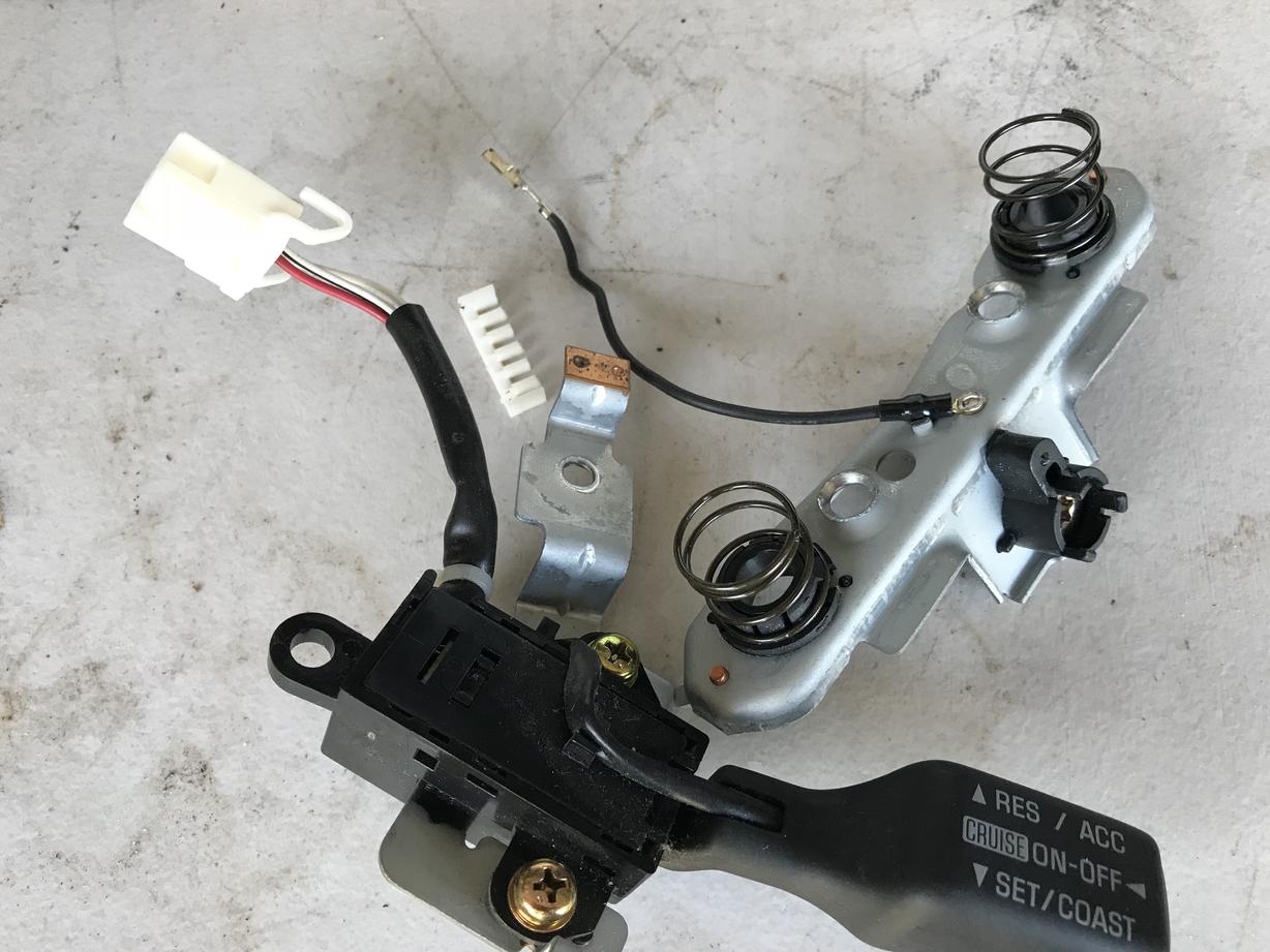

Finally fixed my cruise control to operate correctly... if I knew what wires did what I probably could have swapped some pins but because I didn’t I swapped over the cruise control lever from my old wheel. Because the ground cable was affixed to a metal plate, I de-pinned the ground & swapped it over. It’s pretty straight forward to Swap this component from another 4runner wheel but my Lexus wheel was slightly different otherwise no ground swapping would have been necessary.
