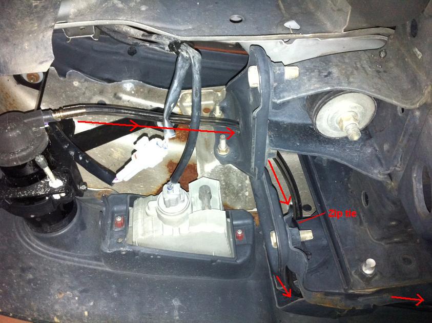

Nashvegas what type of barb did u use? Do u have a pic? I saw the one SKIDMRK did but wasnt to clear one how it worked.
See below. Basically I just routed the tubing through some holes in the bumper supports, taking it to about the middle of the bottom lip of the bumper. I zip-tied it in a couple of places to keep it secure. Really anywhere away from right in front of the tire would work.

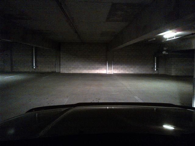

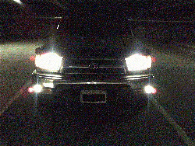

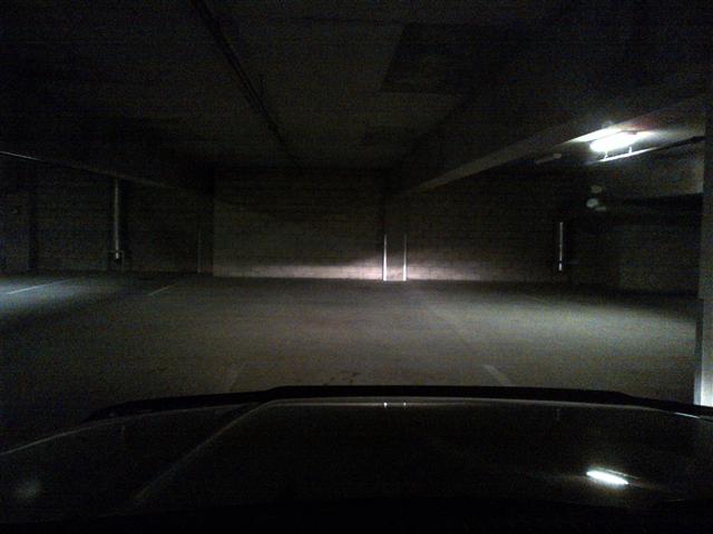

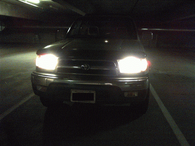

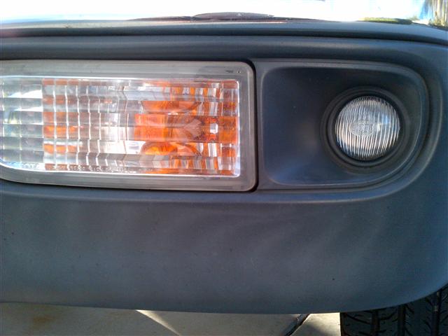

Some pics show before and after my fog light installation. Hope it helps.

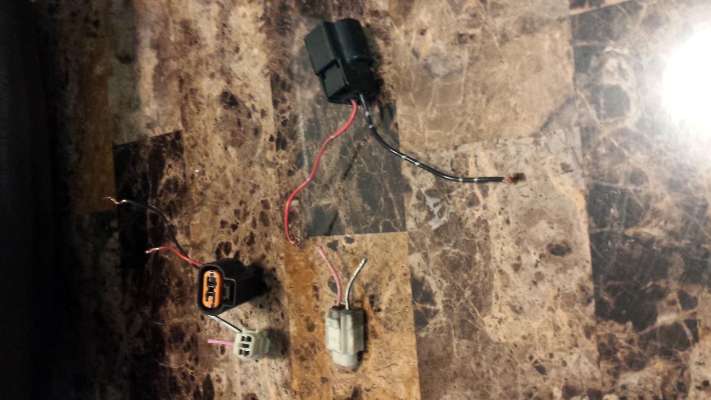

Does anyone know what style of the plug comes with the harness. I want to install HID's but dont want to cut the harness from this kit, I would rather buy an extra harness and solder that to the HID's
