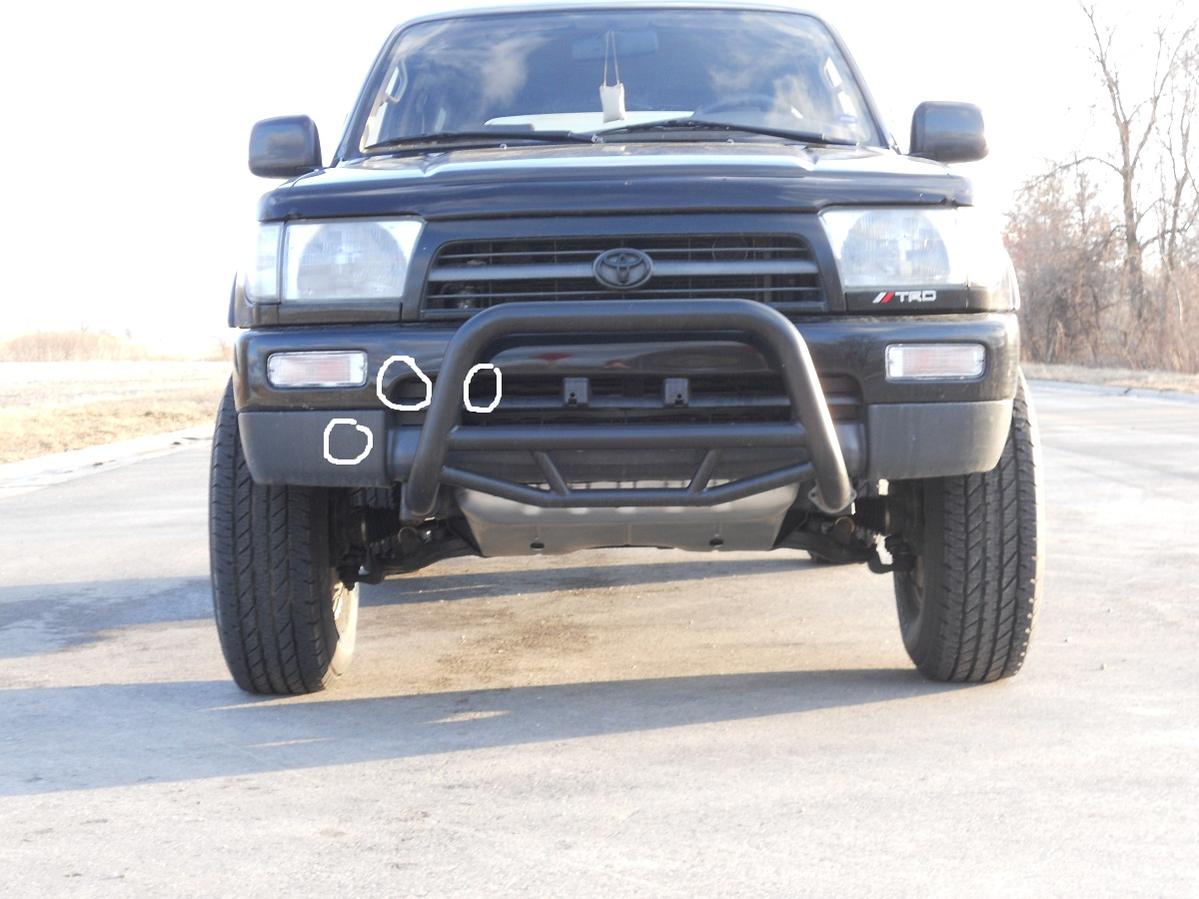

That makes sense if Hella discontinued the kit. But its really not that big a deal anyway. I can get hardware. I knew exacty what I was getting and planned from the beggining to custom fit these to my truck. I could have just gotten a set of PIAAs or KCs and bolted them right onto my bull bar (this was my original plan). But these little lights get really good reviews, and I actually like the fact that I can retrofit them to my truck to where you wont really notice them until theyre turned on. Im going to mount them to one of three spots below. On both sides of course.
Cutting a hole and putting them into the valance like blcktpgsr did would be awesome, but I dont really want to cut a hole in my valance. And I dont want to carbon copy what he did. I could put them in one of the other two circled spots without any nobicable modification in the valance. And it would probably be easier.

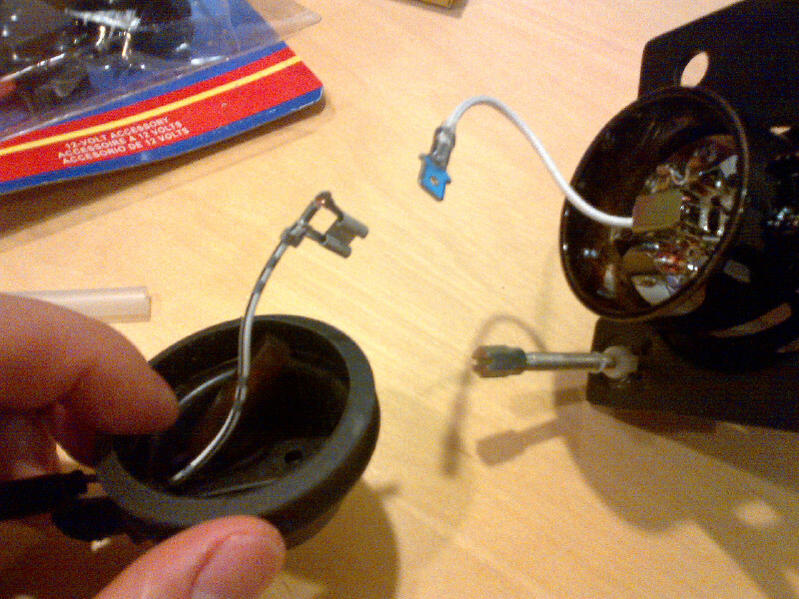

Can someone tell me which wire on the left is supposed to connect to ground of the light bulb? In other words, should I connected long wire to long wire or long wire to short wire?
It works either way. I tried it both ways since I wasn't sure either and the instructions didn't specify. I ended up putting the black-and-white wire onto the ground terminal of the lamp, and the purple wire onto the white wire of the lamp. It just seemed to fit better that way when I put the boot on. When I did it the other way, the plastic sheath on the purple wire made it almost impossible to put the boot on because it stuck straight up off the ground terminal.
