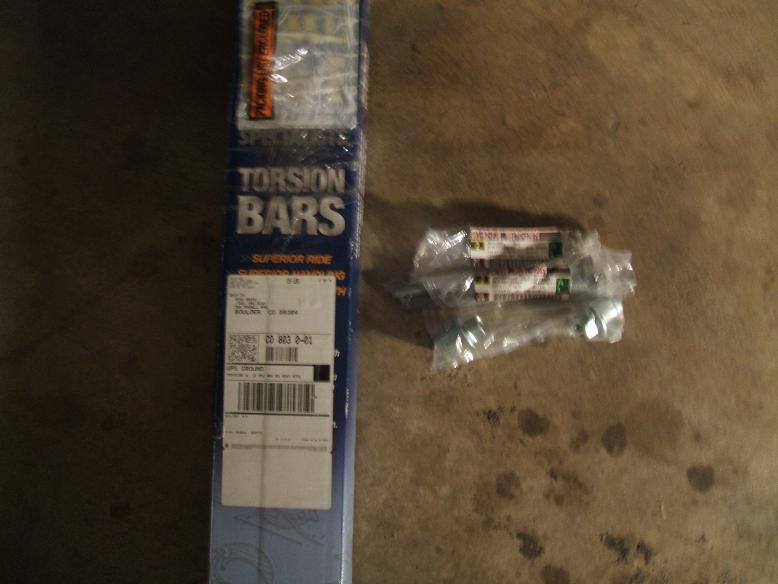

torsion bars came in this afternoon around 530, and the adjusting hardware cost me $80 from daytona toyota. I ahve part numbers for whoever needs em....
One question, what are the tq. specs on ome stuff?
**EDIT** I think I bought all the wrong hardware >:(

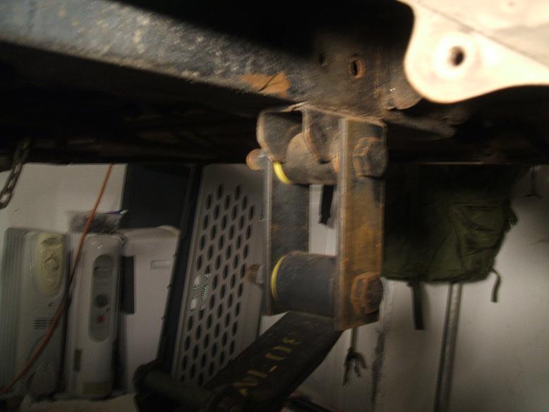

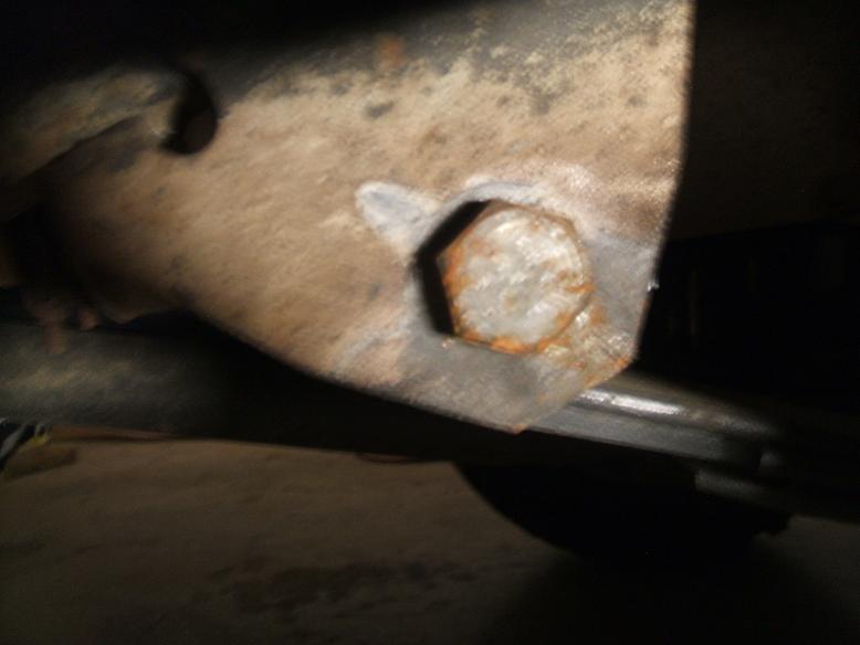

Here you go dude. I opted for home-made shackles I cut from stock I had. I used 5/16x2x6 with 7/8 holes spaced at 4".....1/2" over stock. 3/4"x4-1/2" (As measured from the inside of the bolt head to the end of the thread) Grade 8 all the way around.......including the spring-eyes. The 3/4 bolts fit perfectly in the OME bushings without the need for the spacer. I greased everything during assembly and haven't heard any squeaks yet. The torsion bar adjustment bolt and nut are the crap you need for the front....See the attached picture. I am not totally sure you will have the same set-up though....Toyota used a 2-nut set-up for the '86-'87. It had an adjusting nut and a jamb nut.....Check around the site or call the guy at Toyota and ask him what the deal is. My hardware was only $21 from Toyota. What the heck did they sell you that cost $90?
Check out the pics and let me know if this helps....Disregard the rust on the hardware, I haven't sprayed yet......And sorry for the suck-%$# pictures!!

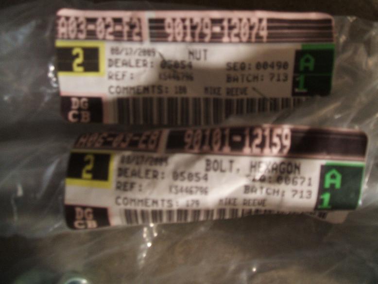

Part numbers
The manual I have said that the locknuts were no longer used around the 88 models. I have double checked anyway and there is only the Bolt (P/N 90101-12159) and the nut (P/N 90179-12074).
For those that might need to replace their adjustment bolts here are the P/N's
-------------Bolt-------------Nut---------Lock-Nut
86-88 90101-12104 90170-12025 90170-12004
88-95 90101-12159 90179-12074

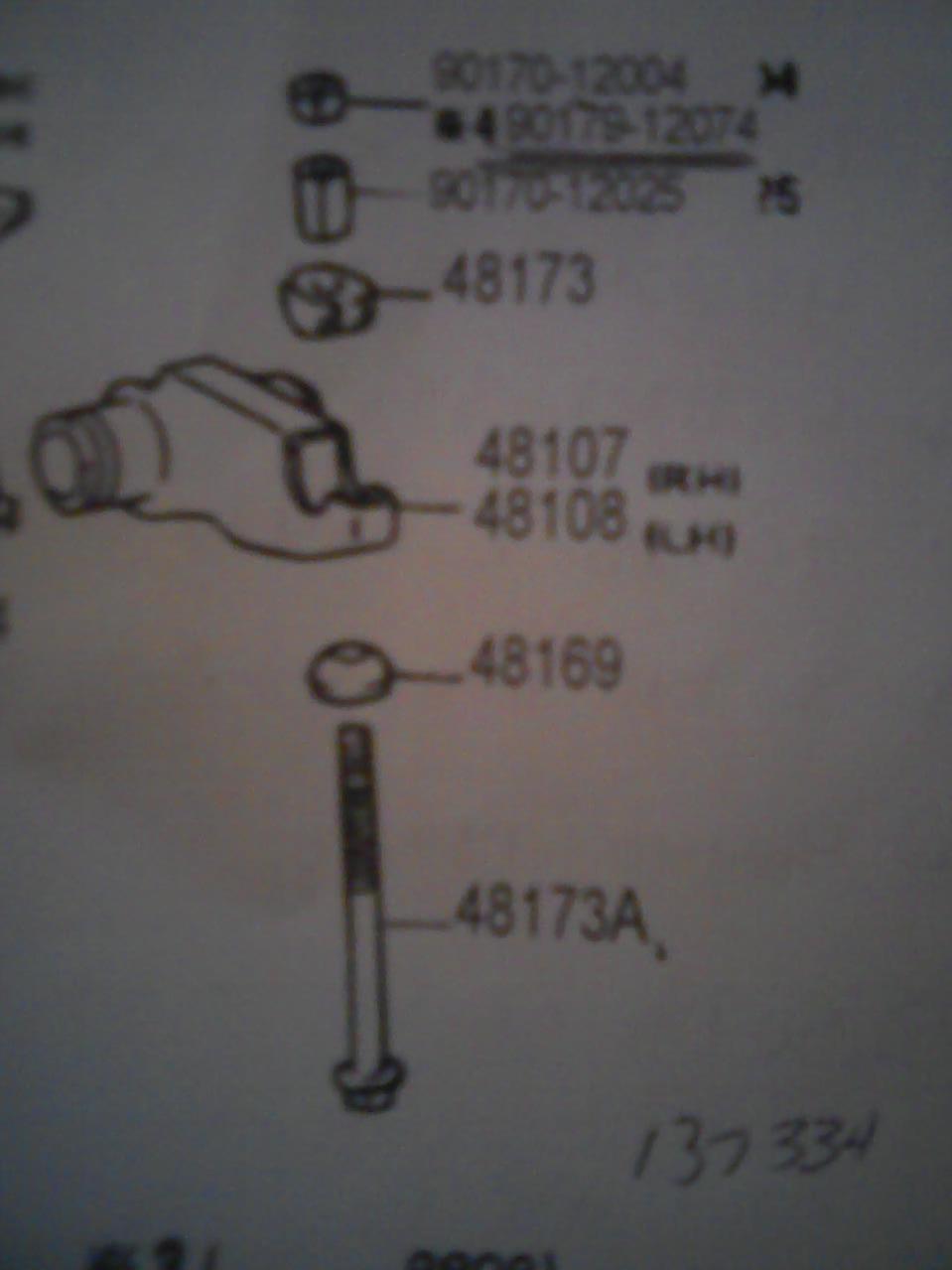

the diagram im looking at has all the parts you listed and them some others:
i have an 87
from top to bottom:
90170-12004 (lock nut, i think)
90170-12025
48173
48169
48173A (the bolt)
$76, got 4 back :). Need to soak me bolts n nuts in wd40 or pb blackster
