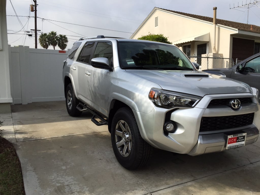

Only one bolt for the front, two for the middle and end. Curved end goes to the front. Instructions may show it wrong for our 4Runners.
Prop them up in the middle with a box, small trash can etc.

Are the nfab wheel to wheel nerf bars able to mount up without a spacer kit now? Last I heard they only fit the trail editions. We're you able to bolt directly up without mod?
They will fit the trail edition, and the 2014-2015 sr5 without spacers. I believe the limiteds still need spacers though.
No spacers
10 - 15 trail
14 - 15 SR5, PRO
Spacers or rocker trim
10 - 13 SR5
10 - 15 Limited
