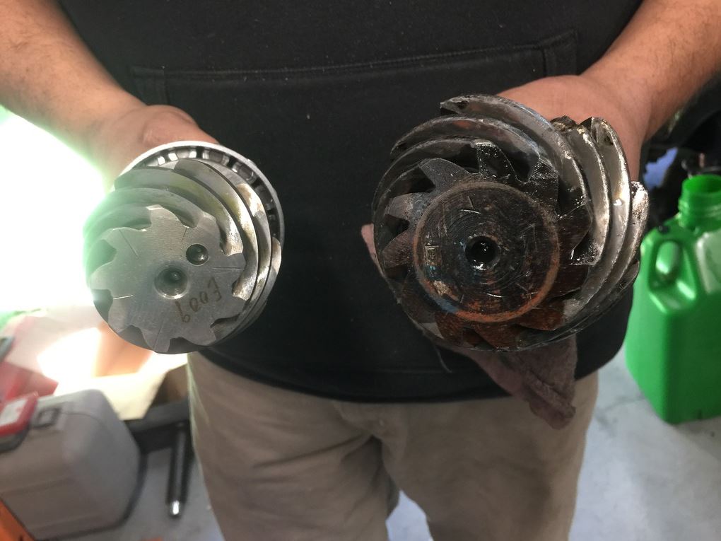

Yes, my rear diff decided to give out while attempting to climb those difficult ledges. Yes I did bounce the rear axle a couple times during my attempts. In my defense, worn out 33's are a far cry from my new grippy 35's. My brother told me it was 'driver error' but I doubt any driver would have made it up without busted gears unless they opted for a winch right off the bat. I tried 2 different lines and when each one resulted in wheel hop I slammed on the brakes. Not much more I could have done. The FJ before me hopped their rear axle when clambering up, the one after me did, the only reason why my brother's didn't was that he had rocks stacked for him when driving around my broken AF truck. But don't tell him that. And nobody seemed to remember he broke his before me.

One last surprise during the 3rd member install. Broken rear sway bar. Thanks again, Moab:
Yup. Busted:
Rounded pinion teeth:
New 3rd. I stupidly ordered one with the fat harmonic flange which apparently is for 2wd 4Runners. It's the same overall length so it should work? I will email ECGS.

The higher gear ratios actually have smaller gears, at least the pinion is. Maybe the aftermarket gears are more durable with a better heat treating process but I have no idea on that part.
Welding some armor and gussets to your housing can't hurt anything, and any kind of flex you can eliminate will make it more bulletproof, though I don't know how much of a difference it would make unless you're a high-speed desert guy that jumps and has the potential to bend a housing. Most guys, I would say, just upgrades from the V6 8" Toyota rear end to a Currie or Diamond axle with a larger Land Cruiser gearset.
It's not even that difficult or expensive to replace the rear end, it's just the fact that in most cases it gives out without any warning leaving you stranded.
