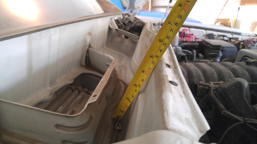

This weekend I measured and did some research on CAI and cowl intake design. Also researched the differences between aftermarket air filters and OEM paper filters. Knowing what I know now, it would make me cringe to see K&N style filters being ran in dusty offroad conditions. In one of these test, the K&N passed 18x more dirt than a stock paper filter. For a race car with a specific tune and engine rebuilds I could understand the benefits using a high flow/ lower filtering media but I just don't think its a good idea for our trucks where we want the engine to last as long as possible and a lot of us drive in dusty conditions on a trail for example.
I don't want to throw on a snorkel and use the stock airbox because of the snorkel look, so I'm thinking a cowl intake might be the next best thing and maybe better in some regards.

I'm really leaning towards using the Volant/Donaldson Powercore G2 filters for my cowl intake, seems to be the most offroad-proof filter and Donaldson makes a ton of air filters for industrial equipment so I'm betting they know what they are doing. With a cowl intake setup, I'll need to make my own enclosed/waterproof aluminum filter box next to the firewall. Buy some aluminum tubing and install the MAF sensor and vacuum lines. The cowl intake will be more protected from water than the factory intake in the wheel well where it is more exposed now that I've trimmed the plastic around it. Also, moving the intake backward in the engine bay means it will tip less into the water during a deeper crossing when the front tires initially dip down and your truck is sitting at a forward angle. The cowl has a drain for water and the intake tube will sit up off the base of the cowl an inch or two basically right beside where the cabin air filter draws air from. The only thing is the cowl vents are still located under the hood when you close it so I might need to add additional vents on the outside of the cowl under the windshield for fresh air.
The new air box will basically be right here, I could almost make the factory one work if I was okay with using a filter that fits the factory box:
