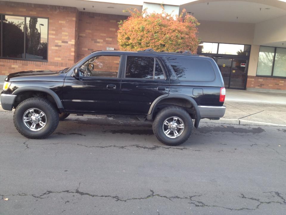

This is what I run it is a 17 and not a 16 but it is 4” back spacing. I do have the LR upper control arms so I dough 4” BS will clear the stock arm with a 285. It is extremely hard to find a 4” BS aftermarket wheel that is reasonably priced. Most are custom BS and are expensive.
http://www.tirerack.com/wheels/Whee...lse&filterNew=All&filterWeight=All&sort=Brand
Not a big picture taker so this is the only photo that show how the wheels sit on the truck
DSC_0358_zps1e2f29df.jpg~original

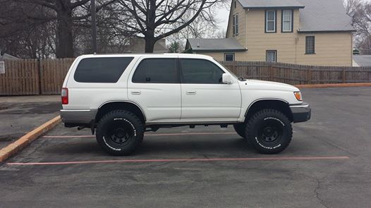

They Fit perfectly with 285/75/r16's BFG KM2's, I was afraid they were going to stick out super far out of the wells, but it sits oh so nice!
Thank's again to everyone!!! Now I just need my front and rear bumpers to arrive...
