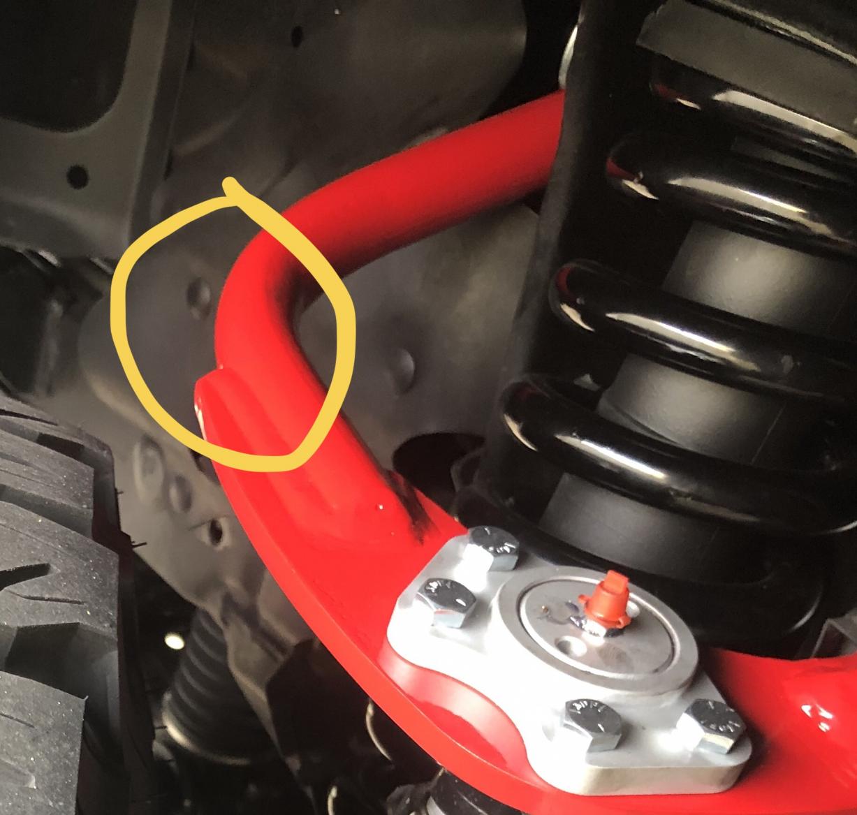

JBAs, SCS Ray 10s, Falken Wildpeak 285/70/17 with 5100/Wheelers front back, no rub and still have a couple finger width of clearance. Had to bmc though, as I was rubbing pretty bad. Below is a pic with 275 KO2s, circled is the edge where you will see the potential for rubbing.

full lock, it was rubbing the steel plate that extends off the tube of the UCA
