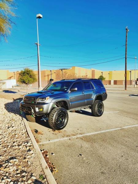

JBA installed:
Patagonia MT 35x12.5x18
Monster Edition Eb9 wheels 0 offset
Spyder trax Spacers
