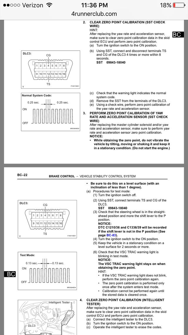

Handling waaaaayyyyy better now, however, before I could get out of the dealership parking lot my VSC and Traction control lights came in. Took it back to them..codes were read C0200 C1223 C1290
I drove the truck Saturday Sunday and Monday morning after the lift with no lights in...then after alignment lights. I guess I'll try zero point calibration when I get some free time fml

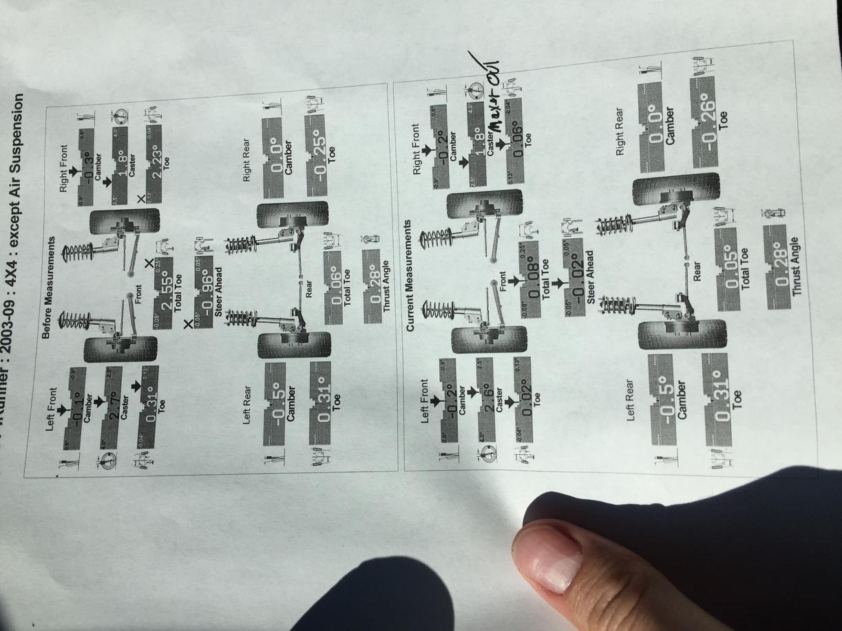

Everything fit very well. I believe these UCAs will only help with castor. Toe and camber adjustments are done else where..like camber bolts..tie rods. The reason my initial alignment numbers were so bad was because I changed the camber bolts and did not but them back to their original setting. I don't know much about alignment stuff though..I just understand the general concepts.
Performed zero point calibration and lights have cleared..fingers crossed.

Looks like the tech burned you with a toe&go. Got any pictures of where the alignment cams are at now? Both caster and camber are adjusted with the two cams on each lower arm.
It's dark out now..ill take some in the morning. The guy who aligned it was a douche. I told him my steering wheel was a little crooked and he rode with me and pretty much refused to fix it. I had to do the zero point calibration myself. Not going back to Charles Barker Toyota in VB.
Don't feel bad, I've had this alignment experience before too. Gotten into it with a few guys on here who were saying I was being too picky for my own good but come on now, if I paid for it I better get it...
