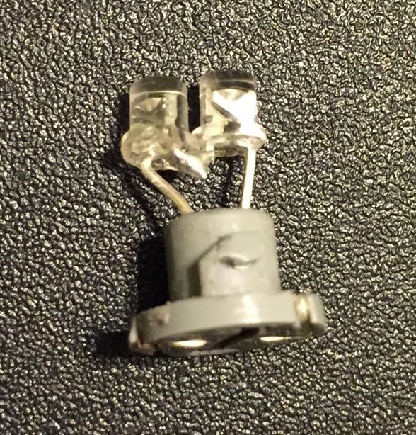

I soldered all of the various button leds and HVAC leds with resistors...I didn't use plug and play leds.

----------I used:
----PLCC-2 (for cluster and steering wheel controls): https://www.oznium.com/plcc-2
----3mm flat top (for HVAC, HVAC display, DAC button, side curtain airbag button, center diff lock button, 4wd switch, rear window switch, driver window button, air bag on&off) : 100x White 3mm Flat Top LEDs Wide Angle Light Lamp LED USA | eBay
(if you're replacing a filament light bulb then you need to add a resistor, if you are replacing an LED then you don't)(HVAC display{2 bulbs} run off of ~7volts...so you need a resistor)
----560 ohm resistors: https://www.amazon.com/gp/product/B00CHTOB02/ref=oh_aui_detailpage_o03_s00?ie=UTF8&psc=1
----#74 LED (for glovebox, console gear selector, cup holder): https://www.superbrightleds.com/mor...b-3-smd-led-miniature-wedge-retrofit-car/228/
EDIT: SOLDERING TWO BULBS TOGETHER LIKE BELOW DIDN'T LAST. SWITCHED TO ONE BULB AND A RESISTOR, THIS SETUP HAS BEEN RUNNING STRONG FOR 6+ MONTHS.
