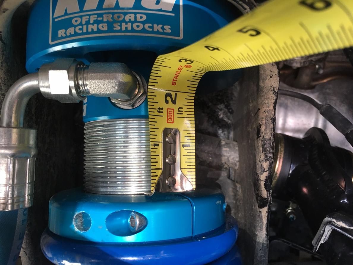

Can you post more photos of your kings with the KDSS bracket they provide?
also can you post more photos or DM me photos of your tires? specifically the tread. I'm considering that size for my next tire. thanks!
[MENTION=139709]Quebec[/MENTION]
Like this, or something more specific with measurements?
Toyo Open Country A/T II
LT285/75R17 OP CTRY A/T II BLK E XT
Item Number: 352790
That's perfect [MENTION=139709]Quebec[/MENTION] Thanks man

No spacers at all, and no rubbing for now....however my lift is way too high (+4.2" & +4.75") and my CV boots look crumple-ey to say for sure. Let me fix that and then I'll snap some more pics to show clearance.

Yes, when initially installed - against my direct instructions of 7-10 threads exposed - the mechanic had 17 threads and it rode like shit.
I have 2" rear coils as well, You should have 7 threads exposed on both sides. I'm pleased with the ride now.

I appreciate the feedback on height adjustment and KDSS bracket pictures Quebec. Very helpful to a prospective buyer.
Sorry just seeing this now.
ETA: Just skimming through your thread, wow, it looks like you and I are/were experiencing the same issue on opposite coasts.
I am at about 14-15 threads showing right now. With the 2" rear spring and only 7 threads showing up front, are you "stink-bugged" like crazy? I really like the ride height, but the quality is poop. Although it has gotten better over time. last thing i want to be is all stink bugged but i want these Kings to ride like KINGS!
