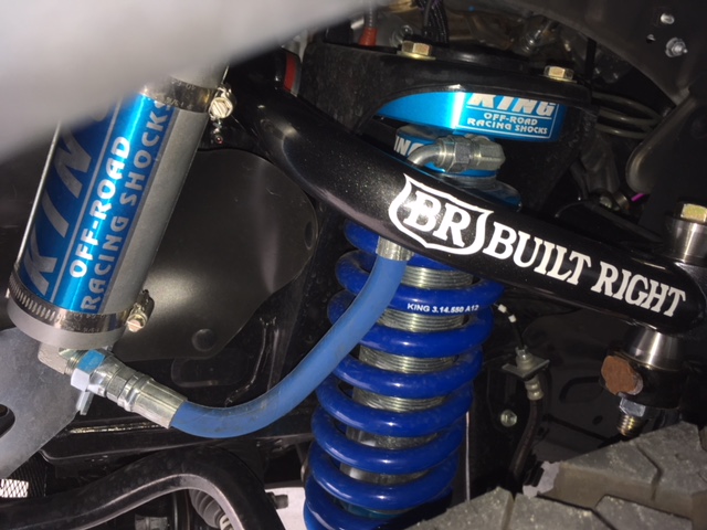

The redesigned vertical reservoir, applicable to the 4th gen?
Just opened mine to install, and it has this. Part number on the box is right. But instructions state 2010+.
You mean rears?
Piggyback?
No, Front coilovers.
For the 4th gen, all the pictures and how-to's, show the resevoir horizontal behind the wheel. But I opened mine and it's vertical in front of the wheel, like these for the 5th gen, and instructions say for 2010+. But the box label, and the tags on the coilovers say 4th gen/FJ.
Can you let me know how the reservoir fits for your 4th gen. Im thinking about going kings as well but wanted to see if the mounting would be an issue.
